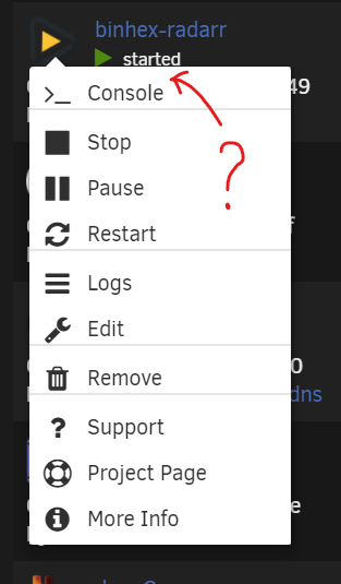

Is there any way to get the WebUI button back on containers routed through binhex-delugevpn? I've followed the instructions and can access by putting the containers IP and port directly into the browser, but I was wondering if there was any way to get back the WebUI button in the container menu when clicking on the logo in unRAID docker tab.
Not currently.
