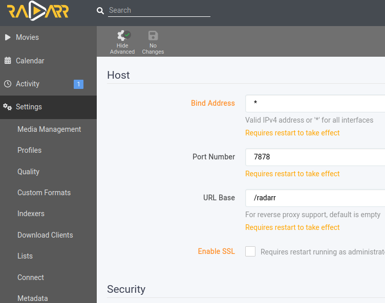

A bit of a general question here: I've currently got a setup with this container where I've routed other binhex containers through it as specified by Q24-27 of the VPN FAQ. One issue I've run into this setup is that if I have multiple instances of a container I want routed through it (ie. radarr), I can't because I can't use alternate port mappings. I've also started looking at the new Wireguard tunnels available directly in unraid and routing dockers through it.
How do these two methods compare to each other? Option 2 seems simpler and more flexible in being able to support multiple container instances. But is there something that I'd be loosing by going with it?
Since the app controls the listening IP, you should simply change the IP in radarr itself.
Thanks. Definitely something I should have thought of on my own, so a good reminder that I could do that. Unfortunately I've also got other containers where I don't have that control, or that it doesn't work (ie. binhex-sabnzbd)
