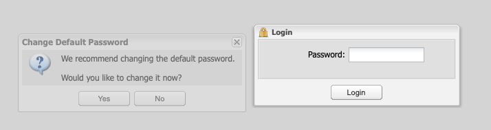

On 8/18/2022 at 6:48 AM, Cotanaj said:
Version 2.1.1
Default password no longer functional.
Behavior
  • Upon clicking the login button with default password "deluge", entered credentials are removed and login pop-in window is reset asking for a password. No login failure notice.
  • If I try anything else other than "deluge", I get the proper login failed message "You entered an incorrect password"
  • Integration with Sonarr & Radarr still functional.
Testing so far
  • I have uninstalled the app
  • -rm the app data
  • Reinstalled
  • No change in behavior.
  • Tried authentication in multiple browsers and machines.
Any suggestions?

I logged in on the server GUI and was able to launch and login to deluge with no issue with the default password. I was hoping that changing the password there would clear something up on the WebUI and it did not. WebUI behavior regardless of password. I also removed it all (including app data) and installed deluge from the linuxserver's repo and the behavior was the same. I did notice since it was the first time logging it did ask to change the default password (see attached photo) but it was de-emphasized and therefore not accessible.
Being able to login from the server got me functional so thank you. I am however looking forward to a fix.
Additional note: that "stroke" is unfortunately sounding familiar... for another thread since it does not sound related (at least for me)
Glad you got in eventually. I've never been presented with the 'change default password' option, ever.

Ok, I give up.  I've spent hours off and on on this issue and I cannot figure it out.
At some point (to which I have no idea when, it's been at least a month or two now, I've had little time to work on it) I've lost access to the webui for DelugeVPN.  I have few troubleshooting skills when it comes to linux so the only things that I've done to try to fix it is container updates as well as deleting the container (including the image) and reinstalling it.  I know the container is still running because certain other pieces of software still use it and are able to send requests to it, which it happily pulls and transfers.  I just simply cannot access the webgui.
I've tried different browsers, different machines entirely.  I've temporarily port-forwarded it's port through my router to attempt to access it externally, no luck.  Console works.
Unraid 6.11-RC4. binhex-delugevpn, whatever the latest version is.  Network is bridge, accessing it via http://mylocalIP:8112.  Subnet is correct in the config, 192.168.10.0/24
[edit]
Logs are helpful I suppose.
 If the VPN is enabled (in container settings) I get the following log and errors.  If it is disabled, I get my webgui back.  Obviously I have an issue with the VPN setup (I think), but I'm not sure what it is?
Don't port-forward on your router, it has no effect on the VPN tunnel, it just adds security risks.
The logs show a successful start, so the VPN tunnel should be up.
The symptoms you describe definitely sounds like a mismatch between the LAN_NETWORK range on the container (192.168.10.0/24) and the computer you're accessing it from. What's the IP of your PC and the unraid server?
