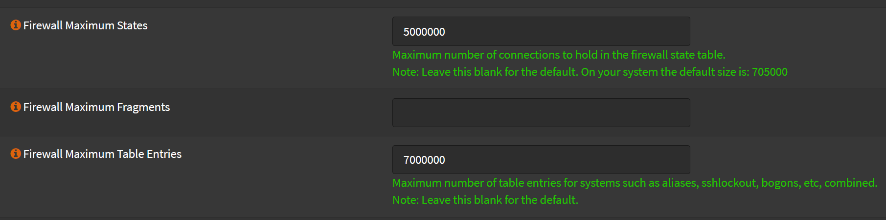

I'm having an issue and I don't know if it's Deluge, the tracker, my OPNsense router, or my modem (modem is in passthrough so I really doubt it).  Based on the evidence, I am almost certain it's Deluge or the tracker, because this problem is happening with only one specific tracker out of the five or so trackers I am using at the moment.
Presently on the problematic tracker Deluge is seeding 1286 torrents (total for all trackers is 1697 torrents).  The problematic tracker's web site reports that I am only seeding exactly 1200 torrents at this moment.  Earlier today it reported 1179 torrents seeding.  Does anyone know what might cause this on my end before I start asking questions of the tracker admins?  Many users of said tracker are seeding more torrents than I am.
Also, the torrents that are missing according to the tracker, report being connected to the tracker in Deluge (no tracker error).  I have tried update tracker (does nothing), force recheck (does nothing), pause torrent and restart (tracker temporarily sees the torrent again then loses it after a while), deleting the torrent readding force recheck.  Nothing fixes it permanently or for more than about an hour.  It also seems to hover around the same torrents.  I have even been uploading on some while the tracker reports I'm not even hosting as well.
I don't think it's settings in OPNsense as I do not lose any torrents on any other trackers.  I'm also allowing a rediculiously huge number of connections:
This is particularly bad because it can happen on new torrents as well as old ones.  I almost got two HNR's because the tracker thought I was not seeding.  Luckily, I caught it in time.
Also, I paused about 100 torrents on said tracker and the tracker maintained connection to all the remaining torrents properly.

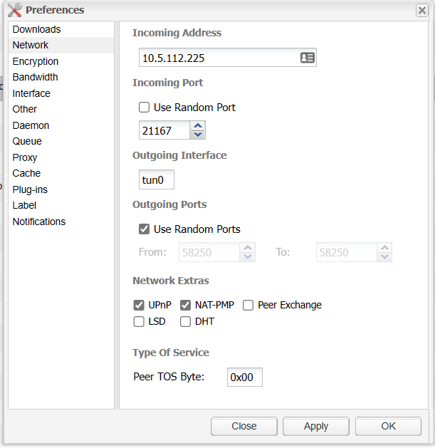

I'm having a strange issue with seeding using this container. I have it set up to both public and private trackers. I've searched the forums for the past hour, but I'm struggling to find anything that helps. Any help would be much appreciated! The information I have so far is below:
  1. Seeding on private trackers doesn't appear to be working fully on all trackers, I only seem to be able to provide file parts to a very very small number of peers (kb's).
  2. Downloads mostly work (for some reason the ubuntu desktop image I only have one seed I can download from out of 1400 odd in the swarm, other torrents seem fine), and when I check the port status, my PIA VPN's IP and Port set by the container on start-up are open (using online port checker tools, and netcat from another linux machine).
  3. I'm assuming the issue is my outbound traffic is not routing correctly through to the other peers as I don't seem to have an issue with inbound traffic.
  4. There are peers I am seeding to, however only rarely does one appear that I start uploading to (I've attached two torrents, one unicorn which I seeded about 10gb to a single other peer showing it's not my upload speed, and one which is typical of the rest of my torrents). I assume those rare peers fully connectable, and I am not fully connectable in the swarm; hence the other peers don't receive as much data because I'm not connectable. I know they are getting files from other peers in the swarm as I can see their % going up.
  5. The settings on the docker are mostly unmodified, just additional port mappings to enable me to route other containers through the VPN.

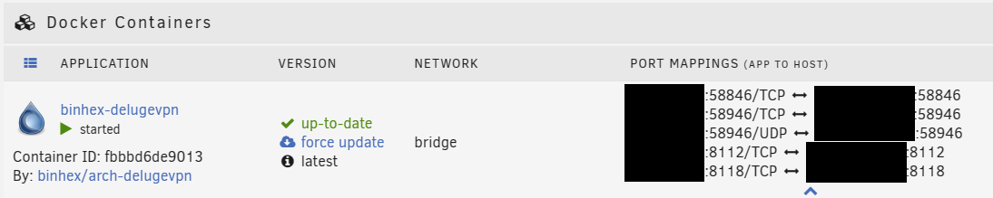

Hi all,
Apologies is this is clearly covered somewhere - I've been troubleshooting for days and not having a great deal of success.
New Unraid user here, using 6.11.5. I have installed the binhex-delugevpn container, and done my best to configure it with NordVPN; specifically I've downloaded the OpenVPN configs (I've done this with multiples, all of their listed P2P servers). I believe I have my subnet set correctly (I triple checked according to the FAQ).
My issue is that when I connect to the WebUI, it will be on for a short amount of time, then disconnect. It seems to just cycle through over and over, restarting every minute or so. I do have the Socks5 proxy set up with the NordVPN credentials as well.

Hi, I'm wondering if I can get some help, I'm trying to get Privoxy to work and in reading the forum I saw that PIA (what I was using) is being flaky so I replaced it with AirVPN. I set up a forwarded port and generated .crt/.key/.key and /.ovpn files and put them in openvpn (removing the PIA files) and when I change the ports to the ones I specified in AirVPN I get this error when I try to save the docker container:
docker: Error response from daemon: driver failed programming external connectivity on endpoint binhex-delugevpn (0ce07624958ca487d10d58fa71eadc16fe5c26b4d69ab7cbcb26546bcc3a61c9): Bind for 0.0.0.0:28312 failed: port is already allocated.
Goes without saying but I also can't start the container. Any ideas what I'm doing wrong?
Where exactly did you do this? You're not supposed to put the forwarded port in the container settings. You put it in deluge settings  for incoming port in the webui when the container has started.
Edited by strike
I am using binhex deluge vpn. When in turn off vpn in setting i am able to access the webui if not the page cannot be loaded. what might be the settings to change. I am using PIA with openvpn
I did put it in the container settings since the container won't start unless there are some ports added, am I just supposed to put some random numbers in there and then add the real ports in the Deluge UI?
