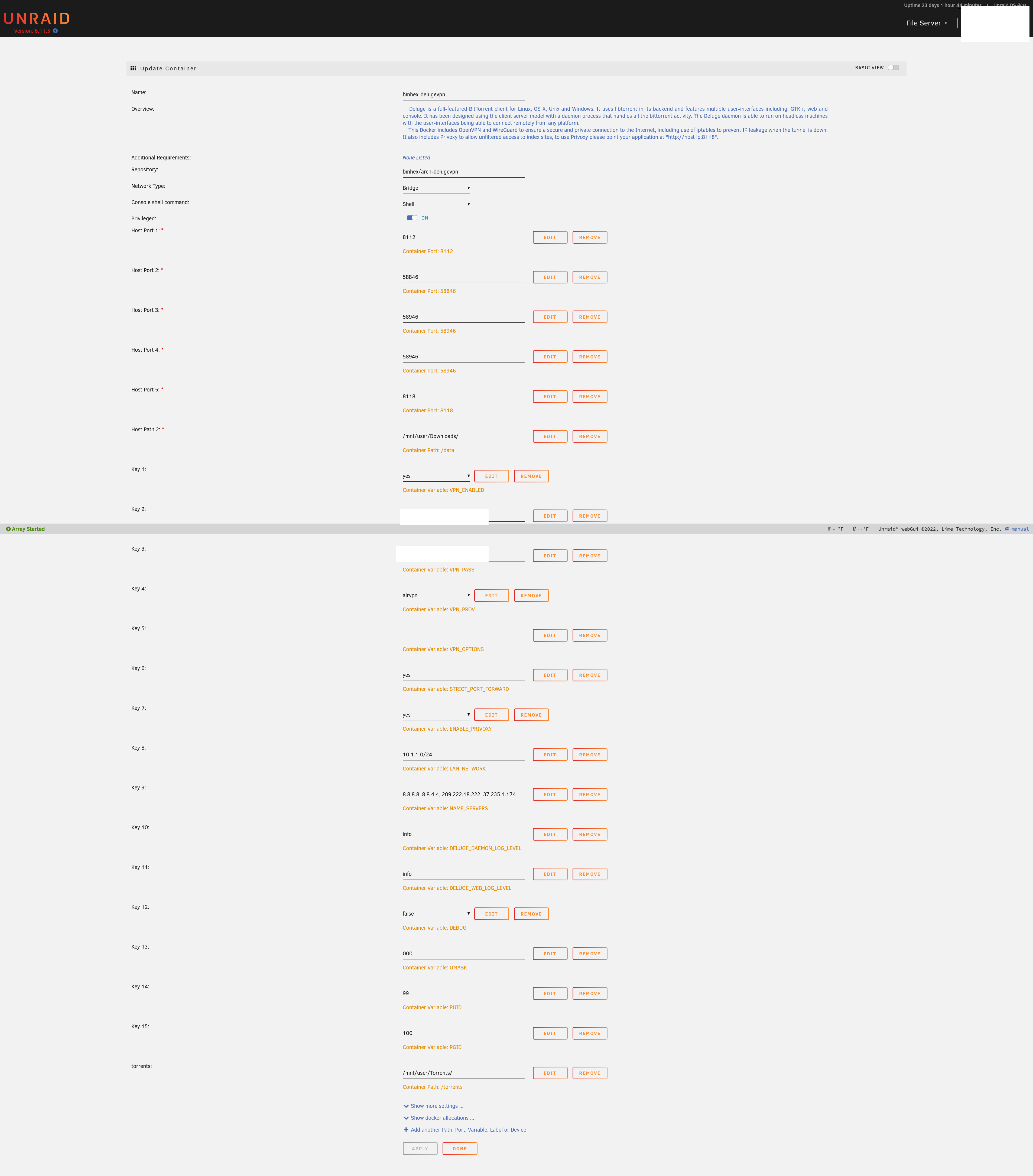

8 hours ago, severanced said:
Thanks, it looks like that was my problem, DelugeVPN start up now, however I'm getting the same problems with getting Privoxy to start that I was having with PIA. Does anyone have any thoughts? I thought AIRVPN would be a bit more reliable.
Did you change the privoxy port or something? Please post your template settings. And enable debug log while you're at it and post a new log. Does it connect to airvpn now and you can get to the webui?
Hi, here are my settings from the container, I enabled Debuging logs after I took this screenshot, and the debug logs too. And yes, I'm able to connect to AirVPN and log in to the WebGUI fine.
77040496_Screenshot2023-01-03at19-55-25CrusherJoe_UpdateContainer.thumb.png.db418dfb5f56ff310e1d384d376a8240.png
DelugeVPN.txt
I can't see anything obvious in the logs aside form the ipv6 errors on the start of the log. But I don't think that has anything to with it. Make a backup of the privoxy folder in your appdata and delete it (or move it to a diffrent location), and restart the container. Did that make a difference?
From the looks of it that made the difference! It seems to connect and, from the looks of it, my other dockers can connect.
Thanks a ton that seems to have worked.
