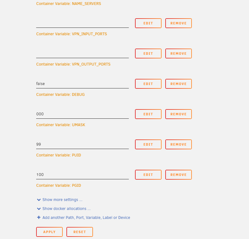

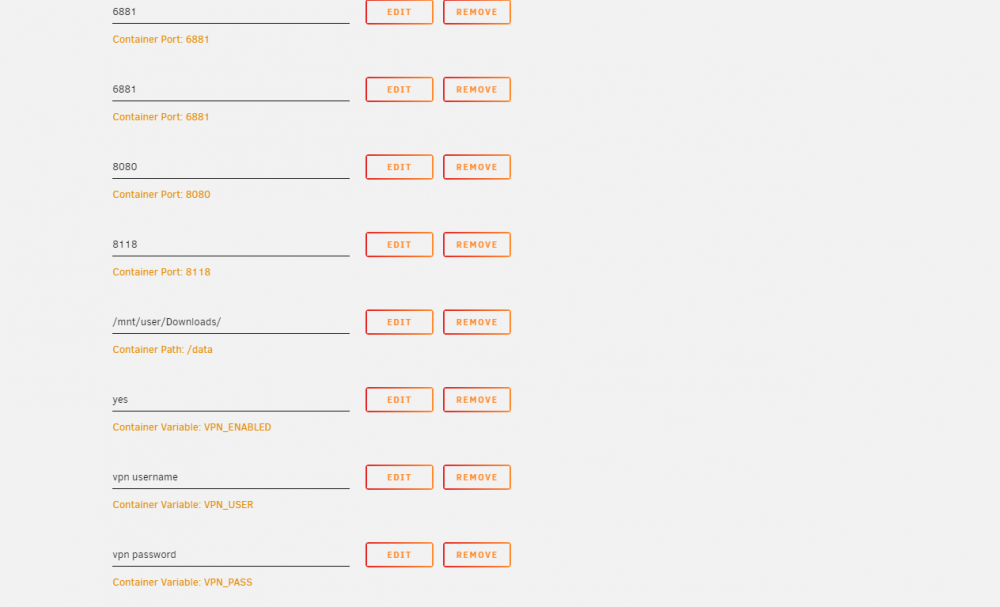

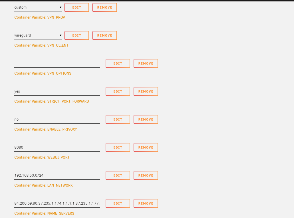

2 hours ago, Wrog said:
I also use Mullvad, Wireguard and binhex-delugevpn.  Did you go through the key generation on Mullvad's website and copy it over as wg0.conf?  Interesting that your log entries don't match mine, can you post your container settings (just the ones you changed while setting up Mullvad)?
These are all my settings. Obviously have my mullvad username and password as my account number. I also even redownloaded the mullvad config file and replaced the other wg0.conf.
These are handled by the public/private keys in the wg0.conf file.  Do the IPs in the wg0 match your WAN and endpoint?  Which repository are you using?  There is a known issue with magnet trackers on the latest (see discussion earlier in this thread, a few replies up), so if you temporarily roll back to v2.0.5 then it works properly (repository "binhex/arch-delugevpn:2.0.5-1-04").
my public ip address and the ip in wg0 are different. I am using 2.1.1 and pulling from docker. I don't think it is an issue with deluge, it also isn't working with qbittorrent as well. neither of these apps can download a magnet link with openvpn or wireguard from mullvad

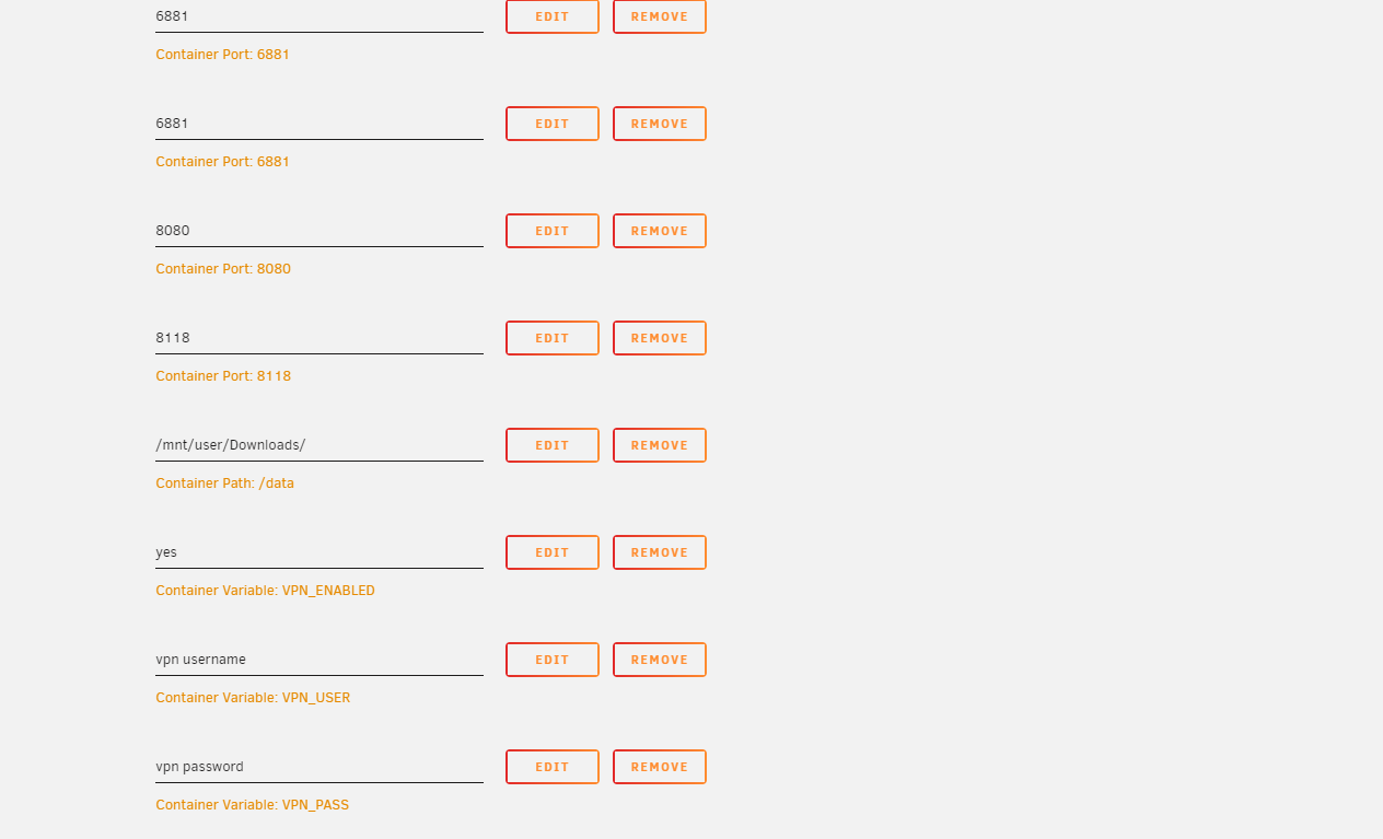

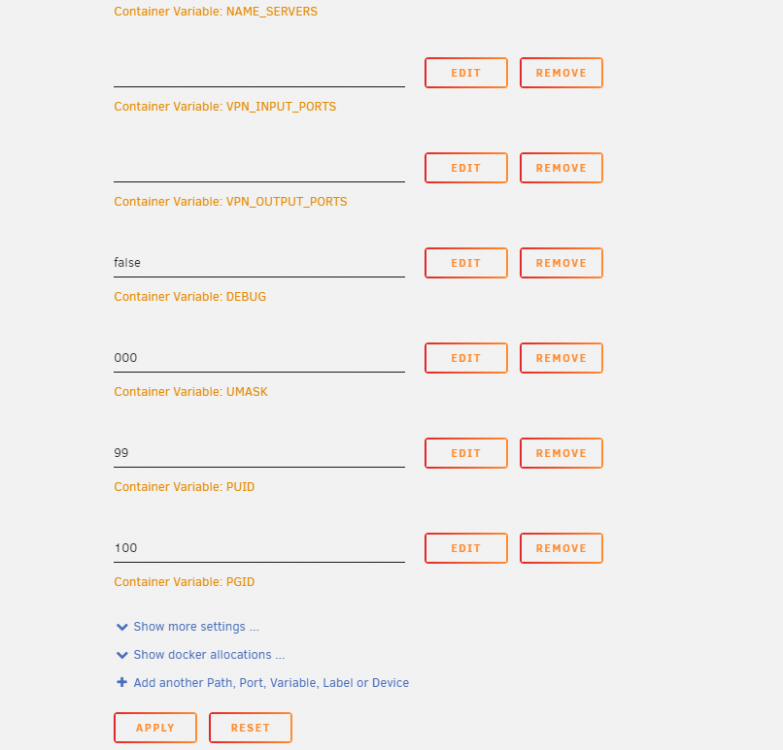

10 hours ago, csandahl said:
actually now it is saying a wan that is different than my own, but magnet links are still not working
Interesting that your container settings have some entries that are different than mine.. for example, WEBUI_PORT doesn't exist for me, and VPN_INPUT_PORTS and VPN_OUTPUT_PORTS are combined into ADDITIONAL_PORTS.  You also don't have either DELUGE_DAEMON_LOG_LEVEL or DELUGE_WEB_LOG_LEVEL.  If you hit "v Show more settings" or "v Show docker allocations" near the bottom, are there more entries that appear?  Also, is the IP address showing in the bottom right of your Deluge window your endpoint IP or something different?
Edit:  What are the container settings up above, like network type, etc.?
Edited by Wrog
It sounds like you have an out of date template keep in mind changes to the templates cannot be pushed out to users.
