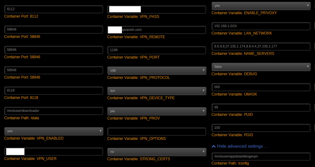

I used to have DelugeVPN docker working fine but had to delete the docker/container and reinstall.  Now I'm having trouble loading the webui.  I've attached the log for the docker and screenshots of the settings I input during setup.  I'm using an IPVanish VPN.
What did I do wrong?
delugeVPN.txt
delugeVPN.txt
Provider is wrong, you have it set to pia, it should be custom. Keep in mind your ovpn and certs will of been deleted because of this and pia ones put there instead, so you will need to download the ipvanish ones again once you have corrected the provider issue and delete the pia ones located in /config/openvpn/
Sent from my SM-G900F using Tapatalk
Okay, so I made the change to "custom" and added the cert and ovpn files from ipvanish back into the OPENVPN folder within Deluge but the webui is still not loading.  The last thing on the log says "openvpn started"

2 hours ago, fonzie said:
Woops. My mistake. I'm editing my password out. hold on.
supervisord.log
You should only have the ovpn file for the server you are trying to connect to in the config /openvpn folder.
