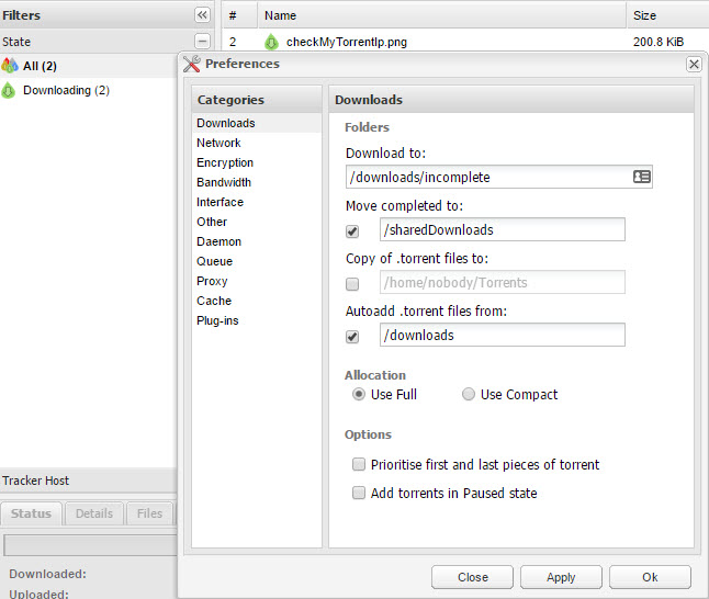

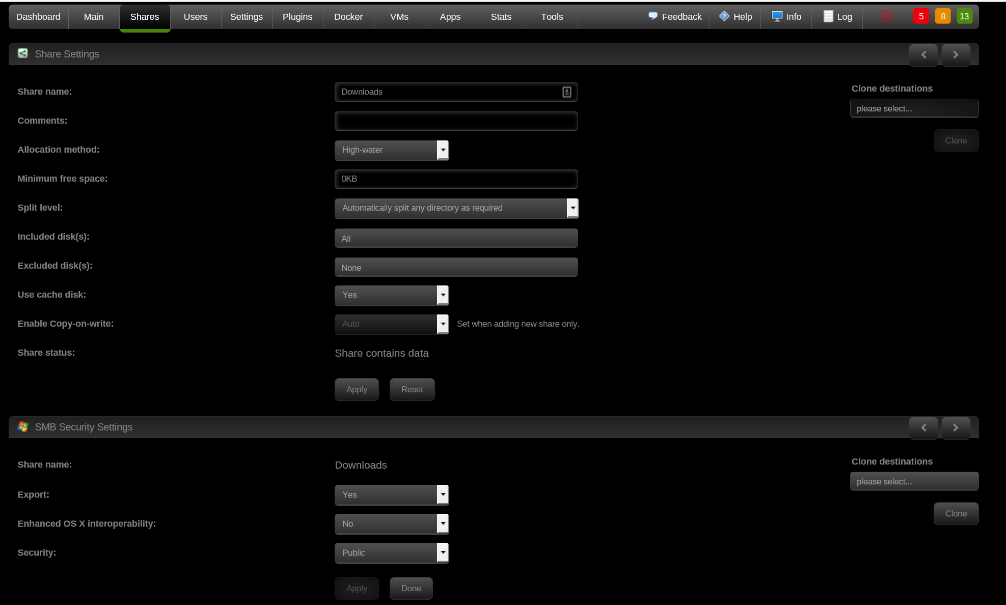

When i download a torrent it is going onto the cache drive but not moving to my share folder, i have tried MOVER but still nothing.
Can anyone tell me what i am doing wrong please.

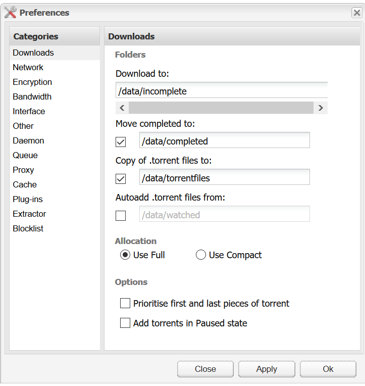

Greygoose,

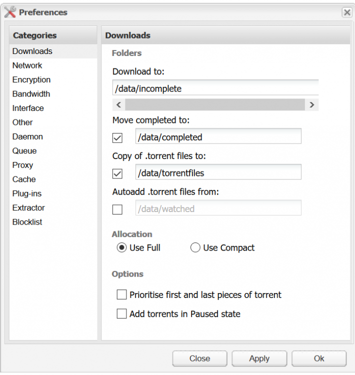

I think the setting you need is inside the delugeVPN preferences.  This is how I have mine setup:
Edited by scott47
Realized I needed to add docker settings
Hi Scott47
Thanks for the help, it is appreciated.
I have it setup as follows.

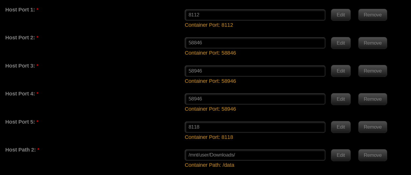

What is /data mapped to in your delugeVPN docker?

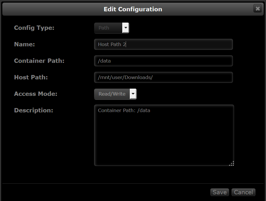

I'm thinking that if you map it to /mnt/cache/Downloads, the file could be locked *on the cache drive* by deluge.  If it's moved, you'd stop seeding.
If you map /data to /mnt/user/Downloads in the docker, it should be movable but then sometimes containers don't like to be mapped on user shares so that might not work for completely different reasons :)

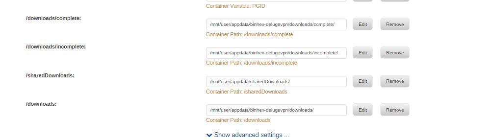

Hi Gog,
I have it mapped like this,.

Hi Gog,
Have you tried stopping the deluge docker then run the mover manually?

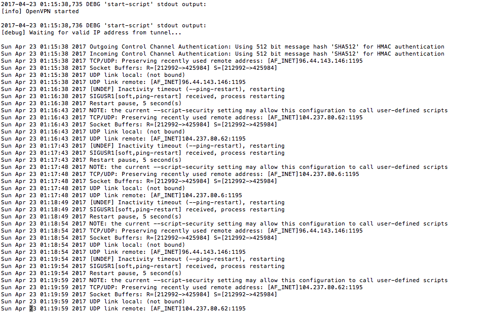

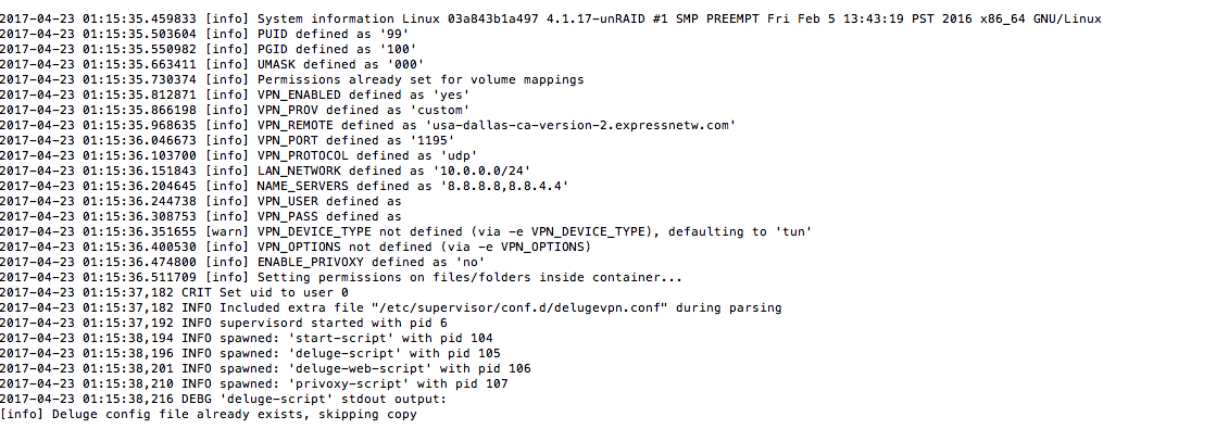

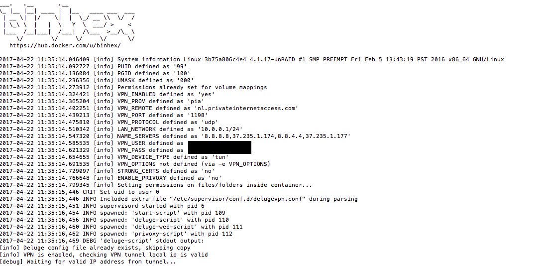

One more question... I had very slow download speeds with pia, so I'm trying to switch to express VPN as a provider.  I'm running int a problem, attached are the head and tail of  my supervisord.log.
Sent from my SGH-I337M using Tapatalk
I did that and it sorted the issue, i was also missing a /   from the config which i changed.  now eveything is good :D
58fc3c31a2263_ScreenShot2017-04-23at1_27_00AM.thumb.png.5784605ae10aad8fd566970d34559cd3.png58fc3c4f9db7d_ScreenShot2017-04-23at1_24_43AM.png.a78723a5a4e9abe458fcb1b017f75324.png
I need the full log to diagnose any issues, but at a guess I would say your attempting to connect to the wrong port or endpoint.
