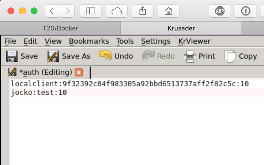

Maybe this is a general question about Deluge.
I don't under stand why i can't add a user and password to Deluge.
Apparently i need it to get Couchpotato to communicate with Deluge.
I used Krusader to edit Auth file and added username and password,restarted Deluge.
But i never get the opportunity to choose user when i start Web-gui.
What am i doing wrong?
my sig, click on the vpn docker faq link, then scroll down to the delugevpn specific section, its answered there.

I am not aware of any changes that I have done recently.
Any help would be greatly appreciated.
