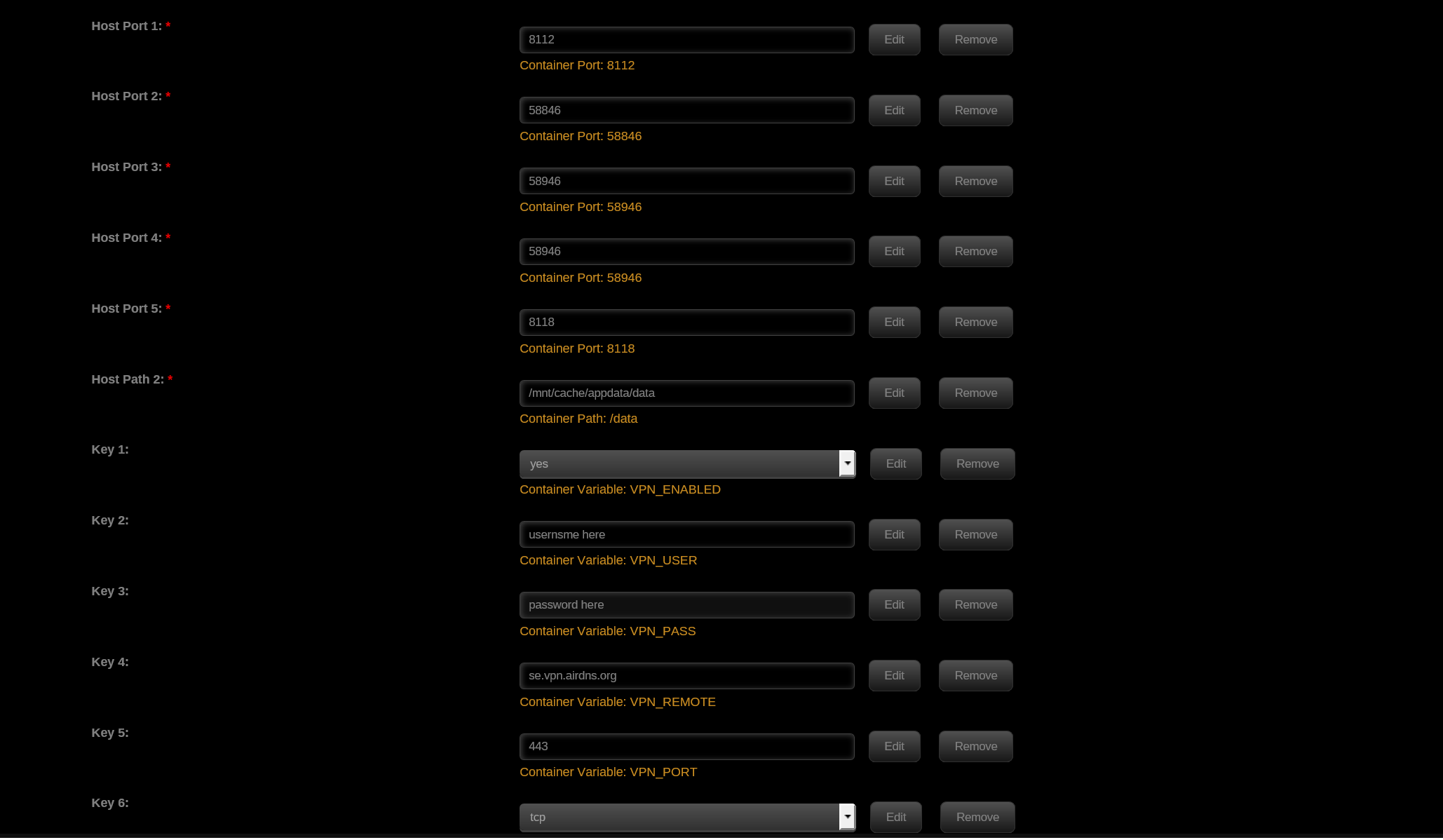

you got the wrong port there @freshjms nordvpn uses port 443 NOT 1194

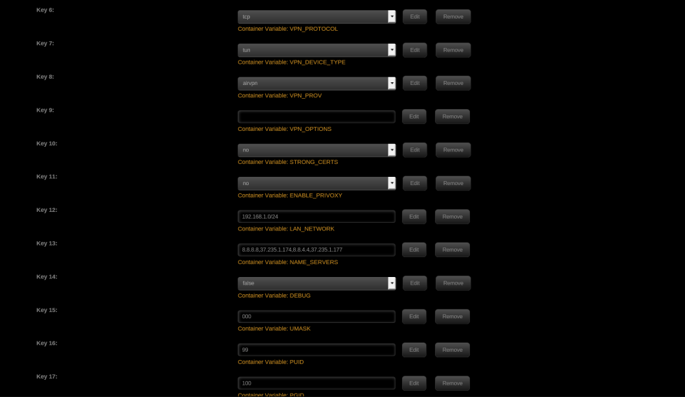

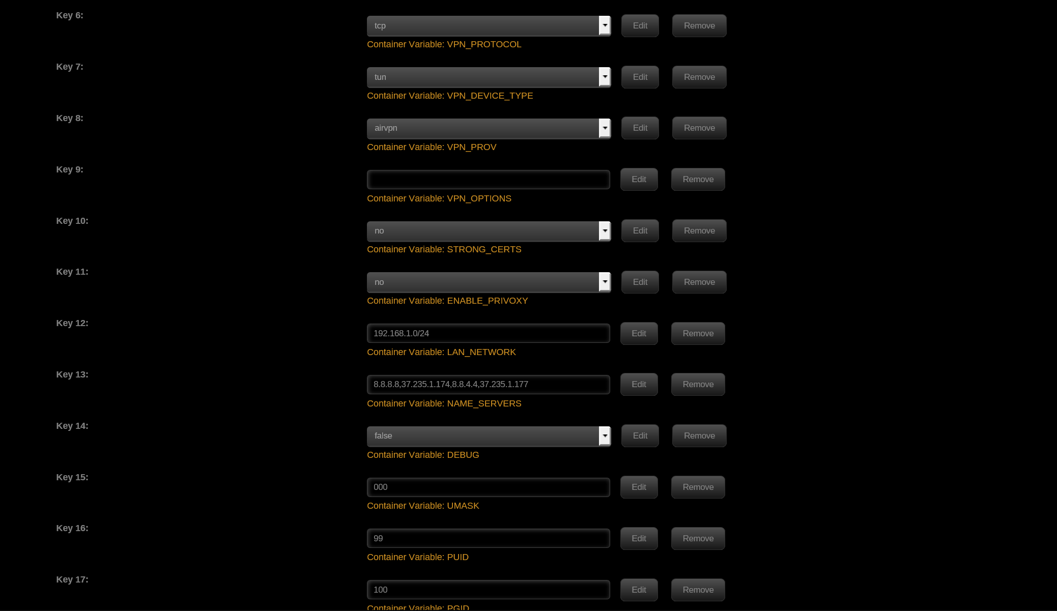

Air VPN still not working :/
you still have it set to tcp not udp.
quote from mr-hexen:-
What value do you have for protocol? 443 is TCP and default is UDP.
edit - taken from a post on the airvpn forum:- Click on your favorite option (if you are in doubt, just choose 443 UDP).

Hi.
i have tried both methods.  Maybe im missing something, must i copy the .ovpn file into the deluge directroy?
Ok airvpn now working :D
I had to uninstall then delete the deluge app folder, i then re installed and added the require information and it works perfect.
Thank you
