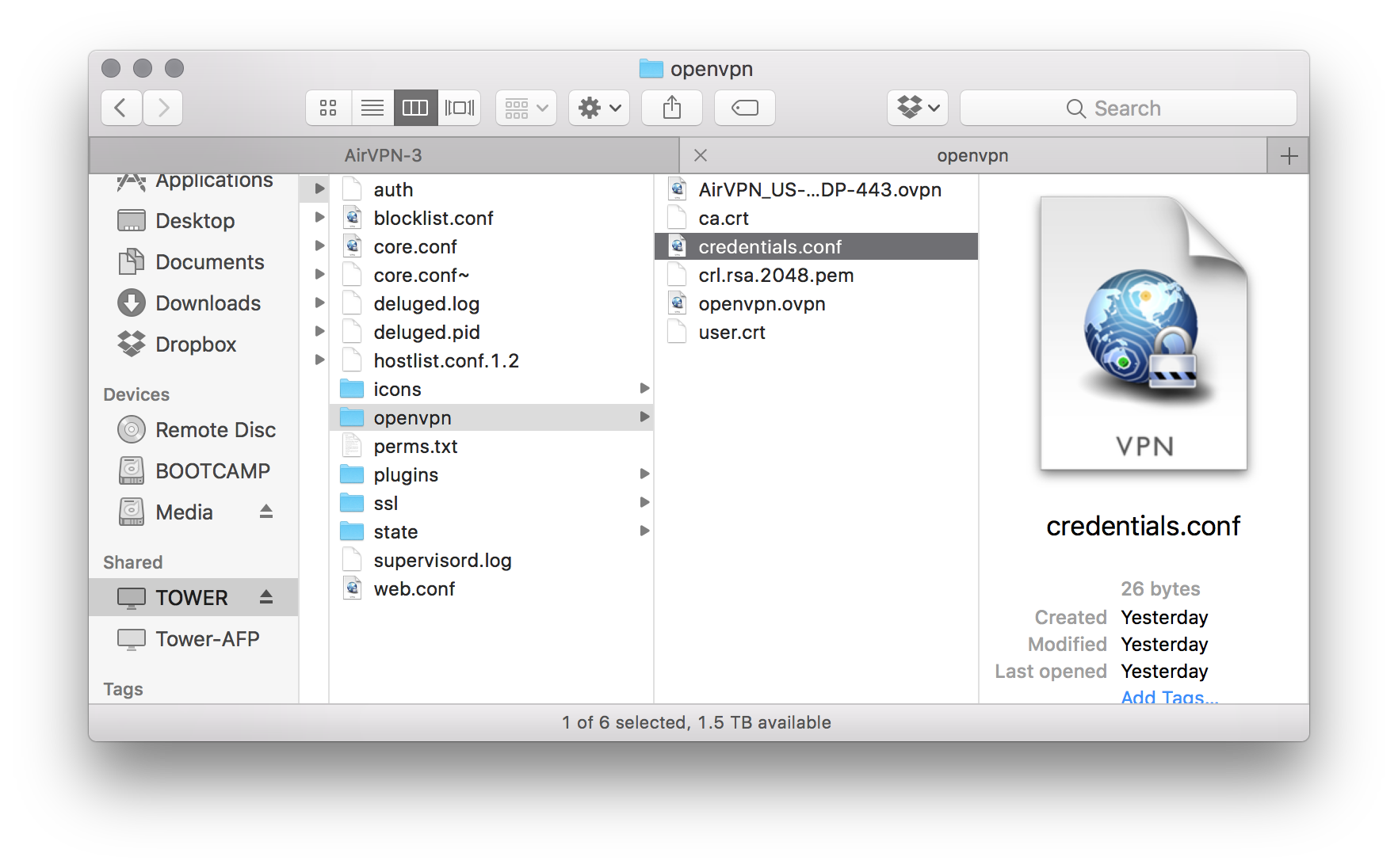

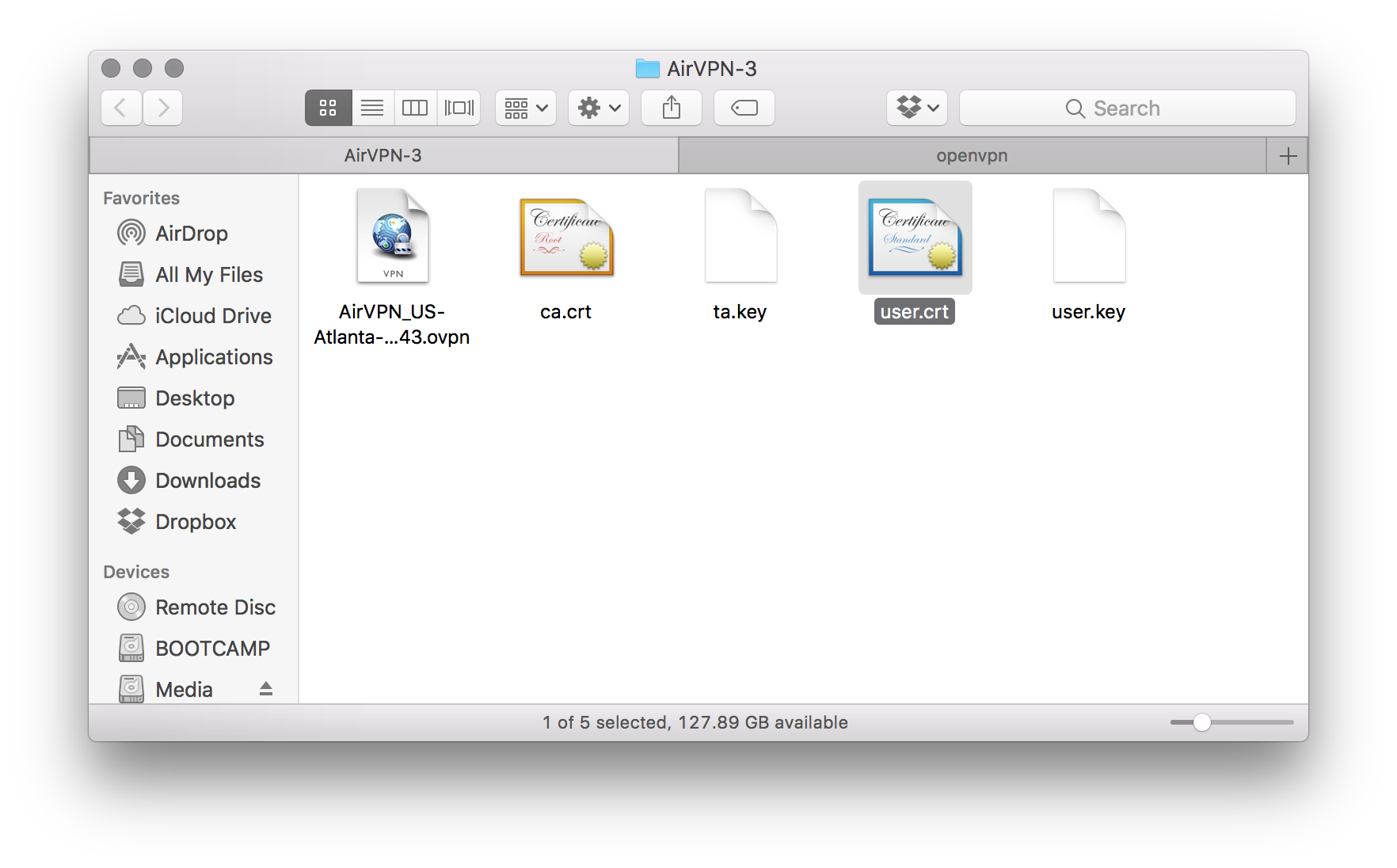

1 hour ago, drogg said:
Do I need to rename it or remove anything from the folder? I got a ca.crt and user.crt file from AirVPN.
You should only have the one provided by airvpn in there.
Here's what I got from AirVPN and what my app data folder looks like. Sorry if my noob is showing, just got started with Unraid!
 58c82284a3ab6_ScreenShot2017-03-14at1_03_04PM.thumb.png.661422bc2630435c8b1522962d7b41da.png
I previously had this all set up and working but after recreating the container I think I'm having an issue with my DNS. I'm using BT like a few others who have reported similar issues and I was wondering if anyone knows how to manually set the DNS on a BT Home Hub 5? I've set my DNS to Google on Unraid itself but when the container starts in debug mode it is listing a few extra DNS servers that I don't recognise. After this the container stalls waiting for valid IP address from tunnel. I'm hoping it's possible to fix this without purchasing a new router.
You need to download the AirVPN_US-Atlanta....ovpn file again but this time untick the box that splits it into 5 files. This way the singele file contains all the data you need. The strange thing is that by default the file won't get seperated, so it looks like you have ticked this option under advanced settings in the config generator.
When done copy this new file into the openvpn folder and delete all the other files.
I was under the impression that I also needed the .crt file, which is why I'd checked the Advanced Options on AirVPN. So the only file that should be in there is the generated .ovpn file and not the rest of the files made by DelugeVPN?
Yes, only the .ovpn file should be in the openvpn folder
Still no dice. I'm going to remove and retry from scratch.
EDIT: Nada. Can someone maybe post their Container page so I can just copy it? I'm not sure what I'm doing wrong.
Edited by drogg
You generated a new file right? Be sure to set the port and protocol to the same as when you generated the ovpn file, and also set the vpn_remote variable to the address in the opvn file.
Edit: hard refresh fixed it. Thank you so much for your help!!
Edited by drogg
