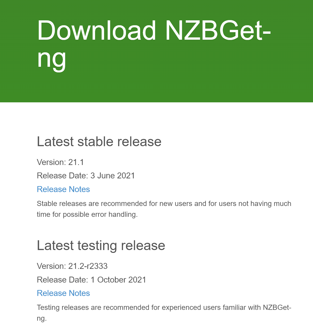

Well in nzbget-ng current state, probably nothing as the download would then need compiling, you would also be performing a rather large downgrade not an upgrade, note the dates:-
As you probably are aware i prefer stable releases over new shiny, but in this case we have to go bleeding edge (develop branch - the only branch!) as there are no latest releases, so you are literally running THE latest code available, if releases start to happen on a regular basis then i will switch over to release.
I am going to merge this change into main and push out a new image so feel free to target 'latest' again in around 40 mins from this post.
So the testing release erroneously shows 21.0.0 as the installed version?
🙂 looks that way doesn't it.
