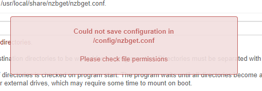

So as i tried to make changes in settings of nzbget-ng i receive the following error:
you dont know were i can find this folder or what i can do to solv this?
you need to go to the support thread for that image, i'm sorry i cannot support other images.
i couldn´t finde one, but no problem, not your image, not your support, thanks anyway :)
Looks as there isn't one.  You can reach out to @welfare, but hasn't been on the forum for a month, and last post is Aug 2023.

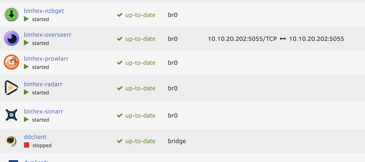

I have noticed that on all of my binhex containers the port mappings are now empty after the latest update of the containers.
The only one that didn't update was overseerr which still has the port mappings.
Any idea how to fix this as it causes issues when I click the webui menu button as it doesn't work.
Have you tried stopping and restarting the docker service? You should be able to use the template function to reinstall with previous mappings…or edit them all as a last resort.
Yes, i have tried restarting the docker service.
I have tried doing a force update.
I am not sure what the 'template function' is (i assume you mean reinstalling from template) i havent tried this and dont really want to delete all of these containers to do this,
In terms of editing them i am not sure what has been removed in the last update to edit them to put it back.
