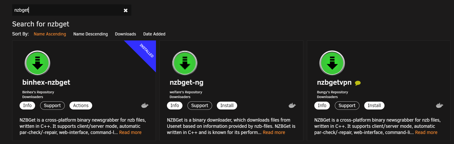

I only have these in Community Apps, so try the ng one or not? sry i am pretty new to all this

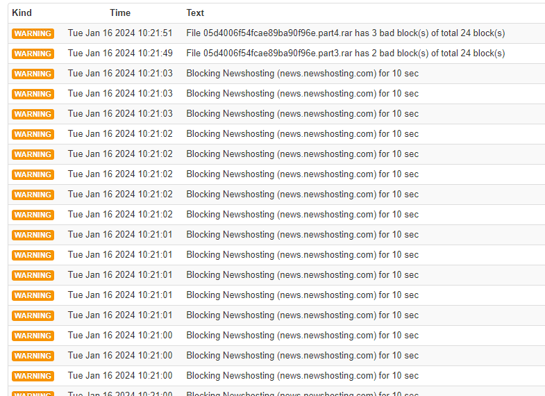

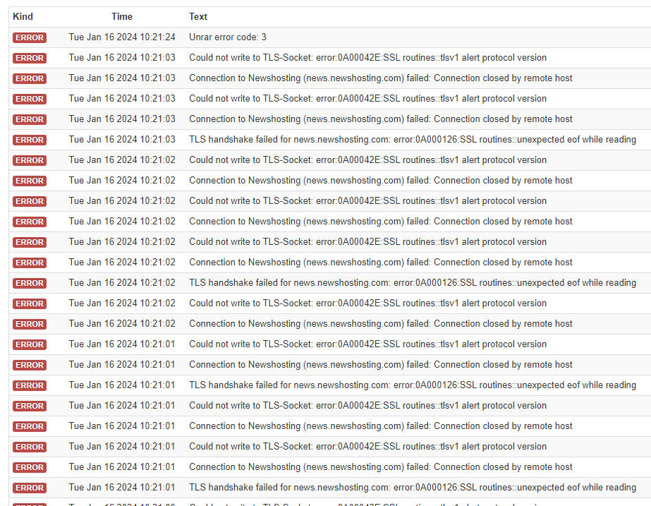

for TLS think i always have messages like:
not sure if this is what you asked for/needed, if not let me know what you need and i will try to find it :)
i guess you could try the nzbget-ng image, but i have no idea if the unpack issue exists or not.
As for the TLS issues it maybe driver related, are you running Realtek NIC's by any chance?

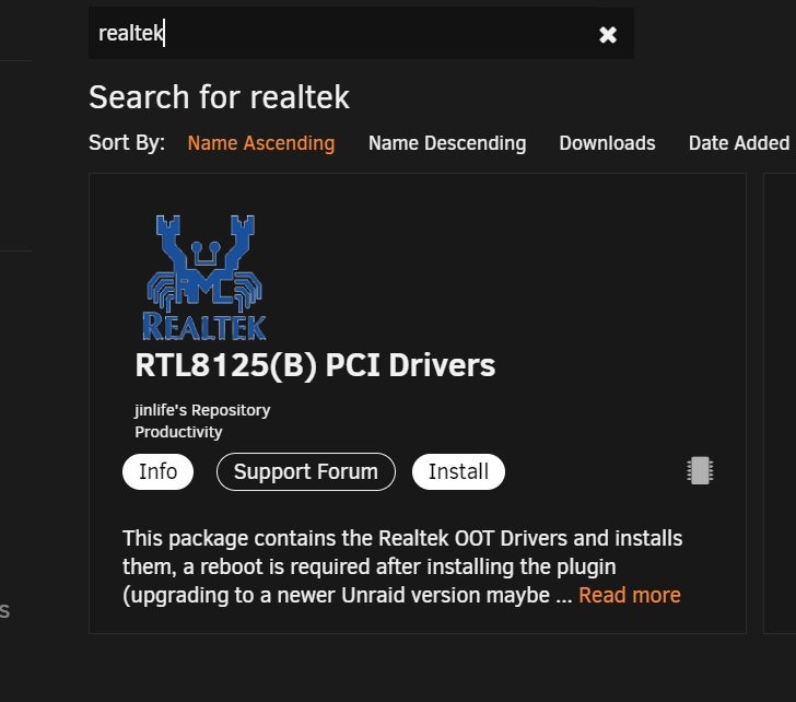

so i need to install a driver for unraid from community app? and what do you mean with "nic"
think i am not getting what you are pointing to, sry
Possibly, yes, Realtek NIC's are notorious for having bad linux drivers leading to issues, i think there are drivers available via unraid 'plugins' but i have no idea if they will fix your TLS issue or not.
NIC = Network Interface Card.
thanks for your help,
so i would try the following and see if it work better
ok this not fixed my TLS issues
