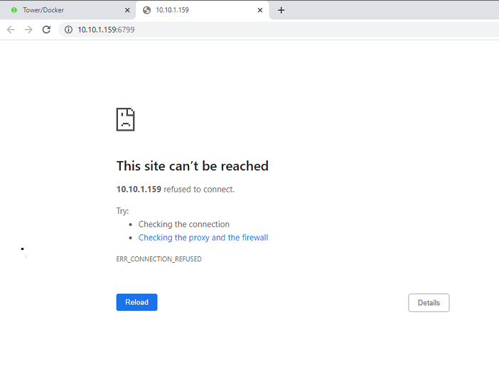

Hi, everyone!  I'm having an issue hopefully someone can help me out with.
I can't for the life of me get into this Docker container.  I've stopped it then restarted it, completely removed it and reinstalled it, everything I can think of and I just get this:
I'm not sure what changed, but all of a sudden, that's all I get.  Anyone else have this happen?
I'm having similar issues with a few docker containers... very slow to start up and reach the running state. Go to the Dashboard tab for your unRAID, click on the binhex-NZBGet docker icon and choose 'Logs'. Your log should show if NZBGet started properly. Here's a snip of a successful start of the container:

I'm seeing similar issues with the Firefox docker container where it's VERY slow to process the container startup scripts. I haven't come across a solution yet so I patiently wait until the system shows the successful start in the logs before attempting to open the web UI. At least looking at the logs may give you a clue as to why it's taking so long to startup.
Yup...the log shows it's starting and running as you showed but the UI still won't connect. I don't really care about the UI...is there another way to get into the thing? I need to add some stuff to download.

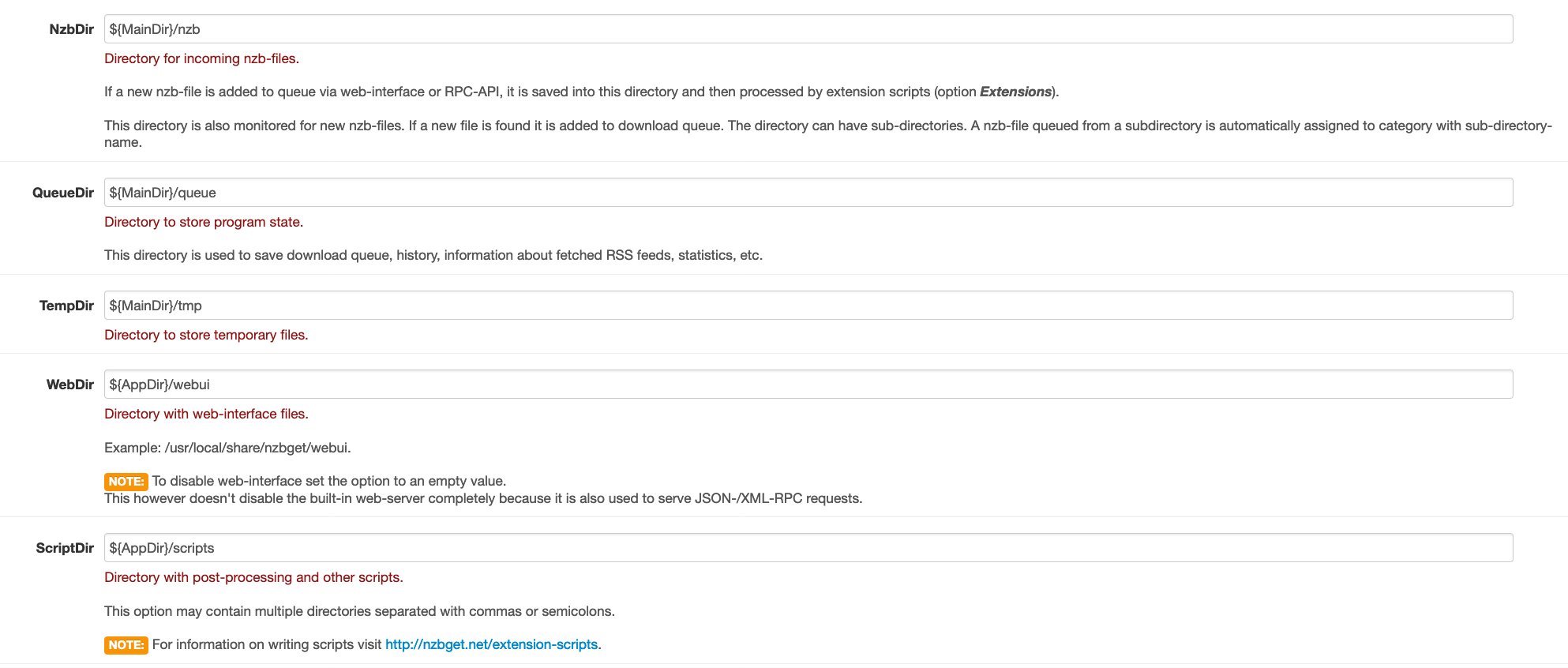

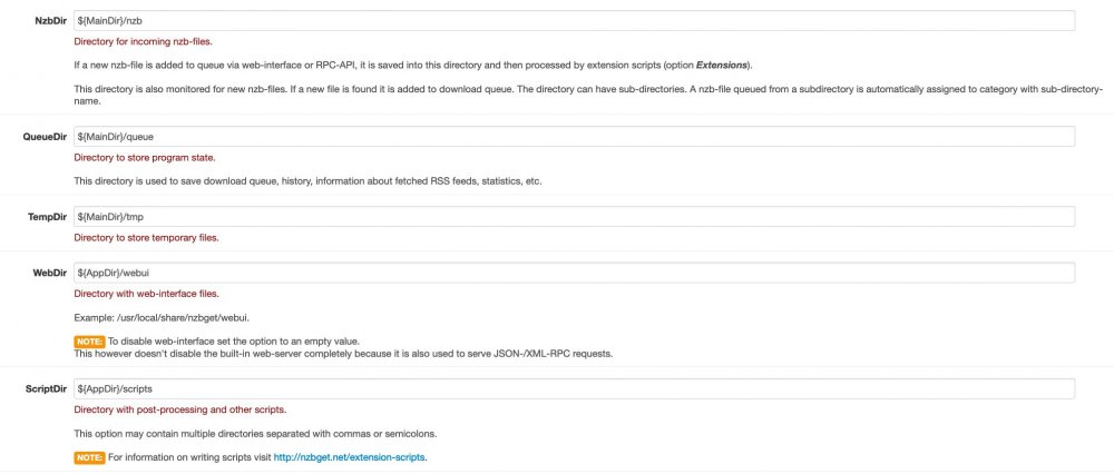

I'm sure I'll remember how once I'm told, but I'm having a problem locating the 'scripts' folder in the binhex-nzbget docker container. As shown in the attached screenshot from nzbget settings, the scripts path (and webdir path) is prefaced with $(AppDir), whereas the other folders are prefaced with $(MainDir).
It's easy to find the folders from $(MainDir) under the appdata folder for binhex-nzbget. But for all my effort I can't seem to find the folders prefaced by $(AppDir). Sure I could create my own 'scripts' folder by changing the path in settings to $(MainDir) but that would invalidate any scripts already in the container.
I need to add a custom script to handle the nzb files from a particular nzb indexer. The script is written in Python so I also need to ensure that Python 3.x is installed. I've opened the shell console for the binhex-nzbget container and have searched through almost every folder I can access to try and find out where $(AppDir) points to.
If anyone can help out with locating this folder path, I'd appreciate it. It's likely so obvious I'm overlooking it. Also, I'd like to know if installing Python 3.x and the lxml toolkit for Python is done on the host unRAID OS or if it has to be built into the binhex-nzbget container?
Any pointers appreciated.. thanks!
Edited by AgentXXL
Found the scripts folder - yay!!
