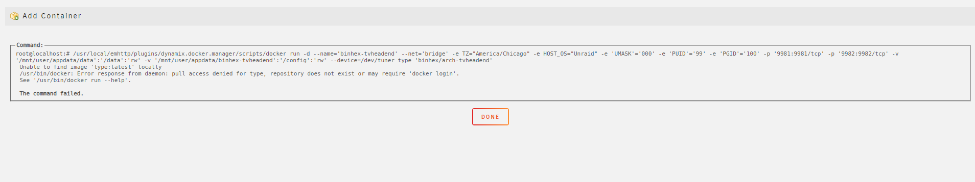

Why am I getting this error?
root@localhost:# /usr/local/emhttp/plugins/dynamix.docker.manager/scripts/docker run -d --name='binhex-tvheadend' --net='bridge' -e TZ="Europe/Kiev" -e HOST_OS="Unraid" -e 'UMASK'='000' -e 'PUID'='99' -e 'PGID'='100' -p '9981:9981/tcp' -p '9982:9982/tcp' -v '/mnt/user/tank/tvheadend':'/data':'rw' -v '/mnt/user/appdata/binhex-tvheadend':'/config':'rw' --device=/dev/tuner type 'binhex/arch-tvheadend'
Unable to find image 'type:latest' locally
/usr/bin/docker: Error response from daemon: pull access denied for type, repository does not exist or may require 'docker login'.
See '/usr/bin/docker run --help'.
The command failed.
The command failed.
You added too much in the extra parameter box. Remove type.

2 minutes ago, plantsandbinary said:
I shut down one docker before trying the other. I'm not trying to run them both at the same time for obvious reasons. I've even tried installing both with the other one not even present on the system.
Secondly, I added absolutely nothing into that box at all. I didn't change any settings at all because there didn't seem to be any reason to and the ports it's asking to use are not being used by any other application or service.
You missed my point with the comment about getting one container to run.
It seems binhex made a typo in the template. As I said earlier, remove the type in the extra parameters box (turn on advanced view if you don't see the box) and it should start.
Also remove the rest if you are not using a dvb card.
yes, that fixes the problem.
definitely a bug in the template.
just fyi guys, it actually isn't a typo, what i was trying to convey (and obviously failing) was that a user needs to define the 'type' of device they want to pass through, obviously i cant know what that is up front, thus the 'type'.
I think you can set it to /dev/dvb as I don't know of any other devices that would be used with tvheadend.

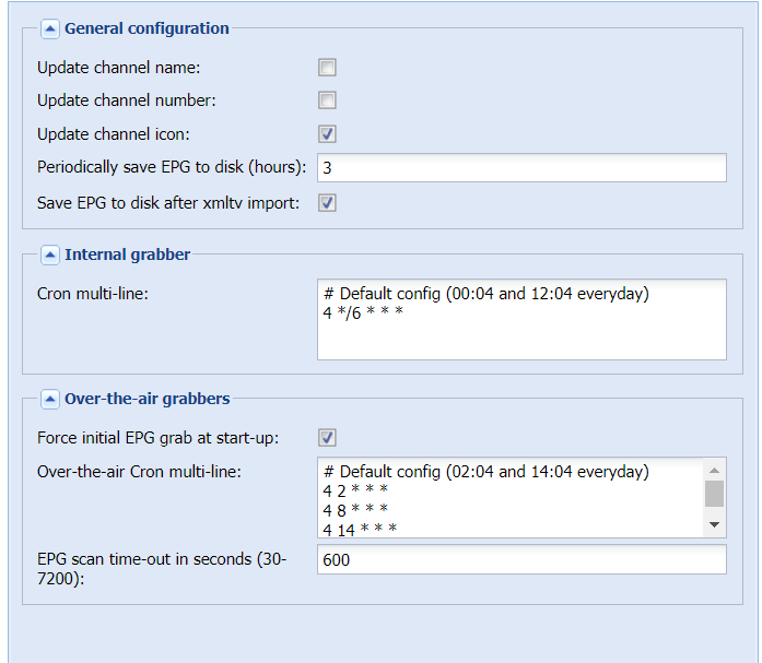

Can anyone help me with the XMLTV EPG setup please?
I have a guide.xml file in the /data folder, and have set enabled to true in the epg config file under the grabber named xmltv.
A restart of the docker and i now have an xmltv.sock file in the epg folder. But this is as far as I have got.
I cant see anything under the epg graber config page on the web interface on how to set up the XML grabber any further (see screenshot) and under the channel editor there are no options under the epg source dropdown and manually typing XMLTV doesnt get retained after hitting save.
Help!
