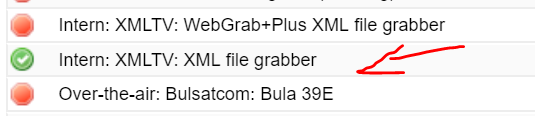

15 hours ago, alturismo said:
enabled this EPG grabber module ?
where is this?
i have in the config file but not found it in the gui.
edit: found it, I dont have an internal option but I have an external: XMLTV grab which is enabled an pointing at the socket file
Edited by geekypenguin

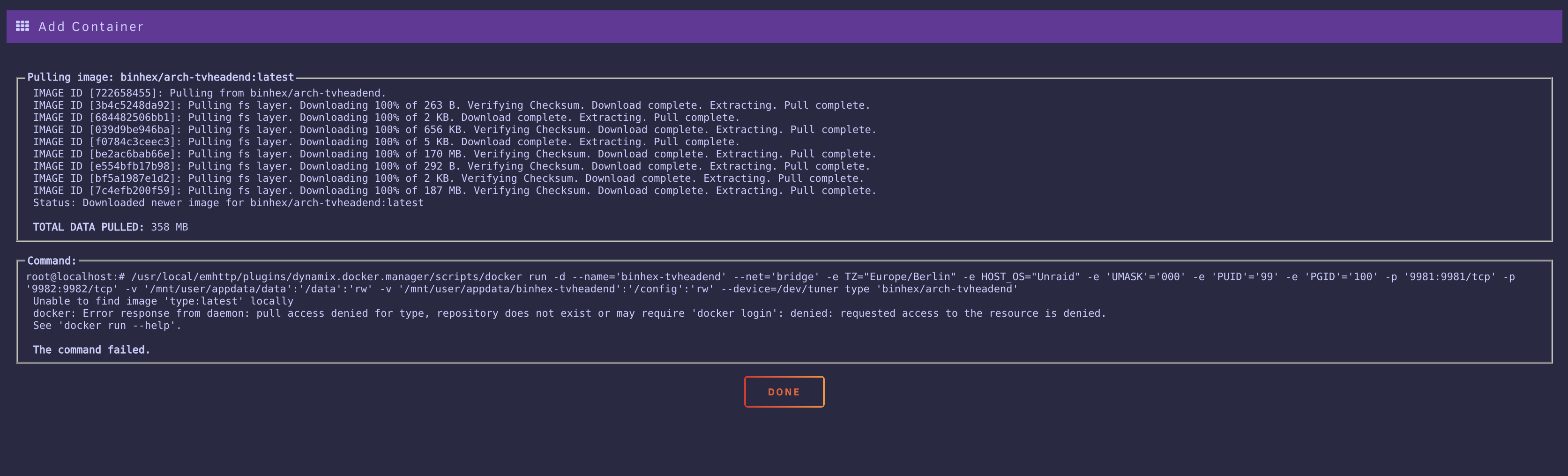

Hello there,
have the following problem, when try install the dockerfile:
root@localhost:# /usr/local/emhttp/plugins/dynamix.docker.manager/scripts/docker run -d --name='binhex-tvheadend' --net='bridge' --log-opt max-size='50m' --log-opt max-file='1' --privileged=true -e TZ="Europe/Paris" -e HOST_OS="Unraid" -e 'UMASK'='000' -e 'PUID'='99' -e 'PGID'='100' -p '9981:9981/tcp' -p '9982:9982/tcp' -v '/mnt/user/appdata/data':'/data':'rw' -v '/mnt/user/appdata/binhex-tvheadend':'/config':'rw' --device=/dev/tuner type 'binhex/arch-tvheadend'
Unable to find image 'type:latest' locally
/usr/bin/docker: Error response from daemon: pull access denied for type, repository does not exist or may require 'docker login'.
See '/usr/bin/docker run --help'.
The command failed.
I think you had to change type:latest to stable or something else, that the image can be downloaded...
Or maybe need docker login?
Thank you!
28 minutes ago, Holle88 said:
Hello there,
The command failed.
Thank you!
Your docker run is broken because you haven't filled in your tuner type. That field shouldn't say "tuner type", that is something you are supposed to replace with the correct value for your specific hardware.
Did you read the docs linked in the first post of this thread?

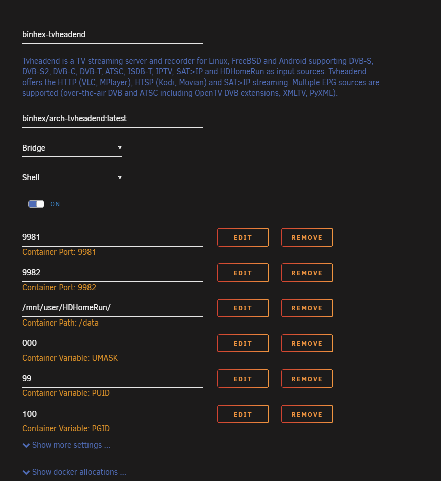

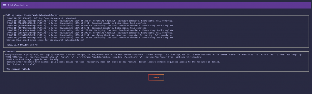

I had this docker installed for a long time and it worked great.  I had to rebuild my docker image file and re-install my apps and found that this will not install now.
When I click on the Install icon, this is what I see;
After hitting Apply, I get the follow errors;
IMAGE ID [1896728381]: Pulling from binhex/arch-tvheadend.
IMAGE ID [3b4c5248da92]: Pulling fs layer. Downloading 100% of 263 B. Verifying Checksum. Download complete. Extracting. Pull complete.
IMAGE ID [684482506bb1]: Pulling fs layer. Downloading 100% of 2 KB. Verifying Checksum. Download complete. Extracting. Pull complete.
IMAGE ID [039d9be946ba]: Pulling fs layer. Downloading 100% of 656 KB. Verifying Checksum. Download complete. Extracting. Pull complete.
IMAGE ID [f0784c3ceec3]: Pulling fs layer. Downloading 100% of 5 KB. Verifying Checksum. Extracting. Pull complete.
IMAGE ID [be2ac6bab66e]: Pulling fs layer. Downloading 100% of 170 MB. Verifying Checksum. Download complete. Extracting. Pull complete.
IMAGE ID [e554bfb17b98]: Pulling fs layer. Downloading 100% of 292 B. Verifying Checksum. Download complete. Extracting. Pull complete.
IMAGE ID [bf5a1987e1d2]: Pulling fs layer. Downloading 100% of 2 KB. Download complete. Extracting. Pull complete.
IMAGE ID [7c4efb200f59]: Pulling fs layer. Downloading 100% of 187 MB. Verifying Checksum. Download complete. Extracting. Pull complete.
Status: Downloaded newer image for binhex/arch-tvheadend:latest
TOTAL DATA PULLED: 358 MB
root@localhost:# /usr/local/emhttp/plugins/dynamix.docker.manager/scripts/docker run -d --name='binhex-tvheadend' --net='bridge' --privileged=true -e TZ="America/Los_Angeles" -e HOST_OS="Unraid" -e 'UMASK'='000' -e 'PUID'='99' -e 'PGID'='100' -p '9981:9981/tcp' -p '9982:9982/tcp' -v '/mnt/user/HDHomeRun/':'/data':'rw' -v '/mnt/user/Automation/Apps/binhex-tvheadend':'/config':'rw' --device=/dev/tuner type 'binhex/arch-tvheadend:latest'
/usr/bin/docker: Error response from daemon: pull access denied for type, repository does not exist or may require 'docker login': denied: requested access to the resource is denied.
The command failed.
Help please :)

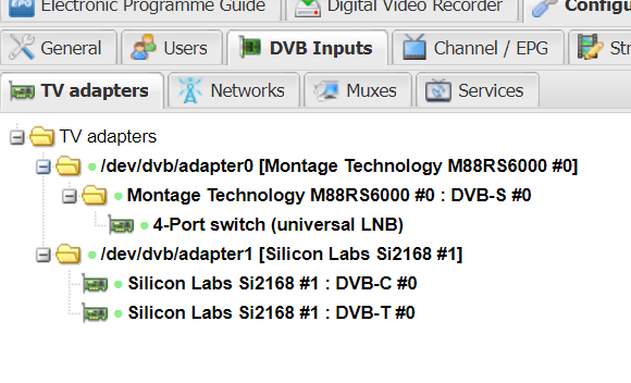

Hello
Can you tell me if this is correct, I can't work out which is the AV In?
Thank you :)
I am assuming DVB-C uses the same input as DVB-S?

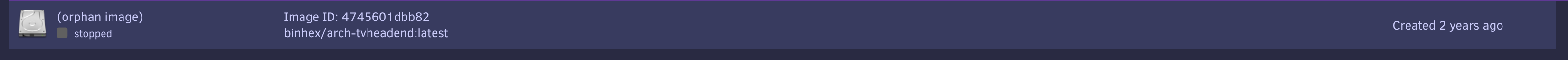

Having the same problem as @optiman resulting in an orphaned docker image. Has anyone a solution to get the docker running? @binhex
your issue is with the '--device=/dev/tuner type' note the space between tuner and type, this is causing docker to think 'type' is a part of the repository name and thus failing, you might need to change it to be in single quotes in order to get around this issue.
@binhex thank you for the quick solution. How can I do this? When using the GUI I don't see that this device is mentioned anywhere in the docker config.
left click tvheadend icon, select edit, click 'advanced view' toggle button top right then look for 'extra parameters' change the value of this to be the dvb device type you want, e.g.:-
--device=/dev/dvb

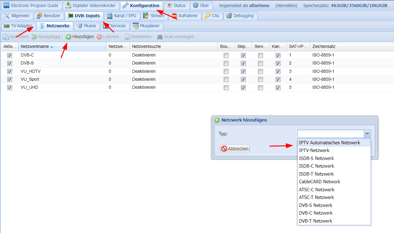

What do I need to put into the device type if I want to use iptv?
I have tried --device=/dev/iptv or --device=/dev/IPTV
I get a failure with
"Error response from daemon: error gathering device information while adding custom device "/dev/IPTV": no such file or directory."
What do I need to change?
iptv is no physical device ... so nothing as /dev/...
may take a look at tvheadend forums about add iptv network and so on ... most common u need to pipe the streams also as they are not .ts standard, just as note ahead, there are plenty threads at the tvheadend forum.
thx

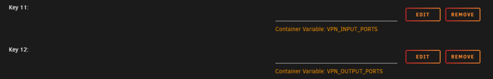

Hello Guys,
is it possible to route the tvheadend trough another docker container with vpn? I made the changes from spaceinvaderone video "how to route any docker container trough a VPN container" but I can't connect to the container. As soon as I changed the settings back to stock, I can connect to the webui
Made the following changes:
Network Type: None
Extra parameters: --net=container:sabnzbdvpn (it's my container with vpn - wireguard)
Added the two ports to the sabnzbdvpn container (9981 + 9982)
Thanks :)
like any container, yes
should be correct and working, may ask in the VPN Forum's from him how to handle this, when i remember correctly he made some changes and added these variables also ... just when i remember correctly ;)
