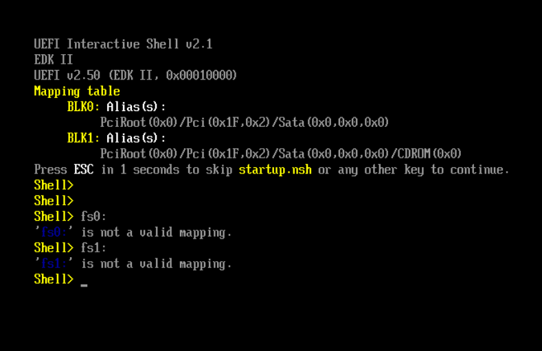

Having trouble booting properly 6.2 as well under ESXI 6/X9SCM  (not supported I know...) with vmdk or plopkexec. No disks are found :(.  Kernel issue??. With two different USB's
Reverted to 6.1.9 for now.

I'm trying to install either Ubuntu or Debian server, can't get past this screen, any advice?
Here is the XML:
Here is the XML:

I had this issue with windows 10 when my ISO was not properly UEFI supported. Switching my ISO resolved the issue. I'm not sure what to recommend with linux guests

Try SeaBIOS instead of OVMF, under BIOS selection.
