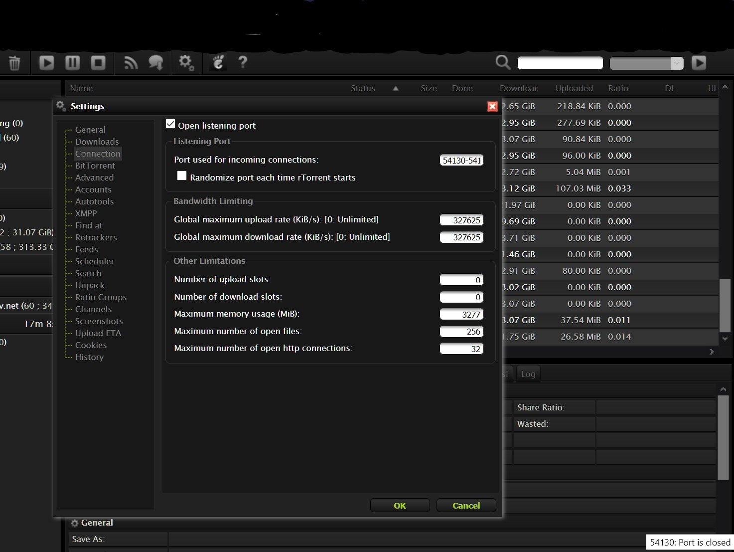

9 hours ago, eman31 said:
I'm trying to run this without the VPN option and am having a hard time figuring out how to get a port open on my router for seeding. Is there a guide somewhere showing the correct settings? I've read through this forum but haven't had much luck or I'm missing something. Any help would be appreciated.
so get a port forward setup on your router, once you have chosen a port then edit the file /config/rtorrent/config/rtorrent.rc and set the same port for the incoming port, note its a range in this file, so if its a single port then just define the same port twice with a hyphen between the ports, e.g.
network.port_range.set = 1234-1234
where 1234 is the port number you have set as a port forward on your router.
Edited by binhex
Thanks for the reply and sorry to be a total noob, what IP address do I forward the port to on my router? Is it the address of my unraid server or does the docker have it's own IP? I've tried the server address but it still says the port is closed. Should the STRICT_PORT_FORWARD in the docker setting be set to "yes" or "no"? I previously had it set to yes running with PIA.
yes.
it makes no difference if using this docker image with VPN_ENABLED = no, that is what you are doing right?, as per your comment below:-
if you ARE attempting to setup port forwarding with the vpn enabled then that is a completely different scenario.
While I know next to nothing about Unraid, I would like to add to binhex answer above. There are 3 layers to think about when setting up port forwarding:
1. rtorrent has to be configured to listen at the desired port (what you did with rtorrent.rc)
2. Docker has to publish the ports to the outside world (e.g, with -p 1234:1234)
3. Your router has to forward requests to your Unraid box. That's what you do in the router's admin interface passing your Unraid server IP and port. Other than that you may also want to set your router DHCP server to always allocate the same IP to your Unraid box so that the setup is stable.
Cheers,
34 minutes ago, binhex said:
yes.
Correct, VPN_ENABLED is set to no but I wasn't sure about the other settings below that.
So what I've done so far is:
Stopped RTorrent docker.
Edited rtorrent.rc by uncomment line 77 and added a port range of 54130-54130.
Restarted RTorrent docker.
Add port forwarding rule to my router at IP 192.168.1.xx on port 54130.
Reboot router.
Start Rutorrent webui.
Everything starts fine but shows port 54130 Closed in the connection bar.
1581854766_Screenshot_2020-02-17NETGEARRouterR70002.thumb.jpg.e206d165b2fdcfff8d9fa727f544e127.jpg2123429361_Screenshot(32)edited.thumb.png.66d3d24285da7f3d2b2d3d2a5e74968c.png
Cheers,
I didn't see this when I was replying to binhex. Maybe 2. is what I'm missing. How would I run this parameter?
Edit: Ok I figured it out how to run the command by searching a little more.
In advanced view I added -p '54130:54130' to one of the empty lines at the top  and now it's showing connected.
Thanks for all the help! This has been driving me crazy for a week and I just wasn't able to find any solutions with all my searching.
Edited by eman31
Added fix
