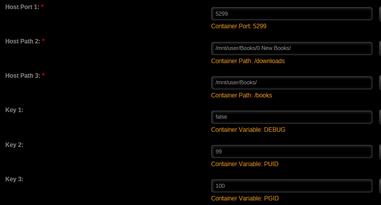

I got this installed today with no issues, but it doesn't seem to be able to find anything on my machine.
Here is the log file:
2017-01-22 18:01:59	INFO	Starting LazyLibrarian web server on http://0.0.0.0:5299/
2017-01-22 18:01:59	INFO	Starting LazyLibrarian on port: 5299
2017-01-22 18:01:59	INFO	[VersionCheck] - New version is available. You are 346 commits behind
2017-01-22 18:01:57	INFO	[VersionCheck] - Comparing currently installed version with latest github version
2017-01-22 18:01:57	INFO	SYS_ENCODING is UTF-8
2017-01-22 18:01:57	INFO	Config file loaded
2017-01-22 18:01:57	WARNING	Download dir not found, books will be downloaded to /
2017-01-22 18:01:57	INFO	Screen Log set to INFO/WARN/ERROR
2017-01-22 18:01:57	INFO	Log level set to [0]- Log Directory is [/config/lazylibrarian/Logs] - Config level is [1]
Also, I've attached an image of the config.
Obviously, from the log above, it cannot find the download directory, and it also doesn't seem to be able to find my books anywhere. What sort of directory structure is it looking for? As I have it currently /mnt/user/Books/ points to the root of my Books share which is where my Calibre database file is, then everything is in /Author/Book format below that.
When I go to the Authors tab, it says nothing is found, and when I click the Library Scan button, nothing seems to happen. I set the log level to 2 - Debug, and clicked Library Scan again, and this is the only line that was added to the log:
2017-01-22 18:12:11	INFO	Config file [/config/config.ini] has been updated
I've also tried changing the host port from 0.0.0.0 to 192.168.1.5, which is the server's actual static address, but that doesn't seem to have made a difference, either.
This looks like a great docker if I can get it working... any suggestions?
UPDATE - I realized that I had a bit of a brain fart, I've got /downloads now pointing to my SAB download folder, so it's not complaining about that, but I still cannot get it to identify any existing books.

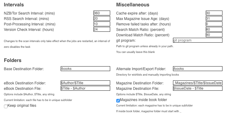

Another UPDATE - I figured out that I needed to go into the Processing tab of Settings to tell it to actually look in the /books directory that's mapped to the container.  Maybe I'll just quit posting questions until I've poked around really thoroughly... :/
