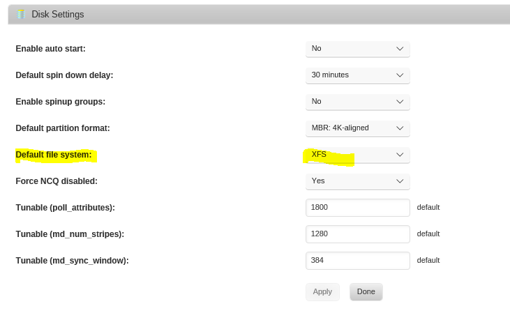

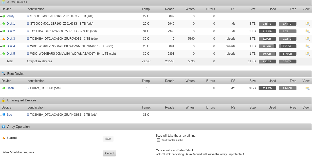

I just removed a 1TB drive from my array, to replace it with a larger 3TB one. I have done this before and all good.
However I noted on this occasion that besides the fact that my default FS is XFS, the main screen is showing the new disk as reiserfs?
Did I do something wrong, or is this normal because the old drive was resierfs and it will change later when the process is finished?
Attaching screenshots.
Thanks.
A rebuld will always restore the original file system.  The only way to switch file systems is to copy all of the files off of the drive and when it's empty to change the file system, format the drive and then copy the files back
Ok, that's weird... If you look at the screenshots, the one that says "disk 1"  replaced another 1TB one with reserves, yet that one shows XFS :S

As far as disk1 is concerned, I can guarantee that when you upgraded it that it was xfs not reiserfs as there is no way unRaid ever does the conversion for you.
