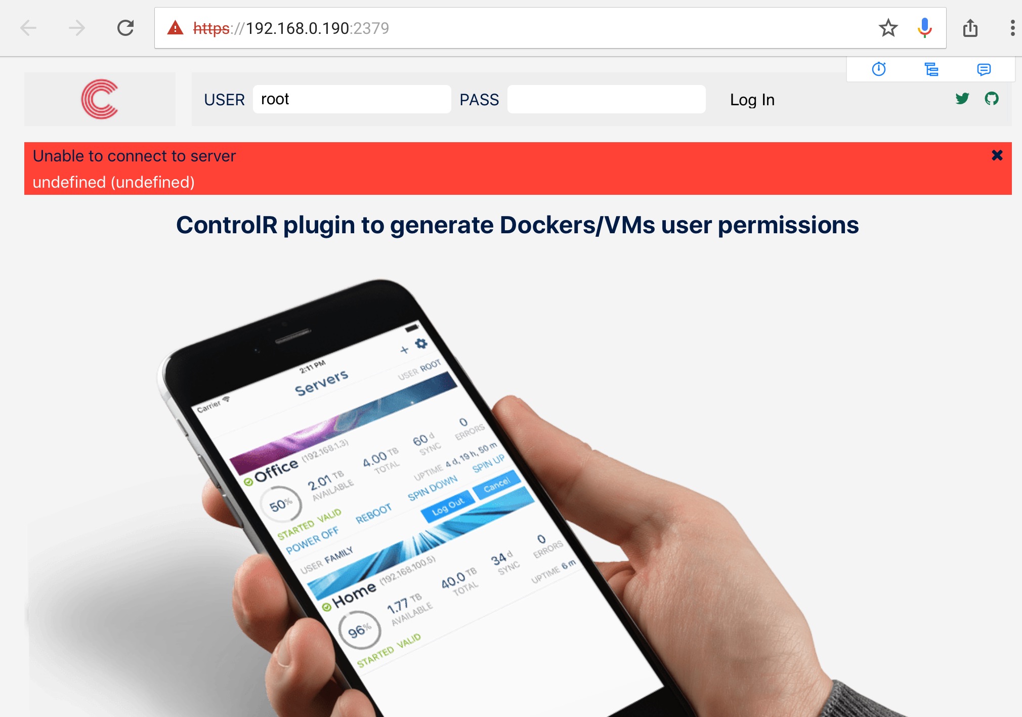

I'm on 6.4 and force to use https for unraid. And I can't longer connect with this app.
//Peter
HI peter_sm,
6.4.x is still on the release candidate phase, and although I have a development version of the app supporting https, I've held on releasing it because there may still be some changes.
In any case, I will try to publish a version with "preliminary" support by the end of next week.
But, the error you posted is related to the ControlR plugin. That should be working :o
Would you mind posting the output of
$ cd /usr/local/emhttp/plugins/controlr
$ killall controlr
$ ./controlr
on the plugin support thread ?
9 minutes ago, jbrodriguez said:
HI peter_sm,
$ killall controlr
$ ./controlr
Done
v2.8.1 is now available !
2.8.1
Initial support for 6.4.x's https. It's still subject to pending changes in unRAID.
Additionally:
- Updated screen navigation component
- General improvements and other bug fixes
This should enable you to connect to an unRAID server via https, provided the server is configured to do so.
Also install the latest ControlR plugin for full compatibility.
Let me know of any issues.
v2.8.2 is available as an over-the-air (OTA) release !
2.8.2
- Restore log functionality
This fixes a minor bug that was preventing logs to be shown.
2.8.2
Update resolved the issue for me.
