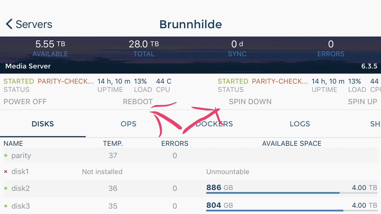

Not sure if this has been reported or not. I just noticed it.
Did you happen to rotate the device while in the screen ?
If you rotate the device before entering the detail page, is it still duplicated ?
