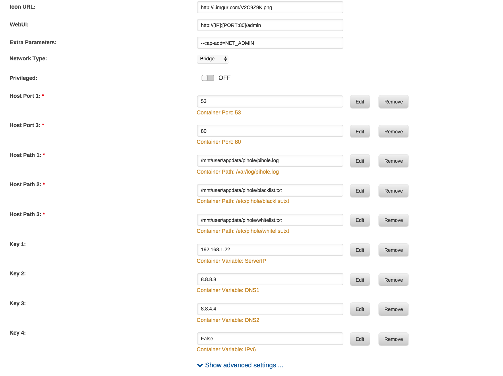

I moved to diginc's repo as it is "directly" tied to the pi-hole development (https://hub.docker.com/r/diginc/pi-hole/). I took spants' template, changed the repository to: 'diginc/pi-hole:alpine' and the docker hub URL to: 'https://hub.docker.com/r/diginc/pi-hole/'.
diginc added a parameter to meet the necessary changes that urged spants to create his container, which is disabling IPV6 support so if you add a new container variable:
Key: IPv6
Value: False
Default Value: False
you should be up and running as spants designed but using the container that follows the pi-hole development a bit closer. Been running for a few weeks and haven't had an issue.

Is this related? Its the template on a new setup:
https://puu.sh/s3sfM/a728584fb0.png
dnsmasq: failed to create listening socket for port 53: Address in use
Script Finished Tue, 01 Nov 2016 18:40:20 +0100
This bit is strange!... are your running two of them?.
I would delete/rename the appdirectory for pihole and try again..
Could be!. silly me. Only needs one port 53.... I have updated the template...
edit... mine had the same but ran ok. attached is my config.
