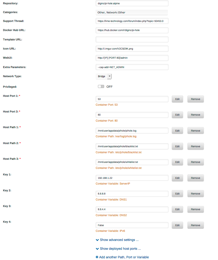

ok, it doesn't do that job - it checks to see if they are in a blacklist and then forwards the request to the dns server ips on the template. Are they correct?
I think so! here's all my configuration (it even shows the URL with the unRAID server IP)
2yJ2gGhg+
thanks a lot!
Here's mine - note the advanced settings with extra params = --cap-add=NET_ADMIN
oh nice! I will try that, what is it for?. Thanks!
Never mind, I already have it as well if I enable advanced settings!. Thanks!
