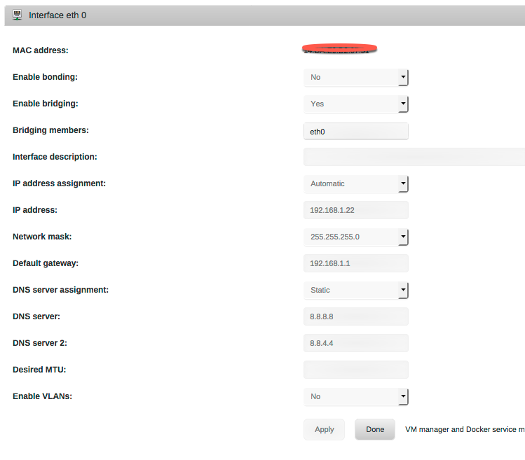

Could it be the two network cards? I have two installed but only one is enabled.

umm I also have only one connected (eht1 if I don't remember wrong). eth0 has no cable :(
Here's how my network settings look like
5EweTKKJ+
ok - you have eth0 connected and not eth1.
Why are they bonded without cables in both?
My config is attached
I've disabled the bonding, so now it looks like:
5O01aSqe+

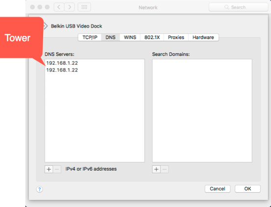

Just in case is of any help, I get the docker running, I can access the web UI but it seems it's not receiving the petitions from devices (query log absolutely empty)
Strange, and the dns of all the clients is pointing to your server?
No, I just tried it with my phone and my iMac but I get no websites loading and no queries on the docker either
So the network settings on the imac and phone all point the dns to Tower?. Anything in logs?
