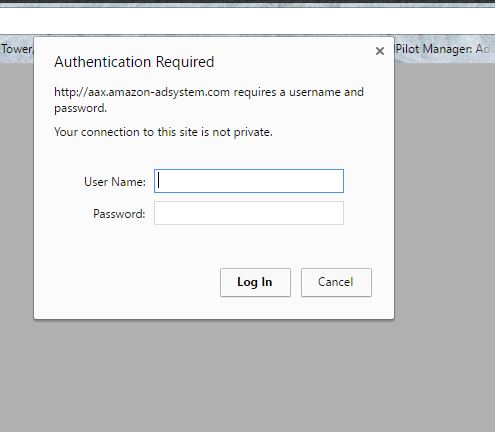

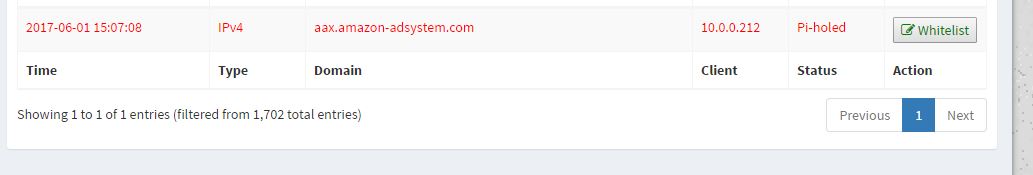

Anyone have any issues with "Authentication Required" on site that have had the add's blocked? I read an earlier response where someone said add these to the blocklist, but they are already listed in my blocklist & were piholed!!
Edited by clowrym
I actually fixed this issue by Giving this Docker it's own IP address, rather than running in Bridge Mode.
