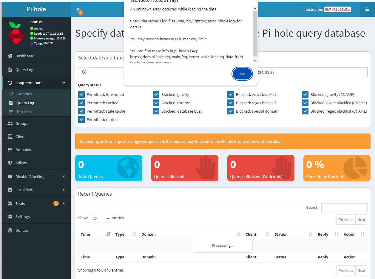

All 4 of these issues are the same, and I am having this issue also. Can anyone help at all? I have seem many on Reddit also.

On 11/22/2023 at 9:21 AM, independence said:
Hi all,
when I´m trying to add a new adlist, there is an error:
"While executing: attempt to write a readonly database"
Do you already know what went wrong?
Thanks
