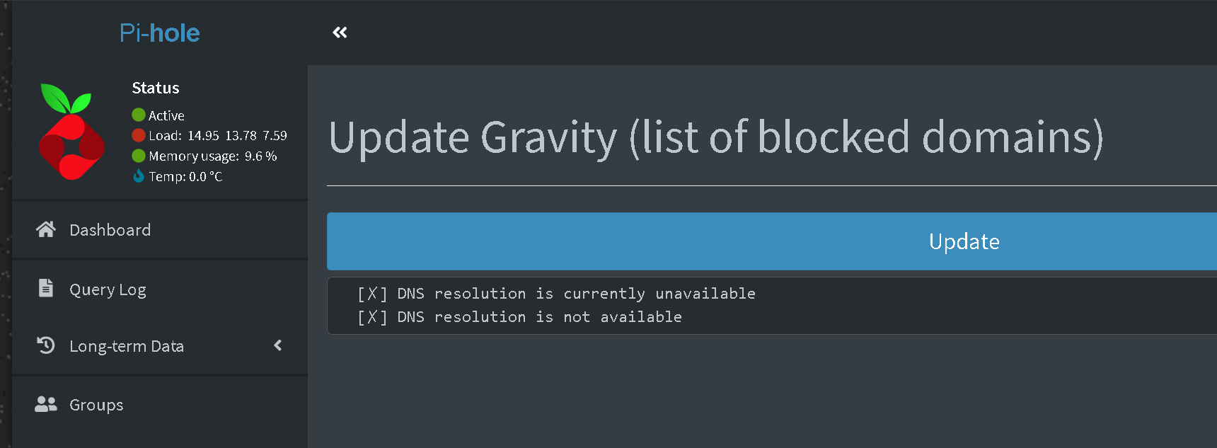

I can access Pi-hole WebUI, but as soon as I login into shell, I cannot ping anything out of host network (e.g. router, dns servers themselved are unavailable).
Thus DNS resolving is not available, etc.
Suppose I miss something simple here, but cannot find what.

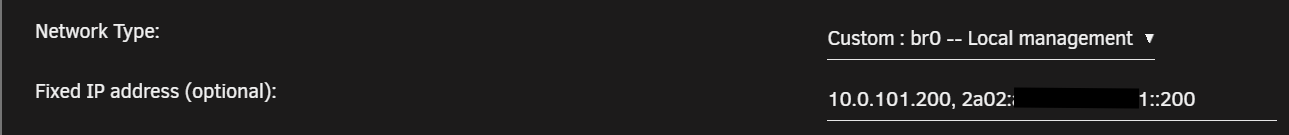

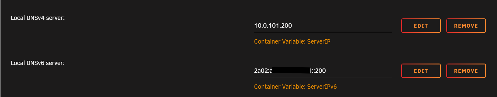

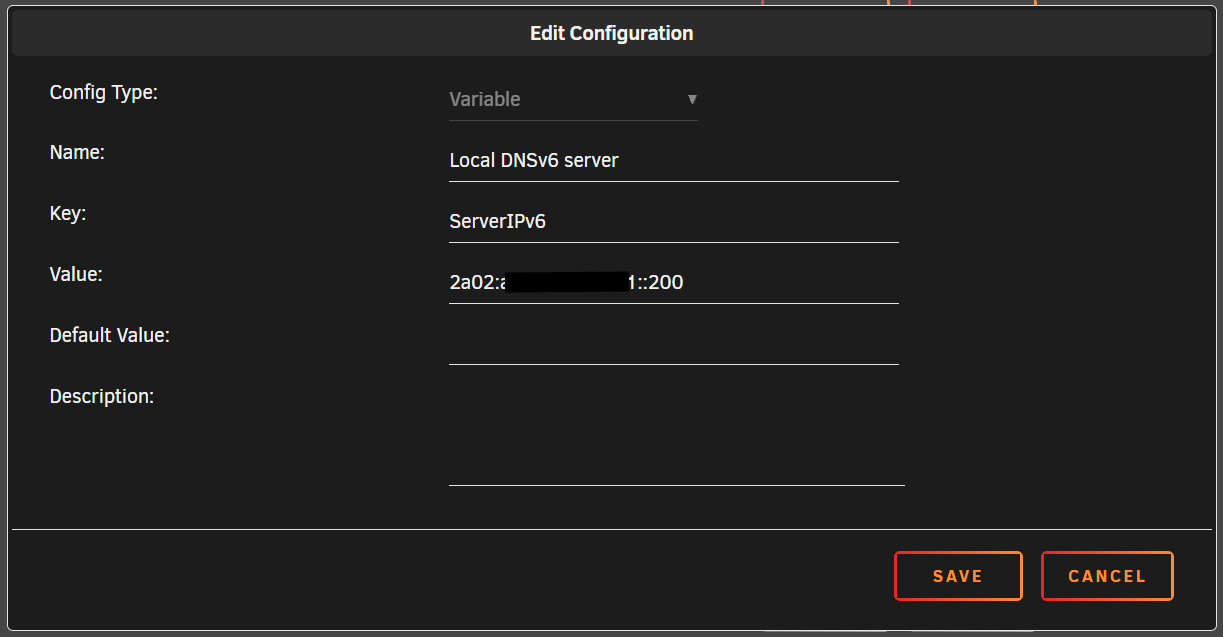

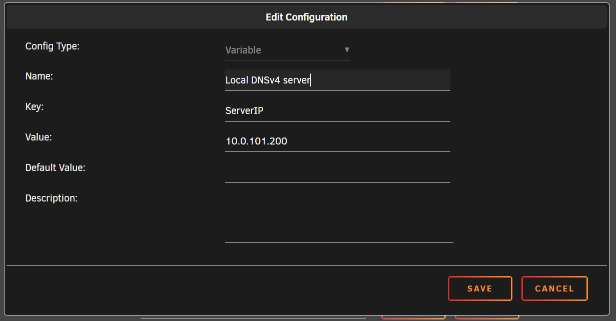

Here are some configuration guide lines for the main interface (eth0 / br0).
1. Under network settings, ensure bridging and ipv4 + ipv6 is enabled
2. Under Docker settings, enable both IPv4 and IPv6 (note: IPv4 you should set a DHCP pool which does not conflict with the DHCP pool of your router)
3. Next you need to configure your Pi-hole container
Assign fixed IPv4 and IPv6 addresses to the pi-hole container (make sure these are valid addresses for your local network)
You need to instruct pi-hole to use these addresses for its DNS function

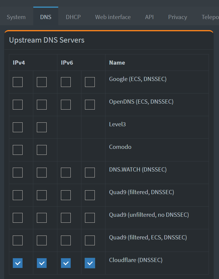

4. Within the Pi-hole container itself, you need to configure the DNS upstream servers for both IPv4 and IPv6. You can use either predefined upstream servers or any custom upstream servers
The last step is to configure your DHCP server (router) to provide the DNS server addresses to the clients in your network.
How to configure this depends on what router you have.

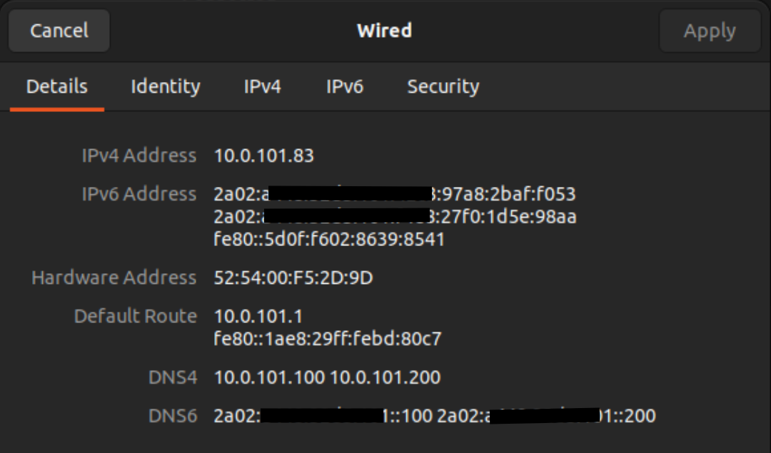

Here is an example of my Ubuntu PC with both IPv4 and IPv6
Note: I have configured a primary (.100) and secondary (.200) DNS server, these are two different pi-hole servers running on different hardware and are used to backup each other in case one is down

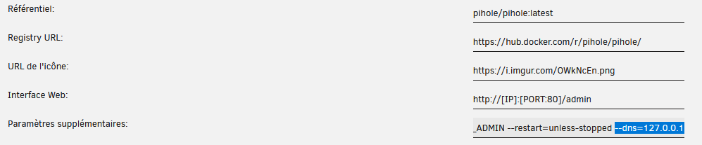

On 9/30/2023 at 11:52 PM, digital_billy said:
hi guys sorry for the newb question i have Pihole installed and its working but when i try to do gravity update i get a dns error... ive been searching but i cant seem to find a solution. must be a simple setting i am missing.
i followed the guide by spaceinvader 1 on youtube but video is already  kinda outdated.
On 7/23/2023 at 2:15 AM, nothus said:
I thought that was an issue too, but it's Docker's network DNS.
On 7/20/2023 at 3:40 AM, lucas.saraiva said:
Same problem , that problem on /etc/resolv.conf came back...
127.0.0.11 it's not a valid nameserver soo webui doesn't work
For those who have the problem of "DNS resolution is currently unavailable", i found a solution
Add --dns=127.0.0.1 on extra-settings (don't forget to activate advanced interface).

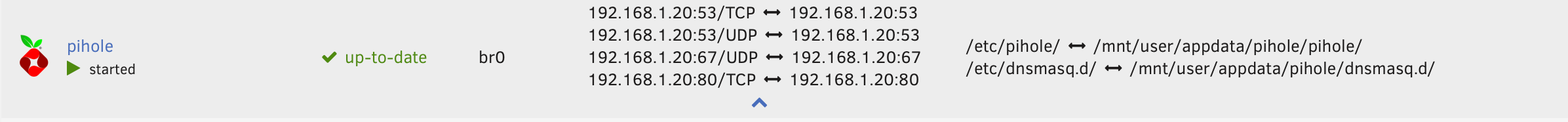

Having an issue deploying this templated container. I am choosing to provide a Fixed IP (192.168.1.20) and setting the ServerIP to this Unraid server (192.168.1.1).
This choice allows me to leave the required default ports. Otherwise, my other configs would block this, such as Nginx Proxy Manager for routing of multiple domain traffic.
When I run this container and set my laptop's DNS manually to 192.168.1.20, the Bitwarden Safari extension (pointing to the Vaultwarden container on the same Unraid) no longer functions. The Unraid UI seems to change the server-side IP address, as in the screenshot below. It starts initially with
192.168.1.20:53/TCP <--> 192.168.1.1:53
and repeated for all rows.
And my only fix is to restart all networking services (reboot is simpler!)
What am I doing wrong?
have you tried setting the serverIP variable to the PiHole server IP (192.168.1.20)?
Hi i have had pihole working for a long time, but i did do an update and it broke somehow.
I got the error "DNS resolution is not available" in the log and the blocking list stats is showing -2 in the dashboard.
The client resolution using pihole still works... any pointers? cant seem to find a solution that works
