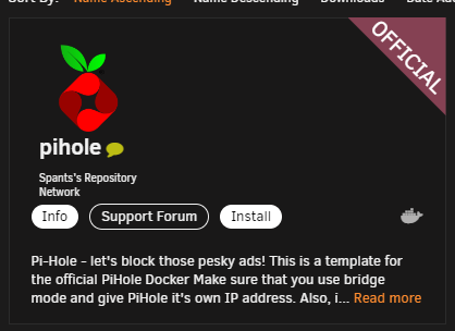

1 minute ago, Squid said:
Search for piHole
This gives me hits, but the one I have installed is missing, that is why am I wondering has the one I posted been pulled and replaced with the official one?

If you look the official one is Spants' one...
Maybe you had a super old/testing version? Should be able to migrate the data over anyway.

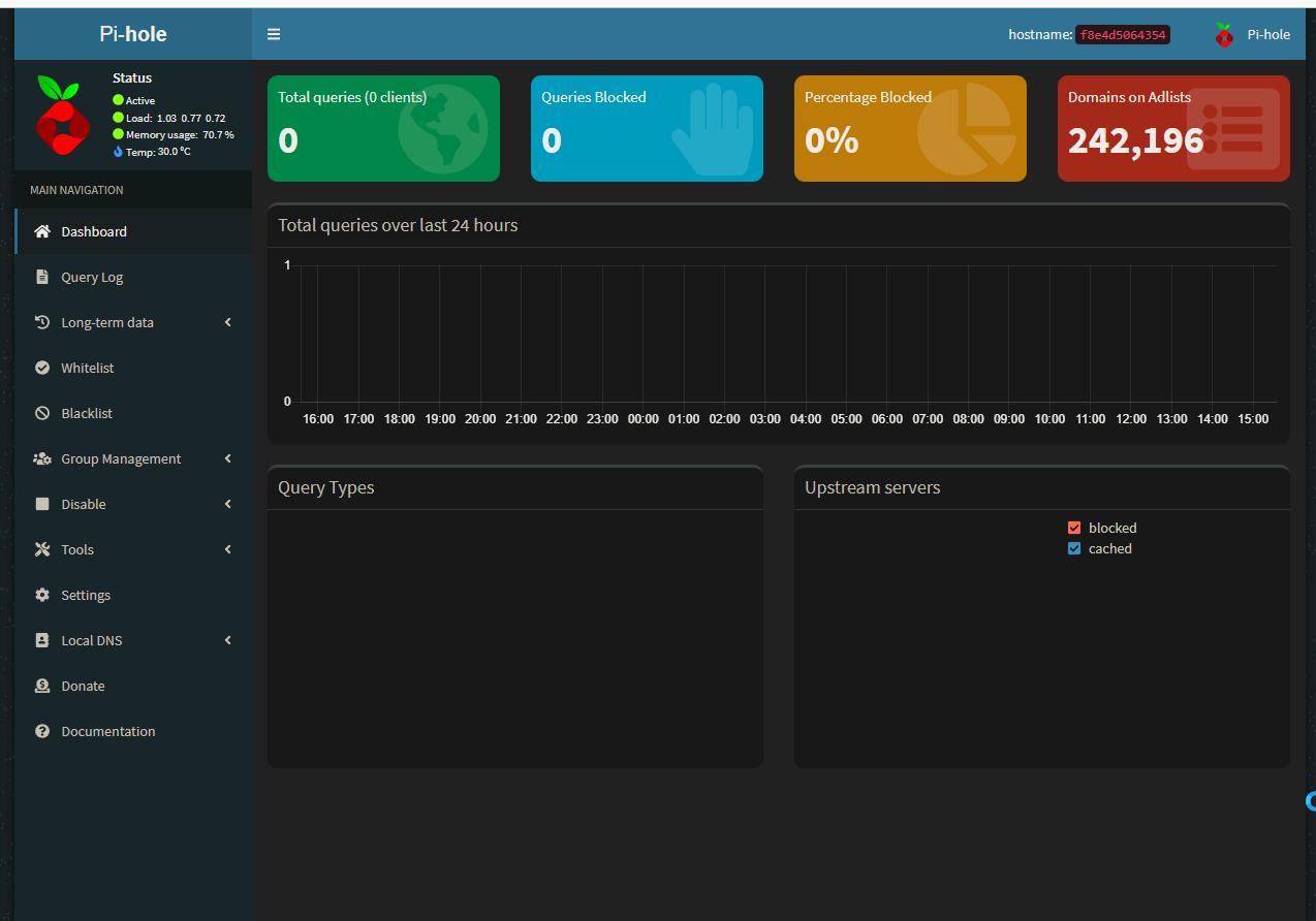

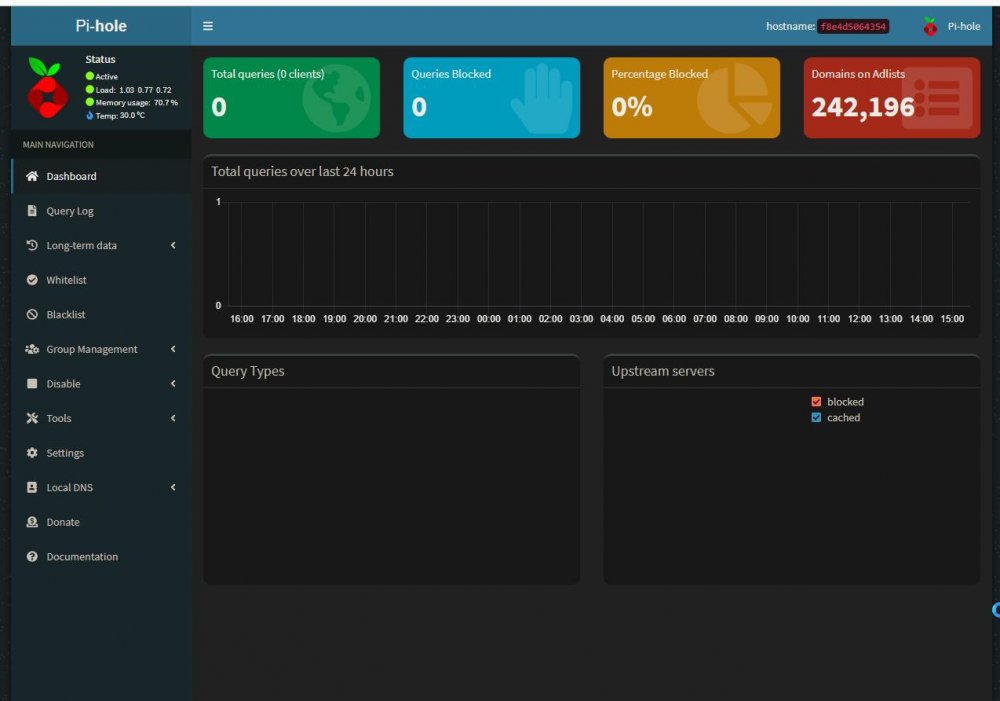

There is something wrong with piHole. The Webui just will open up at some random times or not at all. The update panel says "not available" for the past week(s). Today i did open but it won't take my password anymore. Any Ideas?
Edited by Sickdove

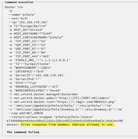

lately I have issues with this docker image. Everytime I restart my Server, the docker image doesn't restart. When I try starting it I get this error message:
I found the issue that when I try to restart this docker image with the static IP address I gave it before I restart my server, it now tells me that this IP is already in use, even though it is assigned to this docker container and no other docker container is using this address or port:
When I change the IP just by 1, everything works again until I need to restart the server again. Then I need to add again 1 to the end to the IP. I checked my router if it assigned the ip to any other devices but can confirm that 192.168.178.101 is only used by this docker container and nothing else. I even removed it from my router as I thought that the DHCP is causing the issue, but I don't think so.
Is there a possibility to check which IPs Unraid is already using for the custom network or even clear the IP Pool or something? As it is quite a hassle to always need to update the IP and change all the DNS settings.
