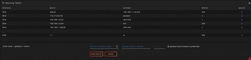

I managed to get it working using a custom Docker network (called "proxy"). My machine is at 192.168.5.100:
Care to share your networking settings in unraid too?
