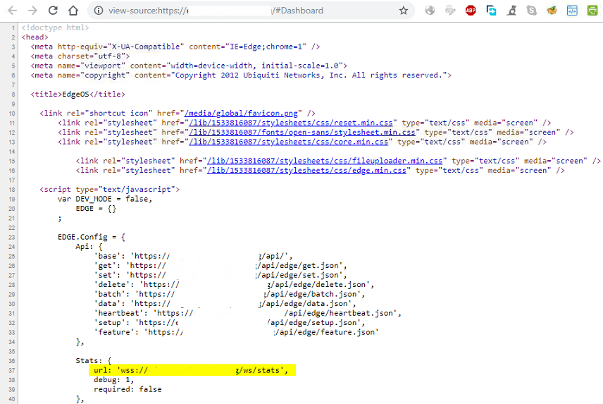

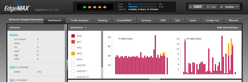

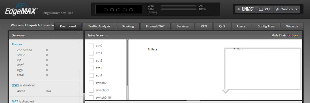

Anyone can help me with configuration websockets (wss:// ) over reverse proxy?
I have a EdgeRouterX and I have created the following configuration in linuxserver/letsencrypt docker container:
#Ubiquiti EdgeRouter-X Reverse Proxy
server {
	listen 80;
	server_name edgex.*;
	rewrite ^ https://$host$request_uri? permanent;
server {
    listen 443 ssl;
    include /config/nginx/ssl.conf;
    client_max_body_size 0;
    location / {
        include /config/nginx/proxy.conf;
        resolver 127.0.0.11 valid=30s;
        set $upstream_edgex 192.168.0.10;
        proxy_pass https://$upstream_edgex;
        proxy_set_header Range $http_range;
        proxy_set_header If-Range $http_if_range;
        proxy_set_header Upgrade $http_upgrade;
        proxy_set_header Connection "upgrade";
		proxy_buffering off;
I can login into the GUI, but i do not see any graphs, interface status or CPU/RAM usage.
This is what I see from LAN:
479419297_Screenshot-20181002_133453-07274.thumb.png.68412fbdb272b6f3013df28d128fd128.png
This is what I see over NGINX reverse_proxy:
288631513_Screenshot-20181002_133718-07275.thumb.png.a07b3adda86cd2b6075a7d9069729226.png
In the source code of the page you can see that is using websockets (wss://) :
I could not found a working way to forward the wss as well, so any help would be appreciated.
Edited by FlorinB
Link to comment
server {
	listen 80;
server {
    listen 443 ssl;
    location / {
Check out the preset conf for unifi. I imagine you need something similar

EdgeRouterX working GUI behind NGINX Reverse Proxy.
In case there is anyone else interested into this I have found the solution.
Here my config:
#Source: https://community.ubnt.com/t5/EdgeRouter/Access-Edgemax-gui-via-nginx-reverse-proxy-websocket-problem/td-p/1544354
#Adapded by Florin Butoi for docker linuxserver/letsencrypt on 02 Oct 2018
server {
        listen 80;
        return 301 https://$host$request_uri;
upstream erl {
        server 192.168.22.11:443;
        keepalive 32;
server {
        listen 443 ssl http2;
		include /config/nginx/filterhosts.conf;
        client_max_body_size 512m;
        location / {
                proxy_pass https://erl;
                proxy_http_version 1.1;
                proxy_set_header Connection "Upgrade";
                proxy_set_header Host $host;
                proxy_set_header X-Real-IP $remote_addr;
                proxy_set_header X-Forward-For $proxy_add_x_forwarded_for;
#allow from this ip
allow 	212.122.123.124;
#temporary internet ip on my router
allow	178.112.221.111;
#deny all others
deny   	all;
Link to comment

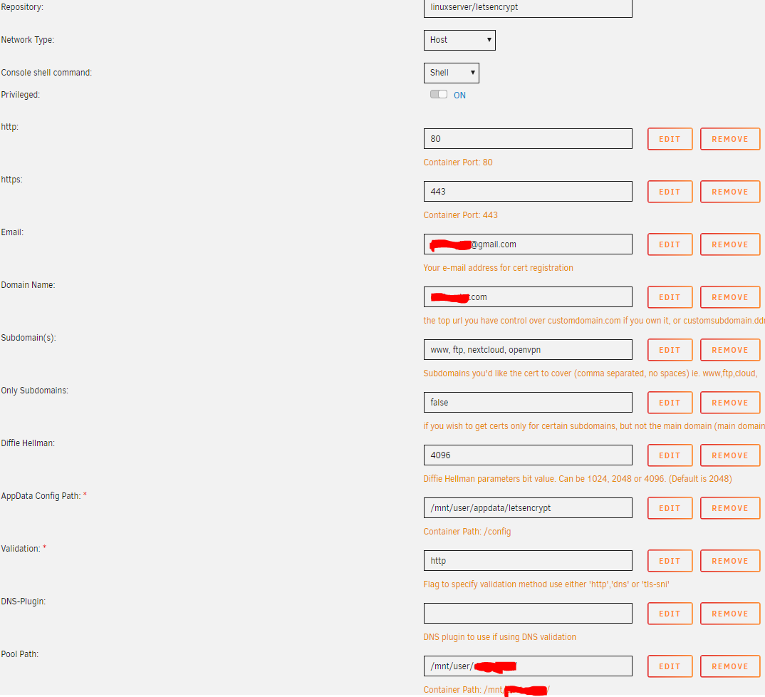

Hey, I've been trying to get letsencrypt up and runnning for a few weeks now with no success. I'm following spaceinvaderone's tutorial with the goal of setting up nextcloud and I'm stuck at requesting the certificate:
Domain: REDACTED.duckdns.org (
Type: connection
Detail: Fetching
http://REDACTED.duckdns.org/.well-known/acme-challenge/REDACTED
Timeout during connect (likely firewall problem)
To fix these errors, please make sure that your domain name was
entered correctly and the DNS A/AAAA record(s) for that domain
contain(s) the right IP address. Additionally, please check that
your computer has a publicly routable IP address and that no
firewalls are preventing the server from communicating with the
client. If you're using the webroot plugin, you should also verify
that you are serving files from the webroot path you provided.
ERROR: Cert does not exist! Please see the validation error above. The issue may be due to incorrect dns or port forwarding settings. Please fix your settings and recreate the container
My ports are forwarded correctly, I've double checked by accessing other containers from outside my network on port 80 & 443 and trying different ports (such as the 180 and 1443 recommended by spaceinvaderone). Letsencrypt just isn't receiving anything. One strange problem I've had which may be related is not being able to connect to unraids terminal from the unriad gui. I get the following error:
nginx upstream prematurely closed connection while reading response header from upstream
Any ideas?
EDIT:  SOLVED! I called my ISP, they had ports 80 & 443 blocked by default. They're unblocked now and it works!
Edited by enmesh-parisian-latest
SOLVED

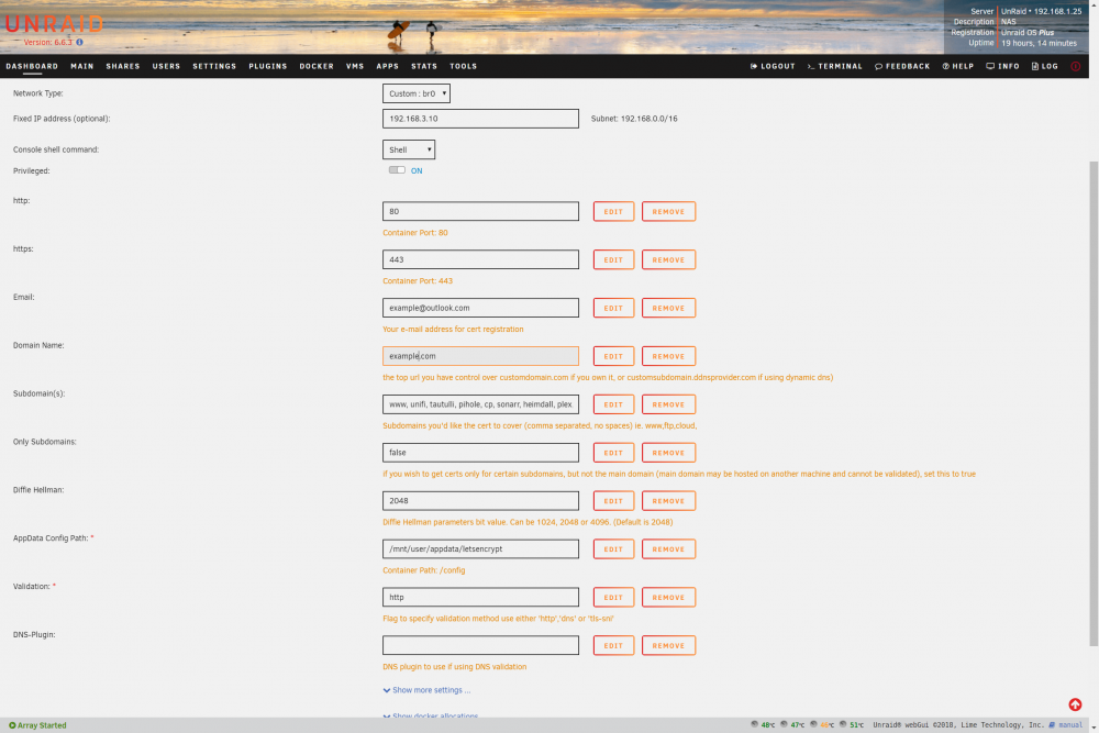

I've followed spaceinvaders tutorial on how to use letsencrypt with nginx.  When I try to access mydomain.duckdns.org on my own network, I get my routers homepage, if I do it using another network, I get the page I'm expecting.  I can access my dockers using their ip address, except nextcloud.  Thanks in advance for the help.
Link to comment

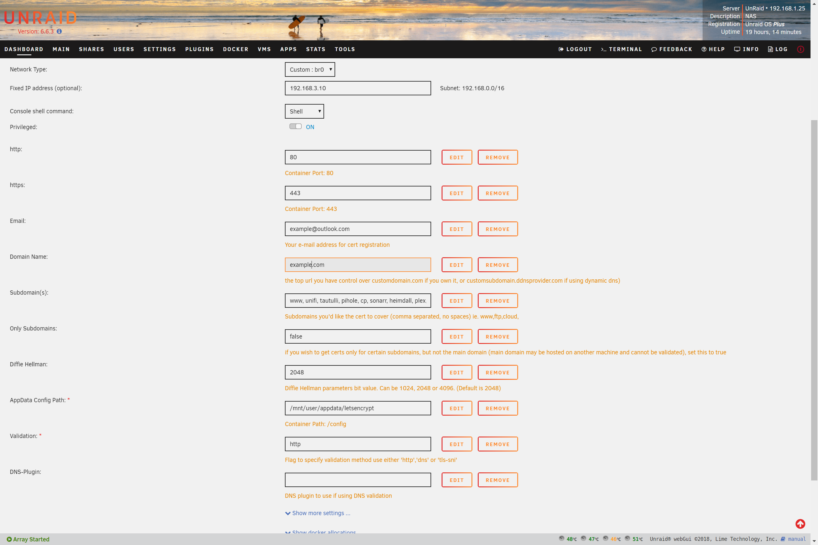

I'm getting a 404 on the /.well-known/acme-challenge, causing cert renewal to fail, and i can't seem to find it hunting through the files and folders in the container.
I have no idea where to look, and it only stopped working recently.
The container is running on it's own IP, 80 and 443 are forwarded from the router (I can still browse to the site as the cert is still valid, although only for another 5 or so days), and it's proxying a bunch of other containers, each with their own IP.
The / location is proxied to heimdall, is that possibly why certbot is retrieving a 404 for the acme-challenge?
I'll post any conf's needed for info, I just don't want to spam them all unnecessarily up front.
Thanks in advance.
Link to comment
Thanks in advance.
Post your container log and the container settings
Link to comment
Log:
_ ()
| | ___ _ __
| | / __| | | / \
| | \__ \ | | | () |
|_| |___/ |_| \__/
Brought to you by linuxserver.io
We gratefully accept donations at:
https://www.linuxserver.io/donate/
GID/UID
User uid: 99
User gid: 100
[cont-init.d] 10-adduser: exited 0.
[cont-init.d] 20-config: executing...
[cont-init.d] 20-config: exited 0.
[cont-init.d] 30-keygen: executing...
using keys found in /config/keys
[cont-init.d] 30-keygen: exited 0.
[cont-init.d] 50-config: executing...
Variables set:
PUID=99
PGID=100
TZ=Europe/London
URL=example.com
SUBDOMAINS=www, unifi, tautulli, pihole, cp, sonarr, heimdall, plex, calibre, ombi
EXTRA_DOMAINS=vpn.example.com
ONLY_SUBDOMAINS=false
DHLEVEL=2048
VALIDATION=http
DNSPLUGIN=
[email protected]
STAGING=
2048 bit DH parameters present
SUBDOMAINS entered, processing
Sub-domains processed are: -d www.example.com -d unifi.example.com -d tautulli.example.com -d pihole.example.com -d cp.example.com -d sonarr.example.com -d heimdall.example.com -d plex.example.com -d calibre.example.com -d ombi.example.com
EXTRA_DOMAINS entered, processing
Extra domains processed are: -d vpn.example.com
E-mail address entered: [email protected]
http validation is selected
Certificate exists; parameters unchanged; attempting renewal
cronjob running on Thu Oct 25 08:50:56 BST 2018
Running certbot renew
Saving debug log to /var/log/letsencrypt/letsencrypt.log
Processing /etc/letsencrypt/renewal/example.com.conf
Cert is due for renewal, auto-renewing...
Plugins selected: Authenticator standalone, Installer None
Running pre-hook command: if ps aux | grep [n]ginx: > /dev/null; then s6-svc -d /var/run/s6/services/nginx; fi
Renewing an existing certificate
Performing the following challenges:
http-01 challenge for calibre.example.com
http-01 challenge for cp.example.com
http-01 challenge for heimdall.example.com
http-01 challenge for ombi.example.com
http-01 challenge for pihole.example.com
http-01 challenge for plex.example.com
http-01 challenge for sonarr.example.com
http-01 challenge for tautulli.example.com
http-01 challenge for unifi.example.com
http-01 challenge for vpn.example.com
http-01 challenge for www.example.com
http-01 challenge for example.com
Waiting for verification...
Cleaning up challenges
Attempting to renew cert (example.com) from /etc/letsencrypt/renewal/example.com.conf produced an unexpected error: Failed authorization procedure. example.com (http-01): urn:ietf:params:acme:error:unauthorized :: The client lacks sufficient authorization :: Invalid response from http://example.com/.well-known/acme-challenge/xxxxxxxxxxxxxxxxxxxxxxxxxxxxxxxxxxxxxxxxxxxxx [88.98.197.66]: 404. Skipping.
All renewal attempts failed. The following certs could not be renewed:
/etc/letsencrypt/live/example.com/fullchain.pem (failure)
Running post-hook command: if ps aux | grep 's6-supervise nginx' | grep -v grep > /dev/null; then s6-svc -u /var/run/s6/services/nginx; fi; cd /config/keys/letsencrypt && openssl pkcs12 -export -out privkey.pfx -inkey privkey.pem -in cert.pem -certfile chain.pem -passout pass: && cat {privkey,fullchain}.pem > priv-fullchain-bundle.pem
Hook command "if ps aux | grep 's6-supervise nginx' | grep -v grep > /dev/null; then s6-svc -u /var/run/s6/services/nginx; fi; cd /config/keys/letsencrypt && openssl pkcs12 -export -out privkey.pfx -inkey privkey.pem -in cert.pem -certfile chain.pem -passout pass: && cat {privkey,fullchain}.pem > priv-fullchain-bundle.pem" returned error code 1
Error output from if:
cat: {privkey,fullchain}.pem: No such file or directory
1 renew failure(s), 0 parse failure(s)
IMPORTANT NOTES:
- The following errors were reported by the server:
Domain: example.com
Type: unauthorized
Detail: Invalid response from
[1.1.1.1]: 404
[cont-init.d] 50-config: exited 0.
[cont-init.d] done.
[services.d] done.
Server ready
and container settings:
Edited by YouAreTheOneNeo
Typo
