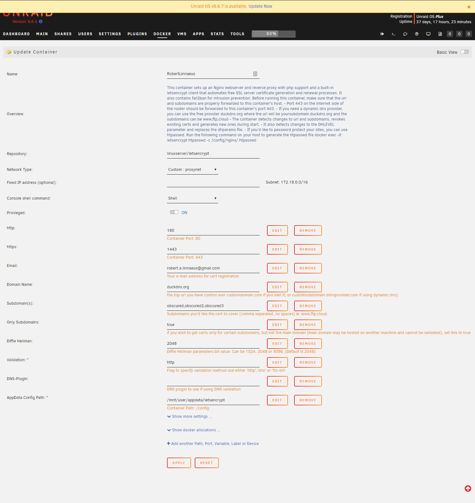

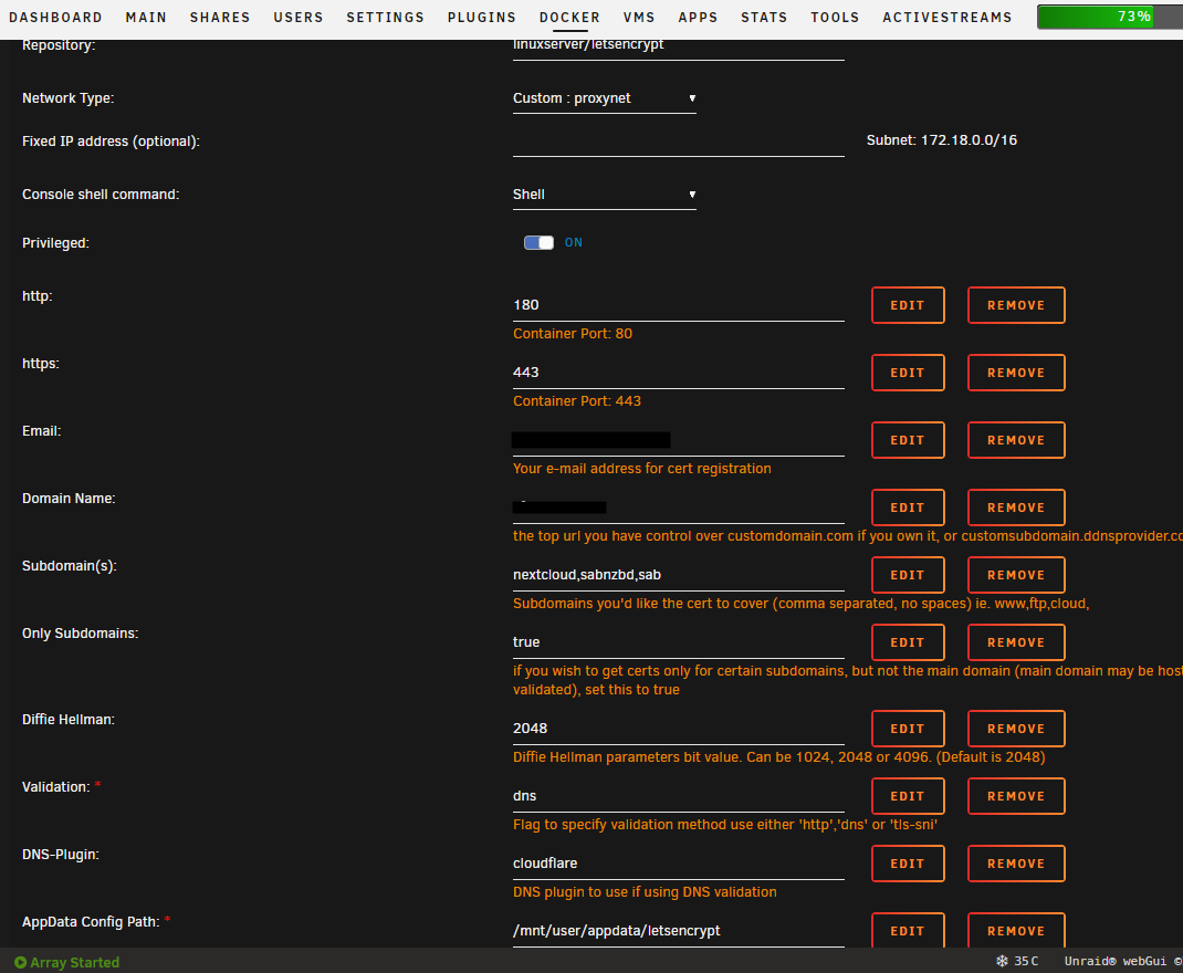

Hi all,
Having an odd issue at container startup "Can't open privkey.pem for reading, No such file or directory".  However, the keys are saved in the folder specified and the privileges for the files should allow letsencrypt to access them (even tried 777). Any help would be appreciated.
- Congratulations! Your certificate and chain have been saved at:
/etc/letsencrypt/live/XXXXXXX.duckdns.org-0001/fullchain.pem
Your key file has been saved at:
/etc/letsencrypt/live/XXXXXXX.duckdns.org-0001/privkey.pem
Your cert will expire on 2019-06-05. To obtain a new or tweaked
version of this certificate in the future, simply run certbot
again. To non-interactively renew *all* of your certificates, run
"certbot renew"
- If you like Certbot, please consider supporting our work by:
Donating to ISRG / Let's Encrypt: https://letsencrypt.org/donate
Donating to EFF: https://eff.org/donate-le
22760616274792:error:02001002:system library:fopen:No such file or directory:crypto/bio/bss_file.c:72:fopen('privkey.pem','r')
22760616274792:error:2006D080:BIO routines:BIO_new_file:no such file:crypto/bio/bss_file.c:79:
unable to load private key
cat: privkey.pem: No such file or directory
cat: fullchain.pem: No such file or directory
New certificate generated; starting nginx
[cont-init.d] 50-config: exited 0.
[cont-init.d] done.
[cont-init.d] done.
[services.d] done.
Server ready
Edit:
After fiddling a bit the problem  continues and now I cannot get new certs.
Plugins selected: Authenticator standalone, Installer None
Renewing an existing certificate
An unexpected error occurred:
There were too many requests of a given type :: Error finalizing order :: too many certificates already issued for exact set of domains: XXXXXXX.duckdns.org,linnio.duckdns.org,lserv.duckdns.org: see https://letsencrypt.org/docs/rate-limits/
Please see the logfiles in /var/log/letsencrypt for more details.
23291569253224:error:02001002:system library:fopen:No such file or directory:crypto/bio/bss_file.c:72:fopen('privkey.pem','r')
23291569253224:error:2006D080:BIO routines:BIO_new_file:no such file:crypto/bio/bss_file.c:79:
[cont-init.d] done.
nginx: [emerg] BIO_new_file("/config/keys/letsencrypt/fullchain.pem") failed (SSL: error:02001002:system library:fopen:No such file or directory:fopen('/config/keys/letsencrypt/fullchain.pem','r') error:2006D080:BIO routines:BIO_new_file:no such file)
[services.d] done.
Server ready
Server ready
Edited by cablecutter
8 hours ago, cablecutter said:
Hi all,
"certbot renew"
[cont-init.d] done.
[cont-init.d] done.
[services.d] done.
Server ready
Edit:
[cont-init.d] done.
[services.d] done.
Server ready
Server ready
Post your container settings
2048 bit DH parameters present
SUBDOMAINS entered, processing
Only subdomains, no URL in cert
Sub-domains processed are: -d XXXXXX.duckdns.org -d XXXXXXX.duckdns.org -d XXXXXXXX.duckdns.org
E-mail address entered: [email protected]
http validation is selected
Generating new certificate
Saving debug log to /var/log/letsencrypt/letsencrypt.log
Obtaining a new certificate
There were too many requests of a given type :: Error creating new order :: too many certificates already issued for exact set of domains: linnaeus.duckdns.org,linnio.duckdns.org,lserv.duckdns.org: see https://letsencrypt.org/docs/rate-limits/
ERROR: Cert does not exist! Please see the validation error above. The issue may be due to incorrect dns or port forwarding settings. Please fix your settings and recreate the container
You've hit the request limit:
Need to wait for that to reset which I believe is 7 days.

It seems when you messed with the permissions, you prevented the container from properly deleting the certs folder and when it regenerated certs, it created a duplicate folder with a 0001 appended to the name. Start over, don't change any permissions.
Also a side note, duckdns shouldn't really be the url variable. Url should be yoursubdomain.duckdns.org and subdomains should be any sub-subdomains you would like to use ie. "sonarr" so you can access sonarr.yoursubdomain.duckdns.org
If you need to add additional duckdns subdomains (usually needed for servers with different IPs, although I doubt that's the case here since they all need to point to the same letsencrypt instance), put them in the extra domains.
Edited by aptalca
Thanks aptalca, I deleted the folder and started from scratch, but won't be able to test this again until the cert request count resets.
If you change the set, you'll be able to get a cert because your current restriction is "for the exact set of domains". I recommend starting with one duckdns subdomain as the url and see what happens. You can then expand if you need to

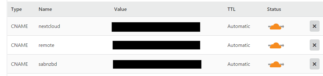

OK, I REALLY need help!!!
I'm exhausted trying to make this work (Letsencrypt and NGINX)

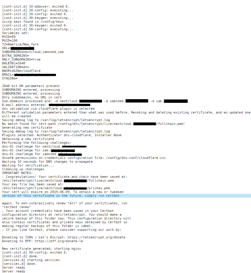

After A LOT of time trying to get my certificates to validate, I finally contacted my ISP who confirmed they are blocking port 80...
So I got my domain name to CloudFlare and change the validation to that so FINALLY, I was able to get Letsencrypt get the certificates.

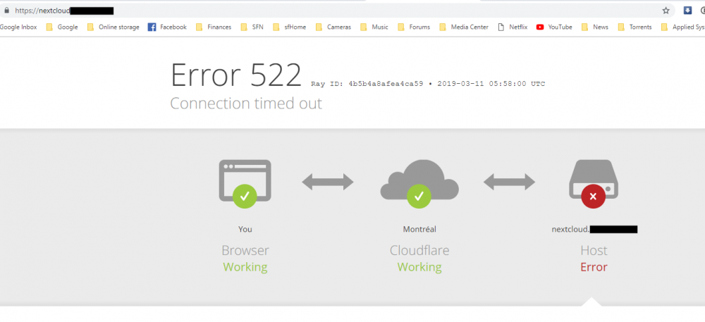

So now, my problem is nginx, I just can't get the HTTPS url to work. (trying first with nextcloud and SABNZBD)
I read a lot of tutorials, etc... and pretty sure I got everything right...

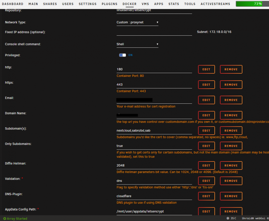

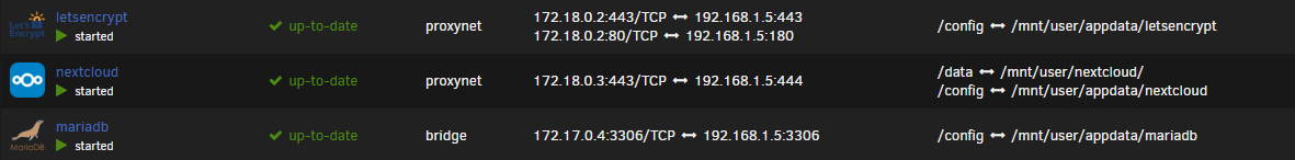

Here is my letsencrypt docker settings:
-CNAME created
-I can ping the subdomains
-Did the custom network for the dockers and assigned letsencrypt, nextcloud and SABNZBD to it

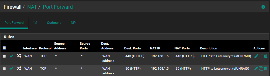

-Did my NAT config in my PFSENSE to open 443 (to 443 since that's what i'm using in the docker (UNRAID is using another port than 80 also)
I confirmed port 443 is opened when Letsencrypt is running so the port is opened:
Renamed the file in /appdata/letsencrypt/nginx/proxy-confs (the one for nextcloud subdomain and sabnzbd for subdomain)
861926920_2019-03-1101_42_38-proxy-confs-sfUNRAID-WinSCP.png.eaada094503796edfbf0fb8a90365e80.png
Edited the config.php in /appdata/nextcloud/www/nextcloud (change my actual domain name for "mydomain.ca")
<?php
$CONFIG = array (
  'memcache.local' => '\\OC\\Memcache\\APCu',
  'datadirectory' => '/data',
  'instanceid' => 'oceazvkmg45k',
  'passwordsalt' => 'EaiIqWmh7ARTfOGMcQPjIlPy/ZXcmL',
  'secret' => 'UfTMrKdIb3ZmO/CNaFUgZSz2ygB91jt8M4JcyJ5aizsHxGWe',
  'trusted_domains' =>
  array (
    0 => '192.168.1.5:444',
    1 => 'nextcloud.mydomain.ca',
  'trusted_proxies' => ['letsencrypt'],
  'overwrite.cli.url' => 'https://nextcloud.mydomain.ca/',
  'overwritehost' => 'nextcloud.mydomain.ca',
  'overwriteprotocol' => 'https',
  'dbtype' => 'mysql',
  'version' => '15.0.2.0',
  'dbname' => 'nextcloud',
  'dbhost' => '192.168.1.5:3306',
  'dbport' => '',
  'dbtableprefix' => 'oc_',
  'mysql.utf8mb4' => true,
  'dbuser' => 'nextcloud',
  'dbpassword' => 'sf-Pass',
  'installed' => true,

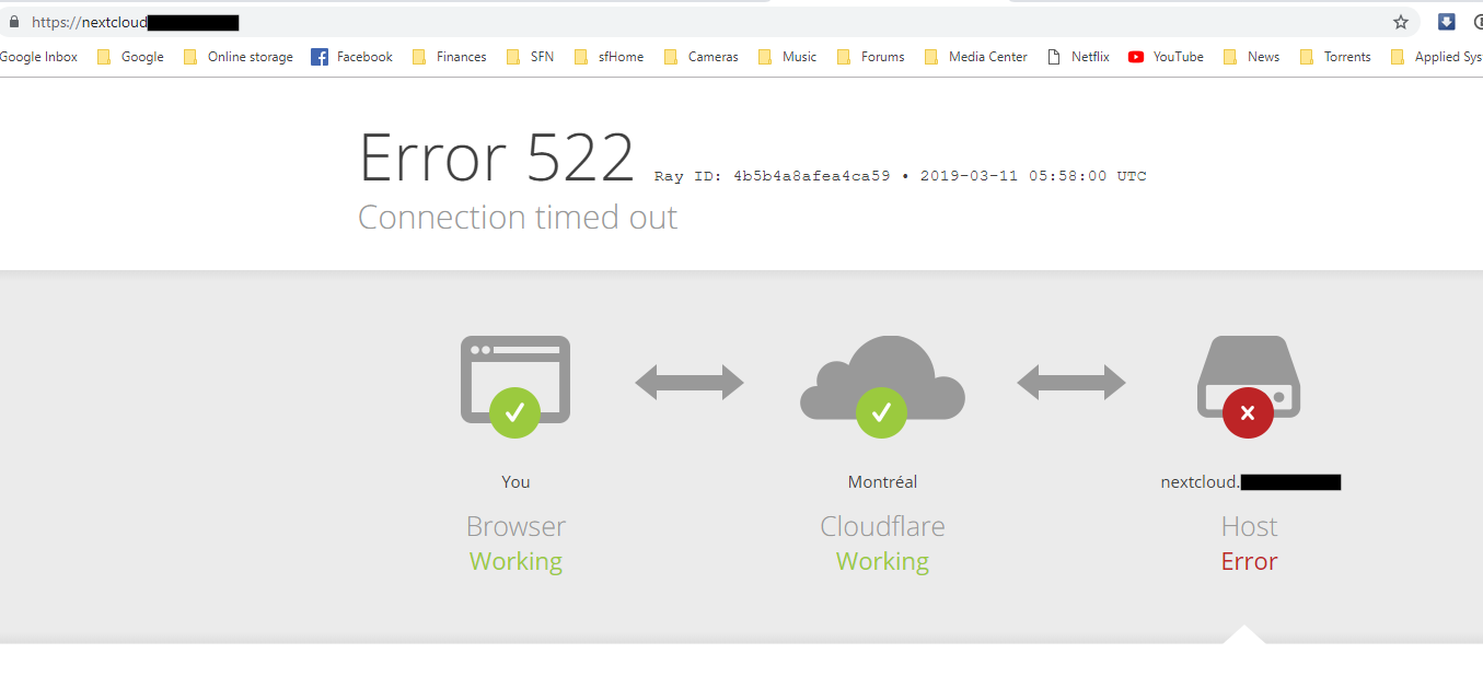

Restarted all dockers multiple times but still cannot access using https://nextcloud.mydomain.ca
Please help, I'm out of idea (and patience lol)
***I'm on RC version 6.7.0 RC5, god I hope that is not why it's not working...
Edited by sfnetwork
