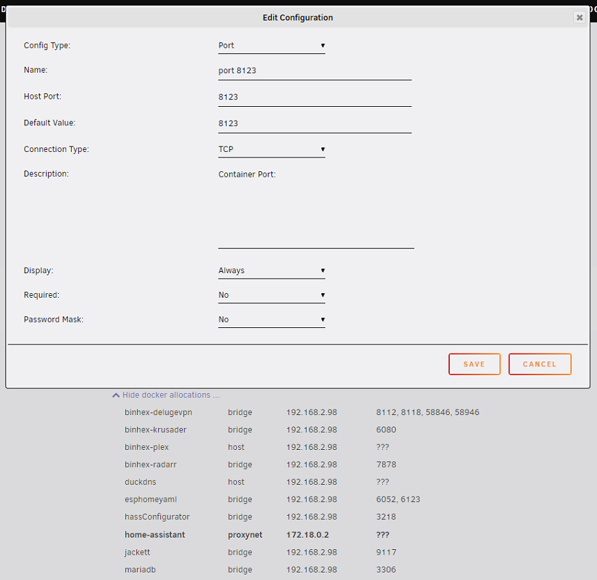

Yes! But it's not working...
I forget the choices for connection type.. Is there TCP and rdp?
Does the container start with that port? Something else may be using it. I dont see it in your screenshot though so it's probably not that...
Sent from my SM-G930W8 using Tapatalk
I just tried installing the container and it is configured as host network. It may not like the bridge config.
Can you try changing network type to host in the container config?
Nging won't reach it after that but we can fix it later
Yes, this is working. (inside)
But, I confirm this is not working with Nginx. (outside)
Tks!
Also, I was able to connect my Node Red with Home assistant.
Now I need to connect from the outside to HA...
In nginx config, change proxy pass to the url you use internally to reach HA
WooHoo!!! it's working! Thank you so mush! I learn a lot today.

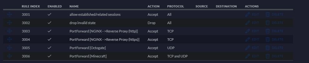

I'm trying to setup Let's Encrypt along side Bitwarden... I have it to the point where I can go to my DDNS.Net domain/address and I get the Let's Encrypt "Welcome page".
I have my router setup.. I think.. it's an ASUS - external Port 443, internal port 1443 Tower IP.. and External Port 80, Internal 180 Tower IP.. I have tweaked the bitwarden.subdomain.conf file and I can't get it to through to the Bitwarden.  Any ideas?  I did setup the Proxynet network (followed spaceinvaders video).

I ended up getting it to work... I had to have the Bitwarden docker on BRIDGE, and I tweaked the config file.. Works externally to use my ddns domain and internally via IP.

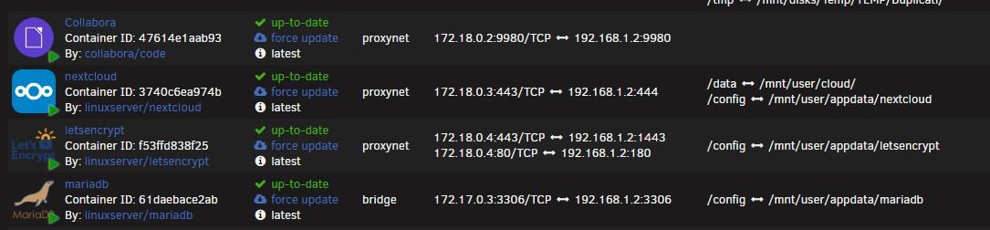

Hello everybody,
Before I come with my next problem, I wanted to thank you first for your commitment. I read a lot here, so I could solve a lot of problems or avoid them right away and find this community great.
Unfortunately, pure reading does not help me with the following problem. After reporting a problem with port forwarding in another thread a few days ago (downgrading the firmware and the controller solved the problem by the way), I now have a problem with Letsencrypt and Nextcloud.
The two Docker container I have set up after the very good video instructions from Spaceinvader and ran until a few days ago without problems. Now that I've fixed the port forwarding issues yesterday, the cloud can be recovered from outside and doing what it should. However, it is no longer possible to access the cloud via the local network.
Here I suspect the reverse proxy of Letsencrypt because the requests from the WAN as well as from the LAN arrive at the container, but this does not forward the requests from the LAN to Nextcloud.
I have already re-installed the Letsencrypt Docker and the new certification of the subdomains ran without problems. Also, the configs have been checked and recreated several times, but can find no error.
So now I need your help, hoping that you have an idea or even a solution to that.
My router has a static IPv4 at my ISP. Hairpinning - NAT loopback is enabled. Via NSlookup I land on both the WAN and LAN at the right address.
Below my settings and configs.
greetings
Gorosch
