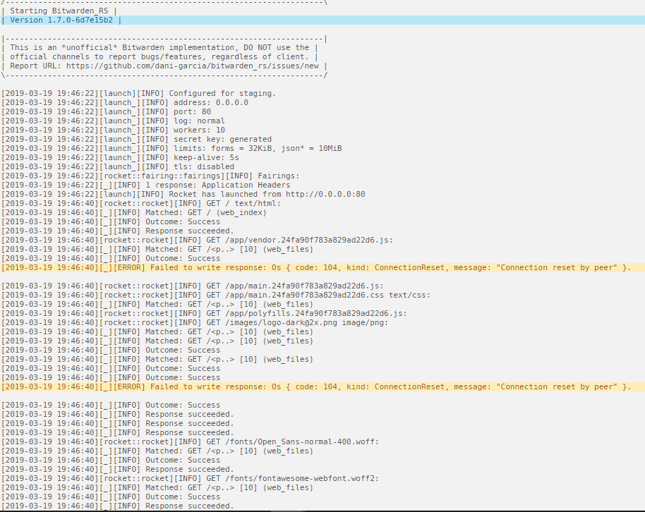

        include /config/nginx/proxy.conf;
        resolver 127.0.0.11 valid=30s;
        set $upstream_bitwarden bitwarden;
        proxy_pass http://$upstream_bitwarden:80;
        proxy_set_header Host $host;
#       proxy_ssl_server_name on;
        proxy_set_header X-Real-IP $remote_addr;
        proxy_set_header X-Forwarded-For $proxy_add_x_forwarded_for;
        proxy_set_header X-Forwarded-Proto $scheme;
#       proxy_headers_hash_bucket_size 512;
#   location /notifications/hub {
#       proxy_pass http://10.10.20.50:3012;
#       proxy_set_header Upgrade $http_upgrade;
#       proxy_set_header Connection "upgrade";
#   location /notifications/hub/negotiate {
#       proxy_pass http://10.10.20.50:8343;

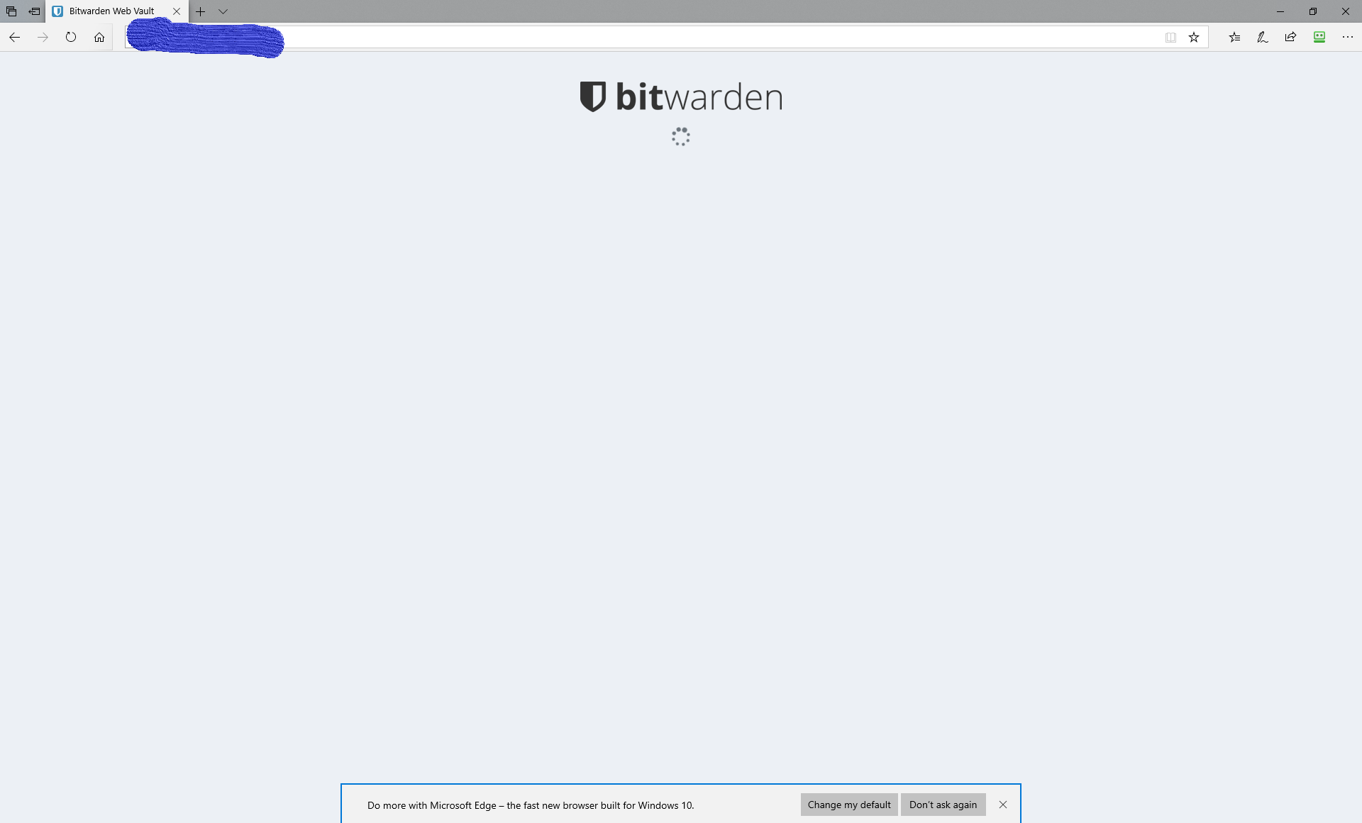

Can someone please help. I cannot get pass the loading page from my web browser using reverse proxy. Logging in via webUI and connecting with my bitwarden on my phone works correctly.
I notice a error in log file whenever I try access my bw subdomain
Edited by bulletjie
