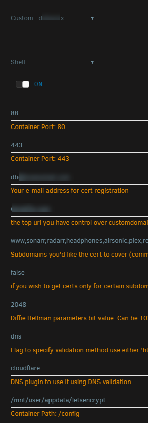

ok, so here it goes.
I am familiar with setting up webservers with nginx. Have been using cloudflare for a while for work and other sites. But this is kicking my ass.
I followed all the steps, yet I can't get around the 521 522 error. (I deleted the port fwd for 80 and now i get 522 instead of 521.) No logs generated.
image.png.eb58c7ea889012c7f54e273a47fdda1c.pngimage.thumb.png.493bb4394714a3e633d95b06cb259853.png
Link to post
Got any logs from container setup? Otherwise impossible to say what's going on.
Sent from my Mi A1 using Tapatalk
Link to post
Didn't look like that was the setup log. Just start up log. Or are they one in  the same?
Here is that...
https://www.hastebin.com/hakafawemu.cs
Well Nginx is starting up fine so it must be an issue with whatever you're trying to configure.
But I'm still not clear what the issue you're having is....
Are you getting errors on a fresh pull, with fresh appdata and before you edit any site configs?
Or are you editing your site configs then getting an error?
Link to post
22 minutes ago, dbinott said:
right now it's ERR_CONNECTION_REFUSED. host resolves. 443 is fwd'd.
Just trying to configure it to get the default index right now. Deal with other stuff after that is dealt with.
Not sure what I did, but it's working now. 👍
Is there a way to get to it inside the network? Nevermind.
Edited by dbinott
Link to post
