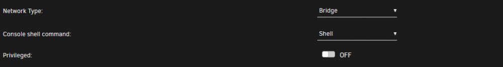

Do you mean br0? That's macvlan, not bridge, and it blocks connections between host and the containers on it. But I'm making assumptions because you are not providing enough info to understand the situation.
this works:
This not:

4 hours ago, Abigel said:
this works:
This not:
The address is in the right network and the address is also still free
That's macvlan and it blocks the connection between the host and the container
And how can i give the docker container a diffrent IP-Address ?
With macvlan but it blocks the connection between the host and the container.
Why do you need to give it a different IP?
I think for Security
Ironically, macvlan blocks host connections for security as well
