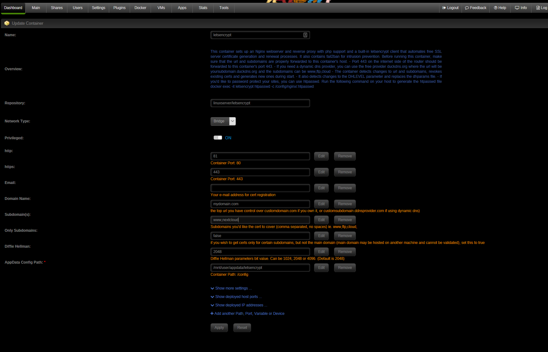

im still trying, im about 10hrs invested and i cant get it to work :/
I am starting from scratch, removed each dockers and doing each step, id be gratful for guidance
1. install lets encrypt docker
2. register namecheap domain and point back to my static IP address
3. ping domain name and i get a ping back from my static IP address
4. I try to start lets encrypt docker and i get Error (port 443 in use)

Are you running unraid 6.4? If you are, you need to change port 443 to something else. You also need to change the port forward on your ISP router to match the new port.
Alternatively (if you are on 6.4) the network type can be changed to br0 and the container can get its own IP address. This allows to keep using port 443, but still needs a change on the router and set forwarding to the new IP address of the container.
Edited by bonienl
im on 6.4 rb17
I hve changed port to 444
I got this response

When you change ports, only change the host mapped ports, not the internal container ones.
Then, in the nginx site config, you'll set it to listen on 80 and 443 still.
If you're confused, read the docker faq and pay attention to the port mapping info
I changed the container to br0, since I am on unraid 6.4, now I get a 502 Bad Gateway.
