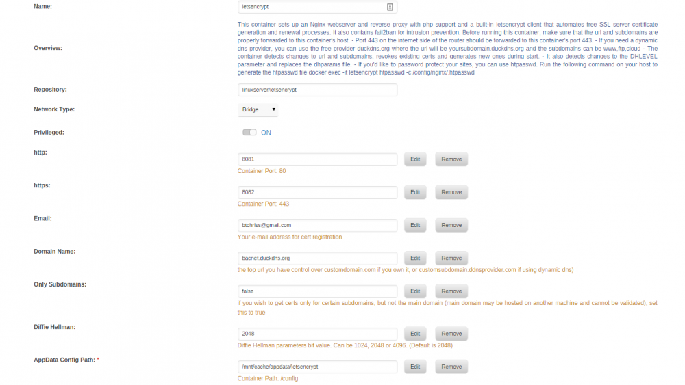

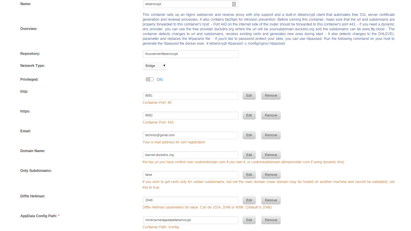

for the settings, duckdns.org should be the domain and bacnet should be in the subdomain?
to forward bacnet to unraid do I edit the duckdns docker?

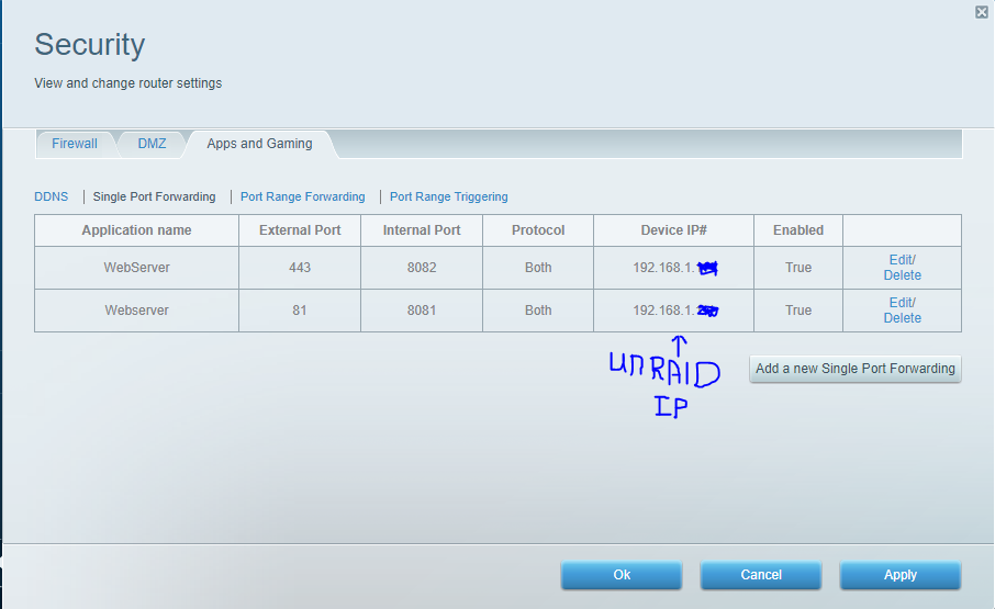

@sgt_spike
My duckdns docker has my subdomain listed under SUBDOMAINS (your's would be bacnet) and the token is from the duckdns webpage.
That is the only 2 edits I have ever made to duckdns docker.
Within the LE docker settings I have my host port set to 9443 and that forwards to 443 inside the container.
In my router, I have a port forward that forwards 443 WAN to <unRAID IP>:9443
So from the outside it looks like:
subdomain.duckdns.org:443 -> router forwards this to <unRAID IP>:9443 -> to inside LE docker 443
Hope this helps.

Seems like I get the same errors
[cont-init.d] 10-adduser: exited 0.
[cont-init.d] 20-config: executing...
[cont-init.d] 20-config: exited 0.
[cont-init.d] 30-keygen: executing...
using keys found in /config/keys
[cont-init.d] 30-keygen: exited 0.
[cont-init.d] 50-config: executing...
2048 bit DH parameters present
No subdomains defined
E-mail address entered: [email protected]
@sgt_spike oh! change that LE docker setting where it says "only subdomains" to "true". you only want to generate certs for bacnet
that should definitely help, if not you do have another issue about a missing variable.
hmm your settings look different, mine has Email, Domain Name, subdomain(s), only subdomains
change Domain Name: "duckdns.org" (without quotes)
click the button at the bottom that says "Add another Path, Port, Variable or Device"
Config type: Variable
Key: SUBDOMAINS
Value: bacnet
Description: Subdomains you'd like the cert to cover (comma separated, no spaces) ie www,ftp,cloud,
This should tell LE which certs to generate and not try to generate them for the duckdns main domain since you don't own that.
Key: SUBDOMAINS
Value: bacnet
Don't do that. That is incorrect
Don't do what?  What's incorrect?
@sgt_spike Did the above help?
No I got the same error message.  I feel like I have something missing.  I just don't know
Don't set only subdomains to true. Set the domain/url to bacnet.duckdns.org
Did you reboot the router after you set the port forward? Maybe you have to
Did as you suggest.  Got the same error.  I was looking around and opened to the "don'teditthisfile.conf" and noticed it never updateds when I changed the docker settings.  I removed the docker and re-installed it.
Do I need to supply a pw along with the email address in order to gain access to my duckdns.org account?

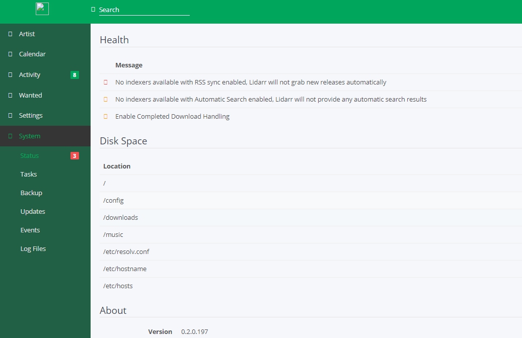

Is anyone using Lidarr?  It works, but the icons don't display:
# Lidarr
	location /lidarr {
		include /config/nginx/proxy.conf;
		proxy_pass http://172.32.12.69:8686/lidarr/;
# Lidarr
	location /lidarr {
This works for me.

Try and remove your trailing / on the proxy_pass line

8 hours ago, GilbN said:
This works for me.
	# LIDARR CONTAINER
	location ^~ /lidarr {
		#auth_request /auth-admin;
    	proxy_pass http://192.168.1.34:8686/lidarr;
    	proxy_set_header Host $host;
    	proxy_set_header X-Real-IP $remote_addr;
    	proxy_set_header X-Forwarded-For $proxy_add_x_forwarded_for;
Thank you - that did the trick.  Out of interest, what do your extra lines do?

Ive changed this many times.
When I run my sub domain from my webbrowser it takes me to my router page that gives me pfsense error screen (which is my router)
I have port 443 forwarding to my Unraid ip.
