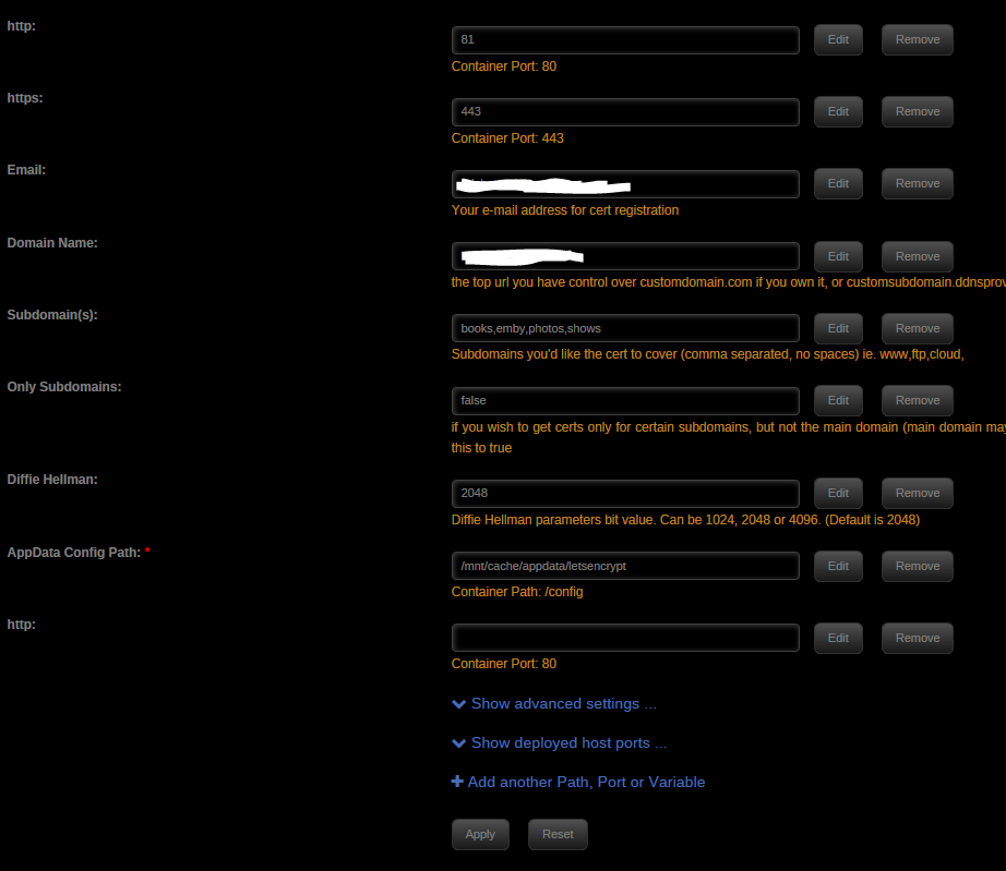

The container will start, but it doesn't seem to be redirecting to my emby container. i.e. I get "Unable to connect" when I point my browser at "emby.mydoinain.com". This was working a few days ago prior to the kerfuffle about the LE docker and was working fine while trying to get the Android emby app to connect through a secured RP.
I looked at the docker config:
and I seem to have an extra "http" variable down there at the bottom. I have no recollection if this is a default path or if I'd manually added it for some reason. I've reviewed the last 12-15 pages for issues I've posted and none of the resolutions seemed to indicate me adding this as an extra variable, so this really has be cornfoosed...
I'd like to get confirmation that this shouldn't be there before I go and delete it

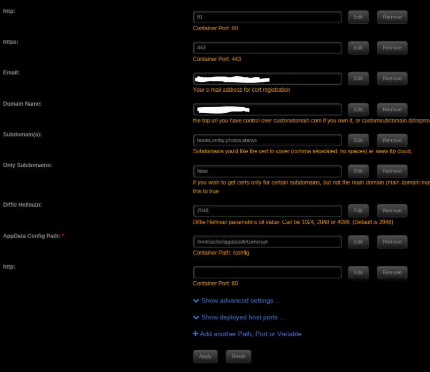

Here's mine to show you what I mean.....
2 minutes ago, CHBMB said:
What command are you running?
How do I check what command is run when the docker is updated/started?
The only difference I can see is that you have DHLEVEL set to 4096 whereas mine is set to 2048. I tried setting HTTPVAL to true and it still fails, albeit with a different error:
root@localhost:# /usr/local/emhttp/plugins/dynamix.docker.manager/scripts/docker run -d --name="letsencrypt" --net="bridge" --privileged="true" -e TZ="Europe/London" -e HOST_OS="unRAID" -e "EMAIL"="mine" -e "URL"="mine" -e "ONLY_SUBDOMAINS"="false" -e "DHLEVEL"="2048" -e "PUID"="99" -e "PGID"="100" -e "HTTPVAL"="false" -p 443:443/tcp -p 81:80/tcp -v "/mnt/cache/appdata/letsencrypt":"/config":rw linuxserver/letsencrypt

1 minute ago, CHBMB said:
And I have httpval set to true.
Yes sorry, I updated my post to reflect that. It fails whether set to true or false.
Have you got port 80 on your router/firewall forwarded to port 81 on your Unraid ip?
No, I tried port 80 but obviously that didn't work.
Well that's not surprising, port 80 is the Unraid webui port, try forwarding to port 81 which is what you've mapped port 80 IN the container to.
Awesome, that's now working!!!
Thanks ever so much for your help.

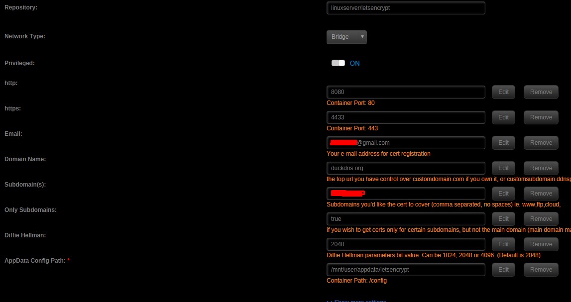

I've just upgrade my unRaid server from 6.3.4 (?) to 6.4.0 and since then my container letsencrypt isn't working as it used to.
I've reinstalled the container and I still can't find the solution to the problem with some googleing :(
The log:

The container config: Screenshot_1.jpg
Thank you!
