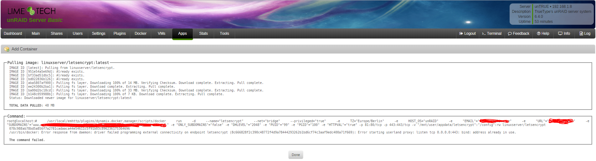

I get "Execution Error" which means I cannot even start the docker. I've updated to unraid 6.4.0, does it have something to do with it?
See below in box and/or screenshot. I've tried to change the 443 port to like 445 but same error then...
Command:
root@localhost:# /usr/local/emhttp/plugins/dynamix.docker.manager/scripts/docker run -d --name="letsencrypt" --net="bridge" --privileged="true" -e TZ="Europe/Berlin" -e HOST_OS="unRAID" -e "EMAIL"="*****@******.***" -e "URL"="********" -e "SUBDOMAINS"="www,*******," -e "ONLY_SUBDOMAINS"="false" -e "DHLEVEL"="2048" -e "PUID"="99" -e "PGID"="100" -e "HTTPVAL"="true" -p 81:80/tcp -p 443:443/tcp -v "/mnt/user/appdata/letsencrypt":"/config":rw linuxserver/letsencrypt
078c988ab78bd5a856f7a2781cadaaca44e54611c5f91b03c896236175364696
/usr/bin/docker: Error response from daemon: driver failed programming external connectivity on endpoint letsencrypt (8c666828f2c390c48772f4d9a78444293262b1bd6cf74c3aaf9edc400a71f669): Error starting userland proxy: listen tcp 0.0.0.0:443: bind: address already in use.
The command failed.

1 minute ago, truetype said:
I see the last update made it though for most of us... I've read about the last 5 pages and I seem to be the first with this issue "port already in use".
See below in box and/or screenshot. I've tried to change the 443 port to like 445 but same error then... I
Command:
The command failed.
Don't use 445 as it's used for something else. Don't ask me what, as I don't remember.
Change it to 4443 and check that it's not in use. Remember to also change the port forward in your router.
Edited by saarg
Dope..... Thanks, tried with 442 and now running at least! :)
3 minutes ago, truetype said:
-p 443:443/tcp
Try mapping the port to 444 or some other number. 6.4 runs the WebGUI on 443 now so you're trying to compete with the OS's main method of communicating with you. Don't forget to update your router's port-forwarding, too.

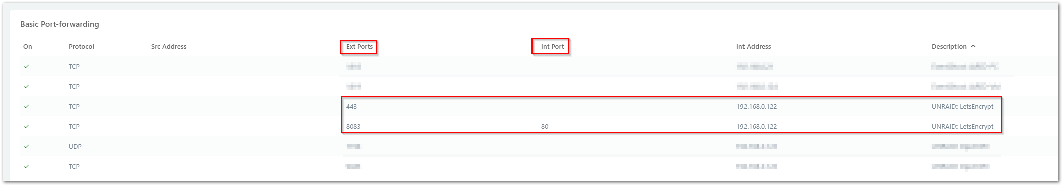

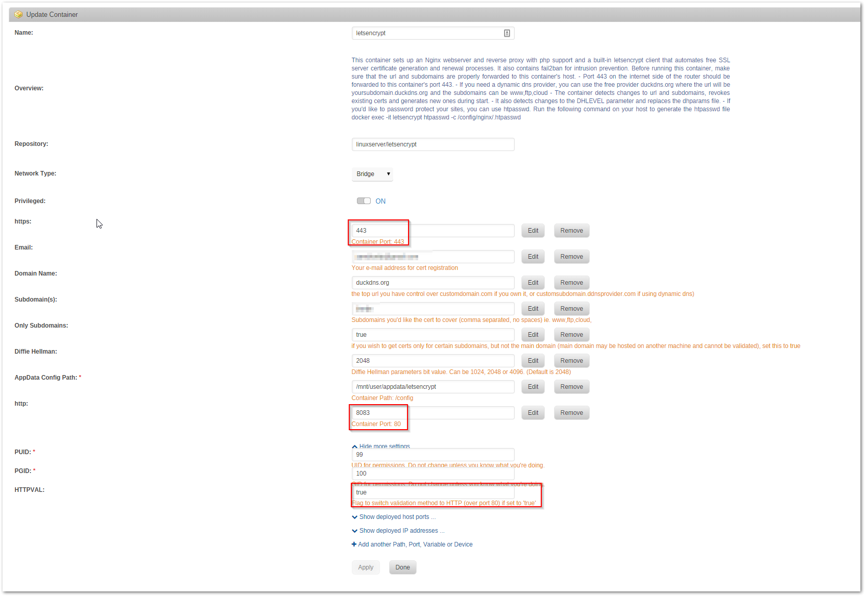

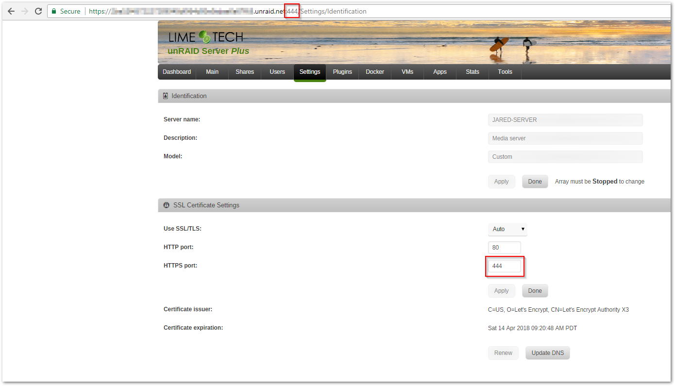

I'm really struggling with this as well guys.  Been doing all the required reading and browsing through everyone's comments without luck.  I've done the following:
  • Upgraded to 6.4.0 (was previously on 6.3.5 and it wasn't working then either)
  • Due to 6.4.0 upgrade, I changed the default SSL port for UNRAID to 444
  • Ensured HTTPVAL is set to true.
  • Removed and re-added http container port
  • Changed container http container port to 8083
  • Ensured port forwarding is working for port 8083 via telnet
What am I missing guys?  This shouldn't be this difficult...

@irandumi - it's hard to tell from your port-forward screen shot, but it looks like you're not forwarding 443 to your unRAID server, but you are forwarding 8083(?) to 80. Try adding the 443 forward to 192.168.0.122 (?).
(adjust the numbers as necessary - I'm squinting at a small, blurry screen shot and my eyes aren't quite as good as they used to be)
@irandumi
You don't control duckdns.org, so try using subdomain.duckdns.org in DOMAIN NAME, remove SUBDOMAIN from SUBDOMAINS and set ONLY SUBDOMAINS to false if @FreeMan's suggestion doesn't work.
Your router is set to forward EXTERNAL 8083 to INTERNAL 80. Swap that, so when LE talks to port 80 on your WAN, your router sends it to 8083 on unraid, which sends it back to the LE docker on 80.
You've got internal and external switched in your router.
3 minutes ago, CHBMB said:
@irandumi
Dang! missed that one.
and that one....
maybe I should go back to sleep. Sorry @irandumi...

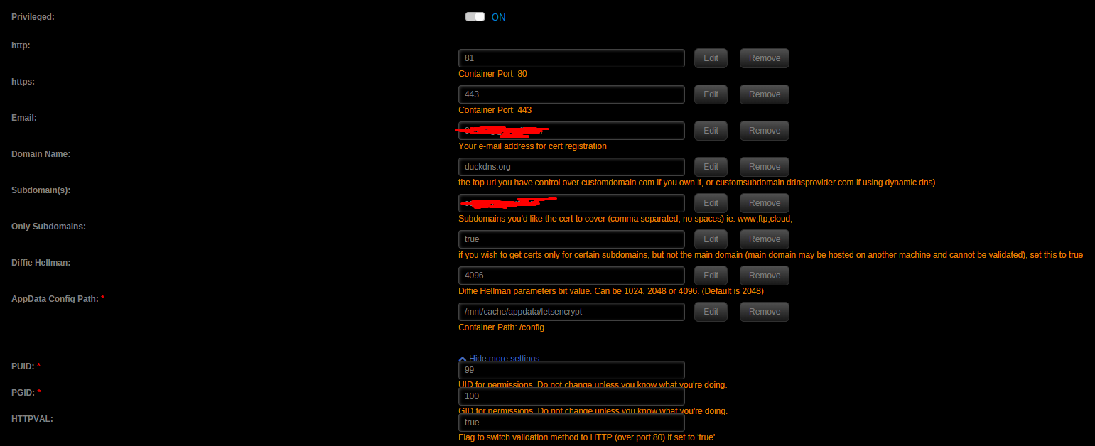

4 hours ago, upthetoon said:
Sorry to add to the list of people with probably obvious issues but I'm having trouble getting this working too.
I've been using it through the RC's and have unraid set to port 444 to avoid the clash.  It was working fine before the CA change.
I've followed the instructions above (thank you) and set the HTTPVAL flag to true.
I'm using port 81 for the docker and have port 80 fwd to 81 in my router.

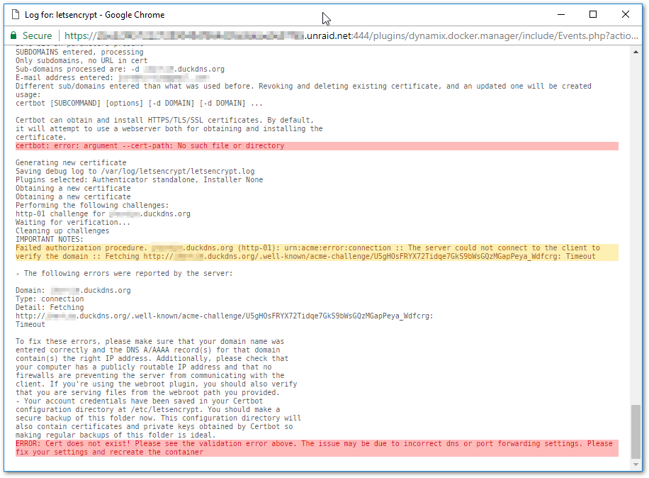

I'm getting this error which I can't see is happening for anyone else...
Failed authorization procedure. <redacted>.duckdns.org (http-01): urn:acme:error:connection :: The server could not connect to the client to verify the domain :: Fetching https://<redacted>.unraid.net:444/.well-known/acme-challenge/QaX0x01RBkOvVSiPIP5VlKlhGyQDYNZXTuanOrzQ-n0: Invalid port in redirect target. Only ports 80 and 443 are supported, not 444
Startup command;
root@localhost:# /usr/local/emhttp/plugins/dynamix.docker.manager/scripts/docker run -d --name="letsencrypt" --net="bridge" --privileged="true" -e TZ="Europe/London" -e HOST_OS="unRAID" -e "EMAIL"="<redacted>" -e "URL"="duckdns.org" -e "SUBDOMAINS"="<redacted>" -e "ONLY_SUBDOMAINS"="true" -e "DHLEVEL"="2048" -e "PUID"="99" -e "PGID"="100" -e "HTTPVAL"="true" -p 81:80/tcp -p 443:443/tcp -v "/mnt/user/appdata/letsencrypt":"/config":rw linuxserver/letsencrypt
This got lost in all the replies I think.
 error anyone?
443 is forwarded.  If there is no input for Int (Internal port), then it uses the same port (443).  Regardless, I added 443 just to be safe.  No luck.
10 minutes ago, CHBMB said:
@irandumi
As you suggested, I modified the DOMAIN NAME to include my subdomain,  I removed the SUBDOMAIN(S) variable, changed 'ONLY SUBDOMAINS' to 'false' and restarted the docker.  Same results.
I just did what you suggested and still no luck...
12 minutes ago, upthetoon said:
error anyone?
Follow irandumi's lead, and post screenshots showing  the docker, GUI and router configurations. What he posted allowed us to quickly and easily parse through and figure out what could be the issue.
