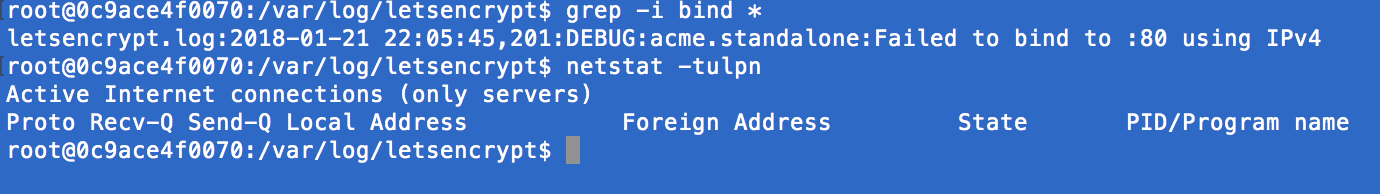

Ok,  for the life of me,  following as many different guides as I could so far,  I still can not get this to work.
I own a domain name and have my.domain.com set to forward to my IP.    I have setup LE and keep getting this error:
Failed authorization procedure. my.xxxxxx.com (http-01): urn:acme:error:unauthorized :: The client lacks sufficient authorization :: Invalid response from http://my.xxxxxx.com/.well-known/acme-challenge/1Eq0-WkG_ENPwv59yFCqtUfWQ2CqYo8F0-Bm4hXTheY: "<?xml version="1.0" encoding="iso-8859-1"?>
What causes this error?
Link to comment

Link to comment
Run Command:
root@localhost:# /usr/local/emhttp/plugins/dynamix.docker.manager/scripts/docker run -d --name="letsencrypt" --net="bridge" --privileged="true" -e TZ="America/Chicago" -e HOST_OS="unRAID" -e "EMAIL"="letsencrypt@fmp4m.com" -e "URL"=xxxxxx.com" -e "SUBDOMAINS"="my," -e "ONLY_SUBDOMAINS"="true" -e "DHLEVEL"="2048" -e "PUID"="99" -e "PGID"="100" -e "HTTPVAL"="true" -p 81:80/tcp -p 7443:443/tcp -v "/mnt/user/appdata/letsencrypt":"/config":rw linuxserver/letsencrypt
Firewall fwding:
lan-interface eth1
 rule 1 {
     description encrypt
     forward-to {
         address 192.168.1.175
         port 81
     original-port 80
     protocol tcp_udp
 rule 2 {
     description encrypt2
     forward-to {
         port 7443
     original-port 443
     protocol tcp_udp
Error:
Link to comment

You sure you got the correct WAN ip address allocated to your domain or dynamic DNS.
Link to comment
Yes,   I have forwarded from my subdomain.domain.com to my WAN ip.    I use this same setup different.domain.com with no issues.   If I went to http://sub.domain.com:anyport it will still resolve and is pingable.  Tracert shows it going to my machine.
Full Log (took a min to clean):
_ ()
| | ___ _ __
| | / __| | | / \
| | \__ \ | | | () |
|_| |___/ |_| \__/
Brought to you by linuxserver.io
We gratefully accept donations at:
https://www.linuxserver.io/donations/
GID/UID
User uid: 99
User gid: 100
[cont-init.d] 10-adduser: exited 0.
[cont-init.d] 20-config: executing...
[cont-init.d] 20-config: exited 0.
[cont-init.d] 30-keygen: executing...
using keys found in /config/keys
[cont-init.d] 30-keygen: exited 0.
[cont-init.d] 50-config: executing...
2048 bit DH parameters present
SUBDOMAINS entered, processing
Only subdomains, no URL in cert
Sub-domains processed are: -d my.xxxxxxx.com
E-mail address entered: letsencrypt@xxxxxxx.com
Different sub/domains entered than what was used before. Revoking and deleting existing certificate, and an updated one will be created
usage:
certbot [SUBCOMMAND] [options] [-d DOMAIN] [-d DOMAIN] ...
Certbot can obtain and install HTTPS/TLS/SSL certificates. By default,
it will attempt to use a webserver both for obtaining and installing the
certificate.
certbot: error: argument --cert-path: No such file or directory
Generating new certificate
Saving debug log to /var/log/letsencrypt/letsencrypt.log
Plugins selected: Authenticator standalone, Installer None
Obtaining a new certificate
Performing the following challenges:
http-01 challenge for my.xxxxxxx.com
Waiting for verification...
Cleaning up challenges
Failed authorization procedure. my.xxxxxxx.com (http-01): urn:acme:error:unauthorized :: The client lacks sufficient authorization :: Invalid response from http://my.xxxxxxx.com/.well-known/acme-challenge/dgTrPK7WHHxA87urYp9N1s12CdEYXcPhbZgOOsWEOag: "<?xml version="1.0" encoding="iso-8859-1"?>
<!DOCTYPE html PUBLIC "-//W3C//DTD XHTML 1.0 Transitional//EN"
"http://www."
IMPORTANT NOTES:
- The following errors were reported by the server:
Domain: my.xxxxxxx.com
Type: unauthorized
Detail: Invalid response from
"http://www."
To fix these errors, please make sure that your domain name was
entered correctly and the DNS A/AAAA record(s) for that domain
contain(s) the right IP address.
- Your account credentials have been saved in your Certbot
configuration directory at /etc/letsencrypt. You should make a
secure backup of this folder now. This configuration directory will
also contain certificates and private keys obtained by Certbot so
making regular backups of this folder is ideal.
ERROR: Cert does not exist! Please see the validation error above. The issue may be due to incorrect dns or port forwarding settings. Please fix your settings and recreate the container
[cont-finish.d] executing container finish scripts...
[cont-finish.d] done.
[s6-finish] syncing disks.
[s6-finish] sending all processes the TERM signal.
[s6-finish] sending all processes the KILL signal and exiting.
Helpful or Useless info:
Going to http://127.0.0.1:81/ does not open any page... nor https://127.0.0.1:7443/
Edited by fmp4m

I've been using this LE container for months fine until the tls method was disabled.
I've been pulling the little hair I have left out trying to work out why HTTP val is failing for me.
I've tracked it down to, within the docker container for LE - when I look at the debug log, I see it throwing an error that it can't bind to the port that I have said to use for HTTP.
My next steps were to try and track down why the bind (for the LE webserver that is spun up for validation when --standalone is being used) is failing - I wonder if you are on to something.
(I've attached a screenshot of the error - I've had to fly out of town this morning so can't get to more log detail at this time, sorry.)
Based on having had this working previously (and "admin'ing" and unraid set up at a friends house where it is working fine there - I *haven't* upgraded their LE container just yet.....) I am very confident that I have my configs set up correctly. I must be doing something wrong/differently.
There is absolutely nothing listening on *any* port within the container itself (as you can also see from the screen shot below) - well you could if I hadn't snipped it in my rush to get out the door - but trust me, there was NOTHING returned from the command below.
5a65e81696339_ScreenShot2018-01-22at08_10_43.thumb.png.70f4ac9ce4cc2d0e0f6bde408c1fb62d.png
Link to comment
22 minutes ago, Ding Dong Del said:
@fmp4m when you talk about upnp forcing a seperate config, how did you check / determine that?
Check if there's anything listening on the host
