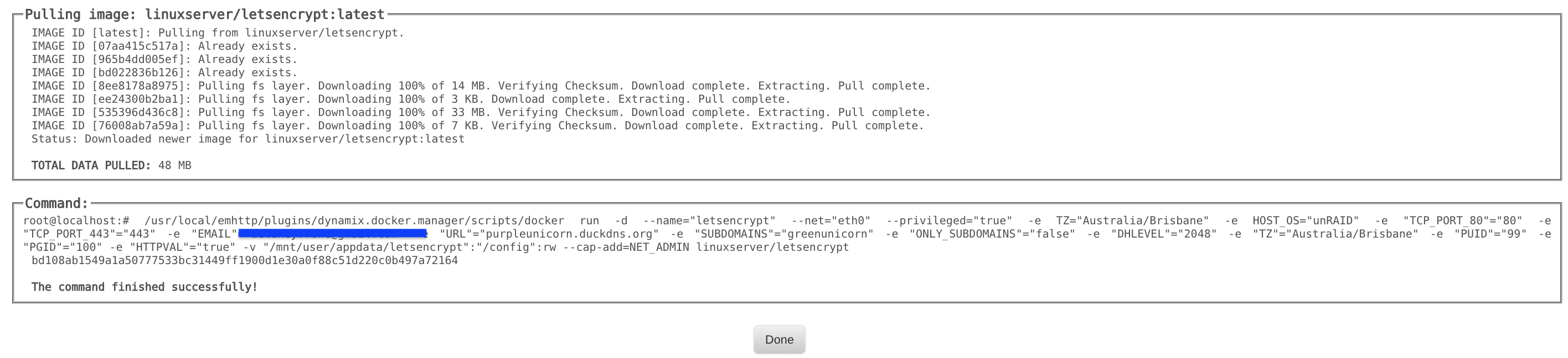

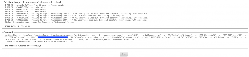

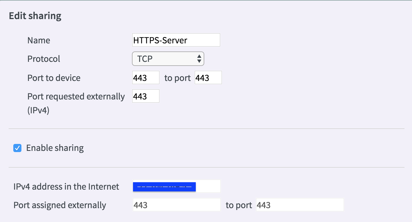

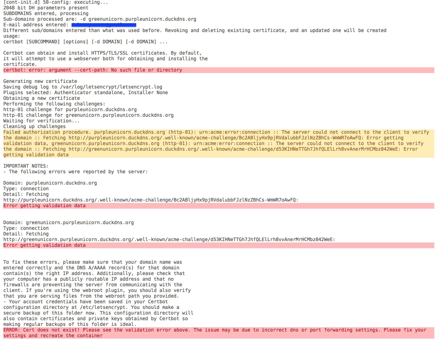

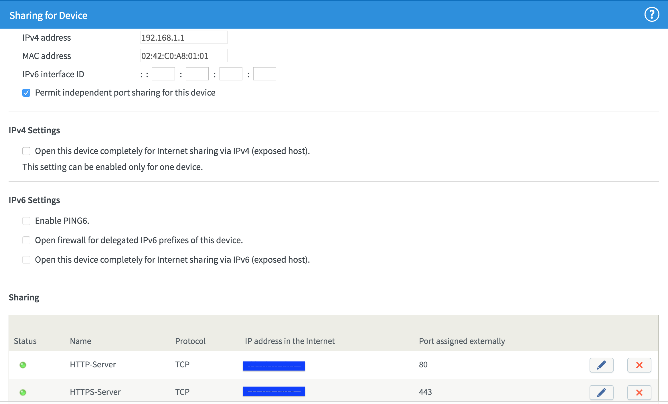

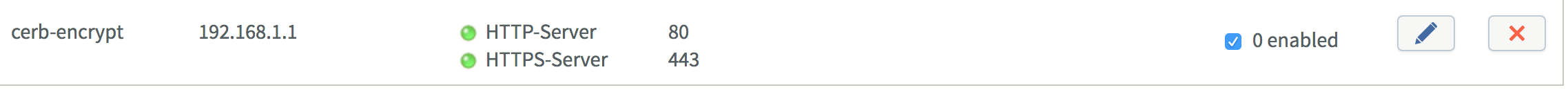

So I’ve tried any number of things and am clearly missing something.
Details of latest specific attempt below at the bottom of my post, would appreciate any insight.
I’ve tried any number of combinations of things:
  • I have confirmed that port 80 is not blocked by temporarily forwarding external port 80 in my router to my Krusader container and have been able access successfully it via my dynamic domain name.
  • I have tried combinations of IPV4, and IPV6, host networking, bridge networking, I am currently using eth0 networking so that my LE container has a dedicated IPV4 address on my local 192.168.1.0/24 network.
  • In bridged mode, I confirmed there were no port conflicts by using 88, and 440 (respectively). I also used 80, and 443 on the host, after having moved the unraid UI to 81, and 444 respectively - a config I’ve used successfully on other hosts.
  • I’ve added —cap-add=NET_ADMIN as per the linxserver page for the LE container

 I've also attached my letsencrypt log file from the LE container - note it still talks about the bind to :80 using IPV4 failing.
