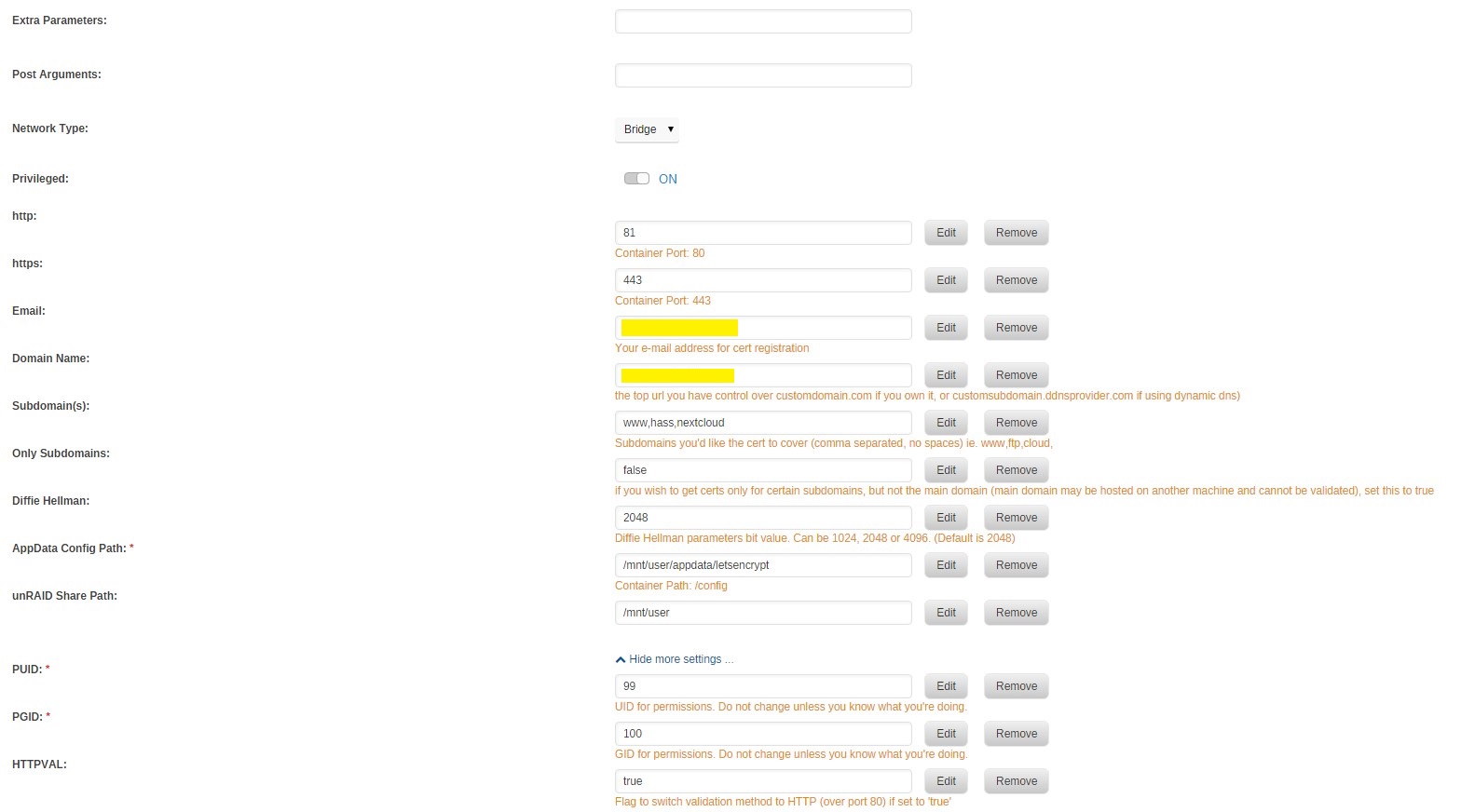

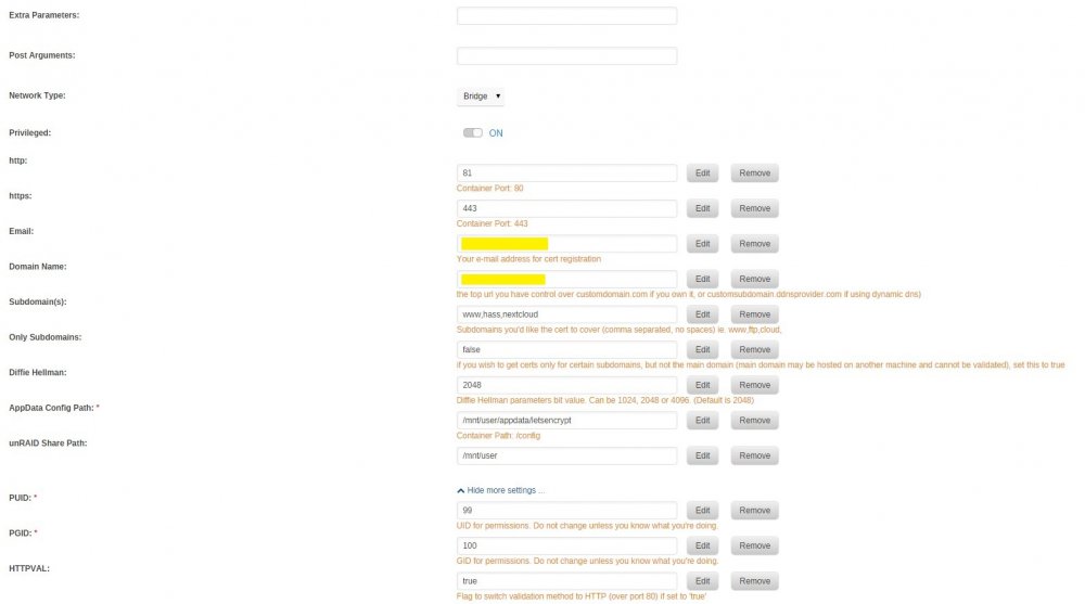

Same issues as the rest.  I've read the 100+ responses on how to fix.  I went to go edit the HTTPVAL option.  Can't find it.  I have advanced settings selected, and I've also clicked on "show more settings" and it's not there.
I removed the docker and image and nothing different.
I must be blind.  Someone take a look at the image and say "it's right there ya fool!".
@Living Legend
After you've uninstalled it you need to delete it from "previous apps" in CA too. Otherwise the old stored template will remain and reinstall when you are installing again. That's my qualified guess. :)

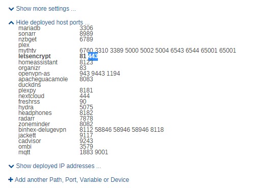

And since the basic error would make me think I used 443 for something else, here is a screenshot of currently deployed ports for the dockers:

6 minutes ago, Living Legend said:
I read through the tips and have hopefully done everything and posted everything necessary.
This all happened immediately upon update to 6.4.
Since then, the docker has been unable to start.

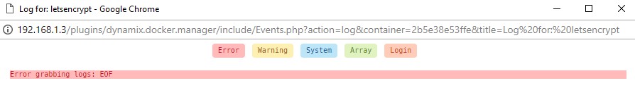

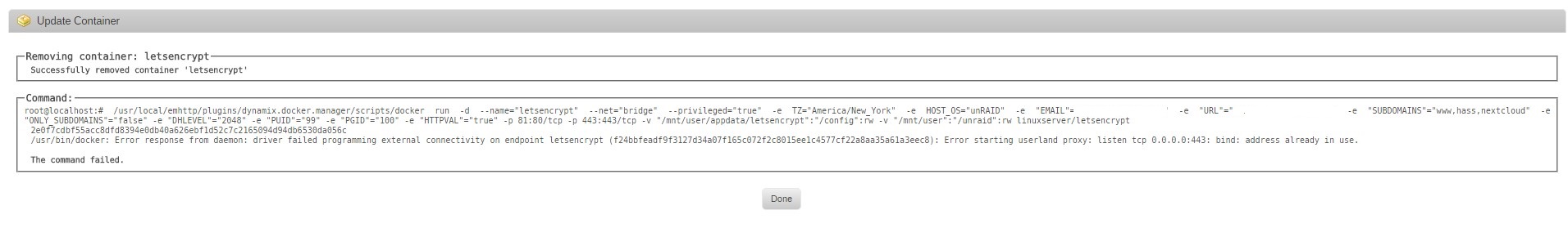

This is my error when I deleted the docker and restarted it:

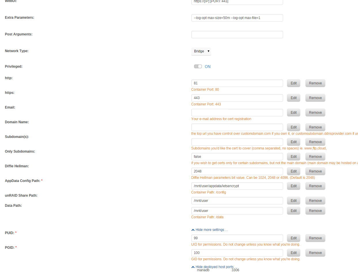

This is my template:
The log file only shows this (unsure which one to pull off appdata folder):

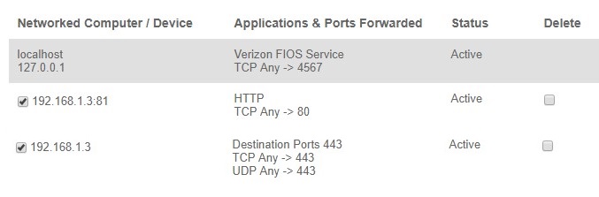

Here are the router settings:

Figured out that my redirect of the unRAID HTTPS port to 445 created some unknown conflict.  442 worked.
