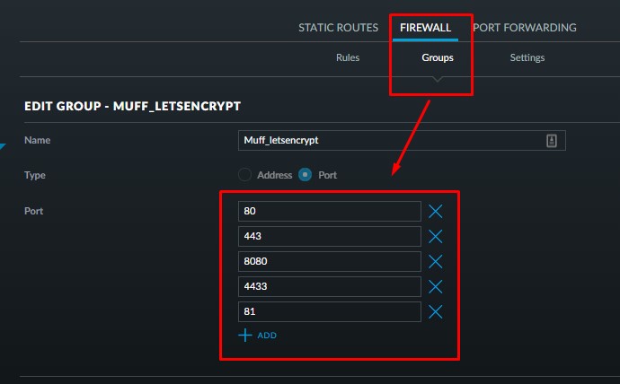

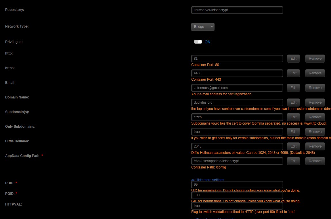

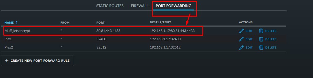

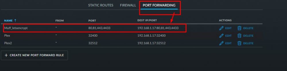

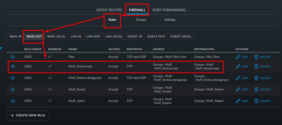

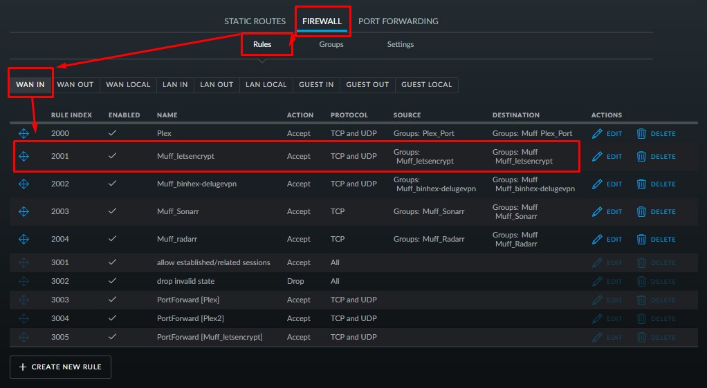

And the pictures and from my Firewall (UniFi Security Gateway 3P) and the docker config

@Muff  Looks like you're forwarding 80 and 81 externally to 80 & 81 internally.  You need to forward 80 externally to 81 internally.
Ah, I didn't know what I was thinking when I grouped all my ports on both Source and Destination so I split them up now and it's working.
Thank you!
