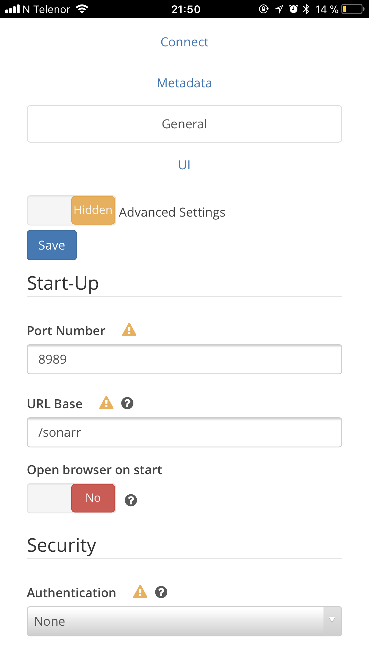

Dear friends, I tried to setup this container for a couple of days and arrived at a stupid position.
Using https://hme.domain.com,  I can connect to my server and see the "Welcome to our server" banner. So, nginx, certs, port forwarding, subdomain setup are all OK.
If I use https://hme.domain.com/sonarr, then I just get "Sonarr Ver." in the top left corner and nothing else. Similarly, https://hme.domain.com/radarr prints "Radarr Ver." in the top left corner. Obviously, these are from the very bottom of sonarr and radarr pages. I think this shows that connection from the internet is OK. But, why can't I see the whole page of sonarr and radarr instead of just two words from the very bottom of these pages.
The only additions to the /mnt/user/appdata/letsencrypt/nginx/site-confs/default are below:
        location  /sonarr {
                include /config/nginx/proxy.conf;
                proxy_pass http://192.168.1.100:8989/sonarr;
        location  /radarr {
                proxy_pass http://192.168.1.100:7878/radarr;
Does this problem ring any bell for anybody?
Thank you for your support.

Did you set base url in the apps? eg. /sonarr
Edited by GilbN
That was it. Strange thing is that the question mark next to URL Base says "For reverse proxy support, default is empty". But, it works anyway with /sonarr.
Thank you.
Thank you.
Why is that strange?
My interpretation is that "leave it blank if reverse proxy is used". But, Sonarr didn't work when I left it blank.

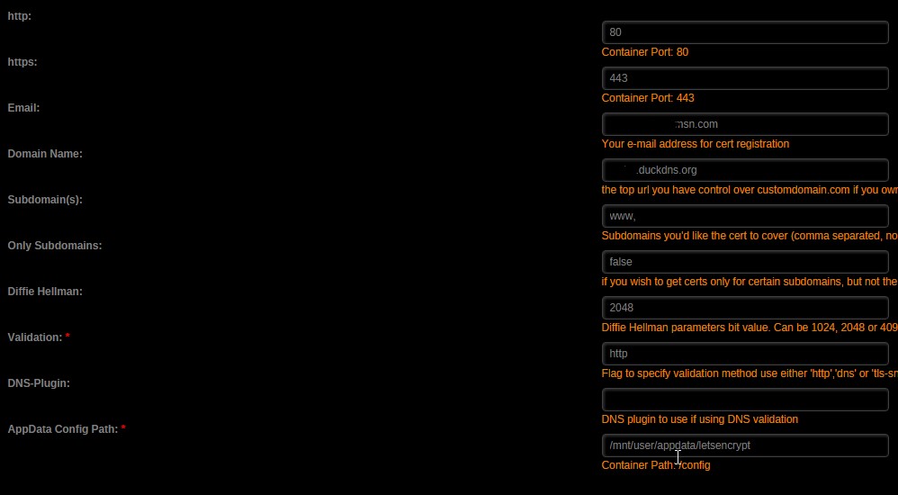

I'm trying to get this working for the first time. I have installed the docker as directed but keep getting this error repeating
nginx: [emerg] BIO_new_file("/config/keys/fullchain.pem") failed (SSL: error:02FFF002:system library:func(4095):No such file or directory:fopen('/config/keys/fullchain.pem', 'r') error:20FFF080:BIO routines:CRYPTO_internal:no such file)
Currently i just want to get the docker working before i actually begin reverse proxy access to other containers etc.
And here is the container params
Try changing /mnt/user to /mnt/cache or /mnt/diskX
Tried unfortunately gives the exact same results.
ok i figured this out... stupid me i tried to get this working in the past and was using a different default config.... i found it and fixed it... so at least i have a base working.
