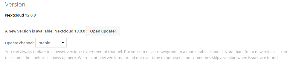

I just updated my container, but when I logged in as an admin and it is still showing the version is 12.0.3
Link to comment
As per the first post in the Nextcloud thread you need to update manually. My recommendation would be via the command line
Link to comment
Is this the CLI upgrade you mentioned?
Also, there is an update button in the UI admin settings, can I use that as well?
Log in as admin
Goto settings and Basic settings (I think)
and there is a update button.
Works most of the time.
It is fixable if it fails.
Hint it may time out during step 4 and 5.  Don't leave the page when this happens.
It just means that the program hasn't finished downloading.
Wait 15 mins and press the retry button
If it fails again, wait a little longer.
If it still fails, go to your config.php file and set update to false and you can start again.
Another scenario I have encountered is that it downloads the file but doesn't go to the next step.
That's an easy fix as well, but see how you go here first.

1 hour ago, Jessie said:
Log in as admin
Or just use the command line.  It just works, every single time.
