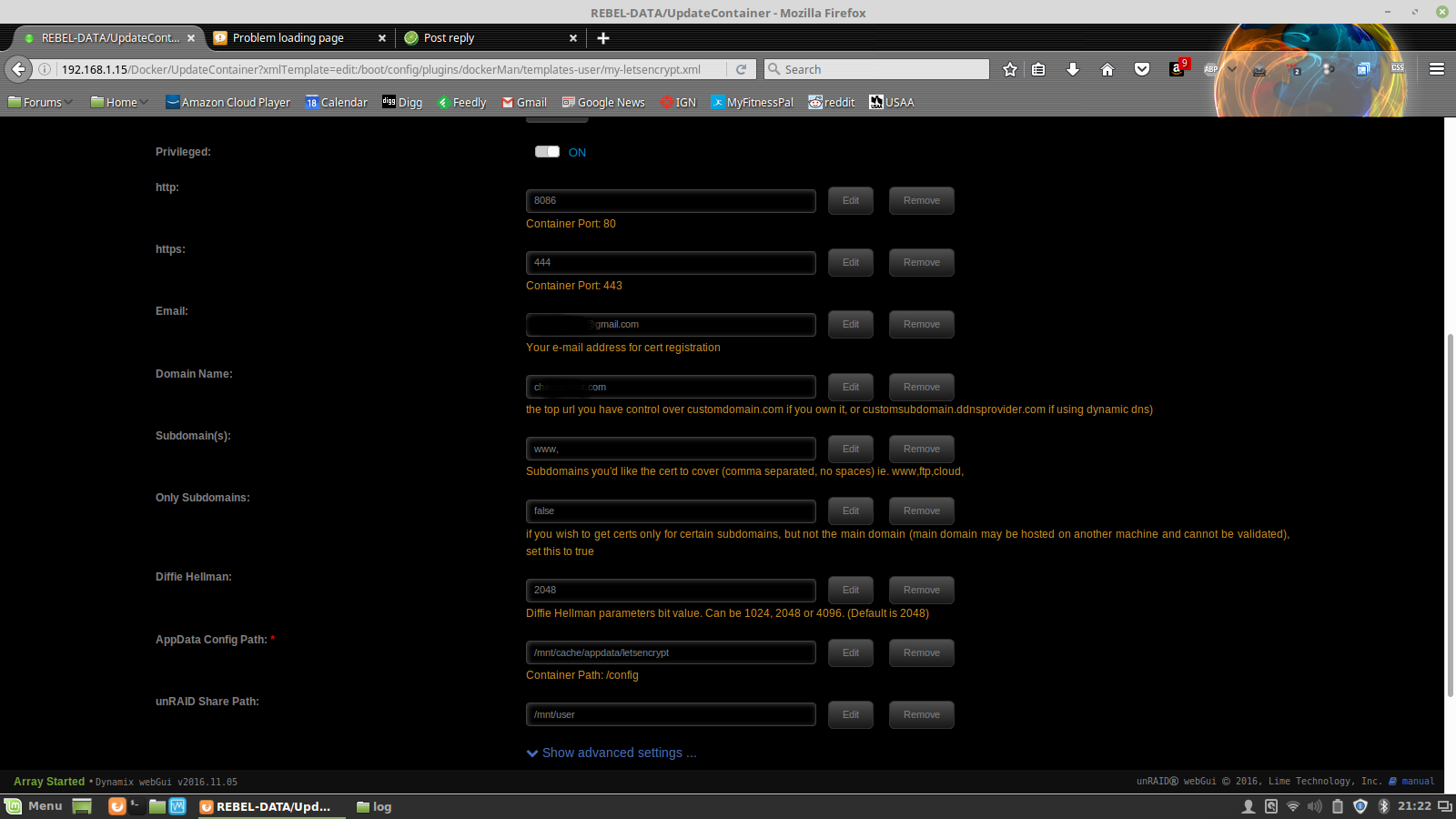

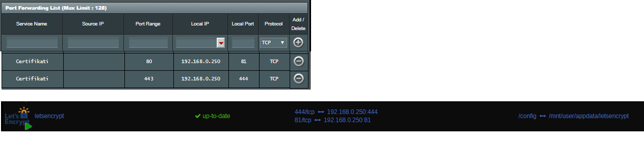

March 7, 20188 yr On 19/11/2016 at 3:26 AM, ChaOConnor said: I'm trying to troubleshoot this. I've installed the docker and used ports 8086 and 444. When I go to https://unraidIP:444 or http://unraidIP:8086, I get "Unable to Connect". After a couple of minutes, the docker shuts down. I went to my "appdata" and locked in the "Log" folder, but nothing is in any of the three folders. I've deleted the docker and the folder in "appdata" and tried reinstalling. I've tried different ports, same thing. I'm using duckDNS and I've verified the domain I'm using works. I've also verified that port 443 on my firewall points to my Unraid server. What am i missing? Any thoughts? Hey guys. Same problems here. The script just can't connect to my server. Which is not odd since I can't connect to it not even from my local pc. My ports on the router are open to 81 and 444 and docker is set to look at 81 and 444. My logs say: Failed authorization procedure. www.xxx.net (http-01): urn:acme:error:connection :: The server could not connect to the client to verify the domain :: Fetching http://www.xxx.net/.well-known/acme-challenge/qT7E563QM0hW3TPVVk2THilZL7JlbrexLVzrKaMUTkM: Connection refused, xxx.net (http-01): urn:acme:error:connection :: The server could not connect to the client to verify the domain :: Fetching http://xxx.net/.well-known/acme-challenge/kmRr9YCRmX035P6QuVoqYoESOP45fAptrLyBn8m1uWU: Connection refused Browsing to http://192.168.0.250:81 or 444 doesn't do anything and throws out: 192.168.0.250 refused to connect. Search Google for 192 168 250 444 ERR_CONNECTION_REFUSED Edited March 7, 20188 yr by gxs Extra info
March 7, 20188 yr 17 minutes ago, gxs said: My ports on the router are open to 81 and 444 You need to open 80 and forward to 81 and open 443 and forward to 444 EDIT: Just seen your screenshots. Your template is out of date, either look at the github page for the missing parameters, or delete the template and reinstall from CA using a brand new template. You won't lose any data, Edited March 7, 20188 yr by CHBMB
March 7, 20188 yr 3 minutes ago, CHBMB said: You need to open 80 and forward to 81 and open 443 and forward to 444 EDIT: Just seen your screenshots. Your template is out of date, either look at the github page for the missing parameters, or delete the template and reinstall from CA using a brand new template. You won't lose any data, I have installed this docker three times now. Today. How out of date can it be? To clarify... From the CA Apps plugin. Edited March 7, 20188 yr by gxs

March 7, 20188 yr I have also wiped the whole docker, template and all the remains from my server and installed everything from scratch. The odd thing is that I did see some ACME website on port 81 but it defaulted to refused to connect message after another refresh. Now it seems that port 444 works and port 81 doesn't. Which is odd to say the least. Ok I can officially say that port 444 now works and port forwards just fine: Welcome to our server The website is currently being setup under this address. For help and support, please contact: [email protected] Port 81/80 rejects the connection but since I'm only after the certificates there probably isn't any point in me fixing things. Edited March 7, 20188 yr by gxs
