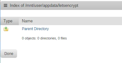

Nope still not working. I removed the container and appdata folder and tried again. I realized I can't even get to the default nginx page (before I change the default file). I just get "Site can't be reached URL took to long to respond". I'm trying to figure out if it's pfsense blocking something or nginx not working properly. I assumed pfsense is good since apache worked without issues.
I do see this in my pfsense logs:
nginx: 2018/03/23 13:22:58 [error] 33793#100135: *847 open() "/usr/local/www/sonarr" failed (2: No such file or directory), client: 1.1.1.1(changed), server: , request: "GET /sonarr HTTP/1.1", host: "website.duckdns.org(changed)"

I installed the letsencrypt docker,  Set it up based on suggestions here, but when it starts I get an "Execution Error".   Go to look at logs and there is nothing there.  Then go to look at the appdata folder and see that it is empty.  Double checked that I set the location right.  So I remove the docker and reinstall, same results - execution error and nothing in the appdata folder.  I tried changing the name, same thing.  What am I missing?   Would a server restart fix this?

Not easy to say when we don't have any info. At least post screenshots of the container template.

Here is the run command:
root@localhost:# /usr/local/emhttp/plugins/dynamix.docker.manager/scripts/docker run -d --name="letsencrypt" --net="bridge" --privileged="true" -e TZ="America/New_York" -e HOST_OS="unRAID" -e "EMAIL"="[email protected]" -e "URL"="mysite.com" -e "SUBDOMAINS"="www" -e "ONLY_SUBDOMAINS"="false" -e "DHLEVEL"="2048" -e "VALIDATION"="http" -e "DNSPLUGIN"="" -e "PUID"="99" -e "PGID"="100" -p 80:80/tcp -p 443:443/tcp -v "/mnt/user/appdata/letsencrypt":"/config":rw linuxserver/letsencrypt
d0a1c030ebb3f2bf21c3446242886f152b846506c8cedd71277d36973476b18e
I don't understand this:

You try to run on the same ports as unraid uses.  You need to change the ports to something unused by unraid or other containers.
You also need to port forward port 80 and 443 in your firewall to the new ports you choose.
