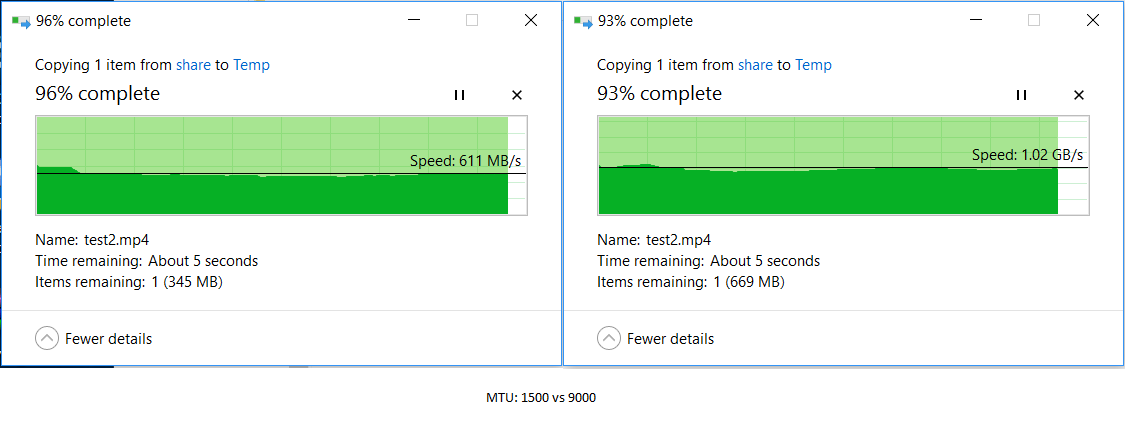

This isn't related to this release but since it's the one I'm using now I wanted to give an update on this with the hope that it may help other 10GbE users.
Since Direct_IO was implemented I could get 1GB/s uploading to unRAID, but "only" 500/600MB/s downloading, well I finally had some time to test and found the reason, I fell a little foolish because it was the low MTU setting, and dispite knowing that jumbo frames were recommended for 10GbE, I never though to try them before since my problem was the download speed only.
Now with SMB 2.0.2, MTU set to 9000 and Direct_IO enable (if copying from a user share) I can get 1GB/s download from unRAID when copying from the NVMe cache device, so I'm a happy camper.

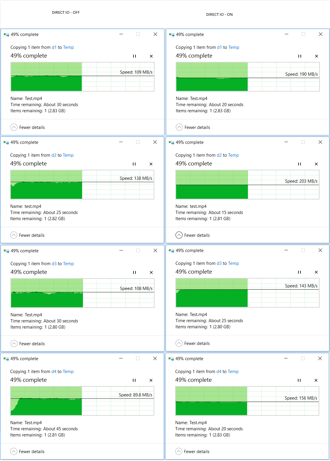

Forgot to add that in some circumstances Direct_IO can provide better performance even for gigabit users (only when copying from a user share), I've found that some disks won't deliver full gigabit speed with Direct_IO disable, some examples below (with SMB set to 2.0.2 due to the current issues with SMB3).
disk1 - Toshiba DT01ACA100 (7200rpm)
disk2 - Seagate ST1000DM003 (7200rpm)
disk3 - Samsung HD204UI (5400rpm)
disk4 - WD Purple WD10PURX (5400rpm)

so, you say, you can overcome 1Gbit almost 1.5x with Direct_IO on? 200MB/s - it's about 1.6Gbit...
That's not possible, I'm using 10GbE, but some disks, especially the WD can't get to gigabit max speed (~114MB/s) without Direct_IO enable (when copying from a user share).

I have enabled it on all my servers, most of them are gigabit but speed difference is very noticeable, especially with WD disks for some reason, I can't find any downside but different hardware my give different results.
So, how does one enable direct_IO?
Settings -> Global Share Settings
Note this only improves performance when using user shares (don't notice impact when using disk shares), write speed improvement should only be noticeable with 10GbE and SSD/NVMe devices, read speed can improve significantly with HDDs (varies with HDD maker/model, at least on my tests).
